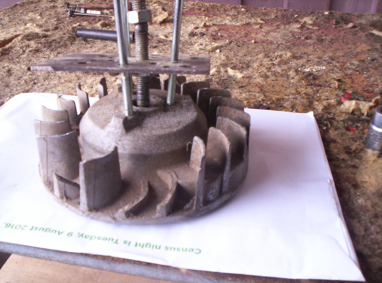

Hi I am new to this forum. Recently i have rebuilt a power torque victa (half crank). I have now got hold of a clapped out full crank victa 2 stroke. I plan on stripping it down and cleaning it up and get it going again for something to do. I've stripped most of it down but i have a number of questions:
How do you remove the fly wheel on the top of the engine?
Does any one have an exploded view of the engine?
Are the crank case seals the same as the more modern half crank seals?
And also, are the parts for half crank engines interchangeable with these older engines?
Is there any instruction on fixing the pull start?

What about removing the fly wheel?? I don't have any victa special tools.
Joined: Jul 2016
Posts: 129
Nolan
to remove flywheelyou don't need special tool
just use two of biggerst flat screwdrivers you have can find
maybe too people make more easy
one person to wedge screwdrivers under flywheel one screwdriver either side flywheel and using both screw drivers applied preasure to push flywheel up
at same time other person to give crank sharp blow with hammer, best maybe use brass drift of copper hammer to hit crank shaft, steel hammer damage crank threadsmake more plobem
for first time remove flywheel find help two person make easy preasure with screwdrivers pushing up hit end crank bang flywheel pop off very easy maybe some time need few good whcks grin

Thanks freebird. I was just having trouble with the nut. Thought there may have been a special way. In the end got my impact wrench onto. Was just jammed up with crap but came off easy after that.
