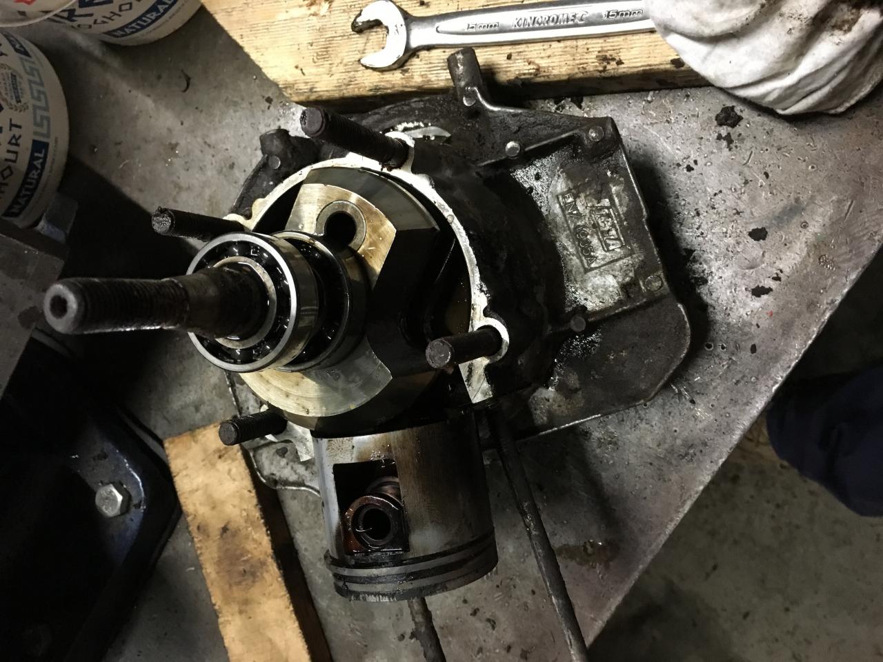

Hi I am new to this forum. Recently i have rebuilt a power torque victa (half crank). I have now got hold of a clapped out full crank victa 2 stroke. I plan on stripping it down and cleaning it up and get it going again for something to do. I've stripped most of it down but i have a number of questions:
How do you remove the fly wheel on the top of the engine?
Does any one have an exploded view of the engine?
Are the crank case seals the same as the more modern half crank seals?
And also, are the parts for half crank engines interchangeable with these older engines?
Is there any instruction on fixing the pull start?
I have pictures which I will load up when I work out how. It has the G4 carby which I understand pretty well now. It's missing the end cap on the throttle so I can't give you a model number unfortunately.

this the only pic I have of it before I took to it with the ratchet.
G'day nolan1986, and welcome to the ODK forums.
There's a how-to on uploading pics HERE
Your machine is a late model full crank 160cc, with side-mounted gear starter.
There are some free downloads of repair manual excerpts HERE; in the upper numbered sections. The rest require a paid subscription, but all you need is in the free section.
The 'Victa Gear Starter' and 'Victa Early Model 125cc & 160cc Spec\'s' docos should get you started. There are exploded diagrams in those.
Once the nut is undone, the flywheel should just slide off. If necessary, a little gentle persuasion, with two screwdrivers under opposite sides, can be used.
The seals and gaskets are different to the PowerTorque half crank engine, but the Powertorque piston fits the 160cc full crank engine. The seals/gaskets are quite cheap; see HERE for gaskets; HERE for seals.
