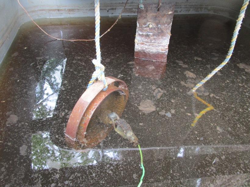

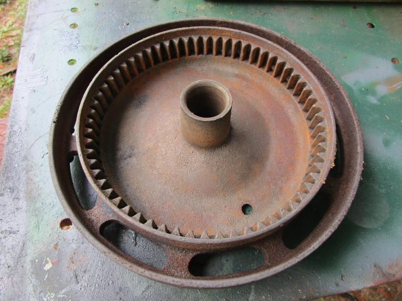

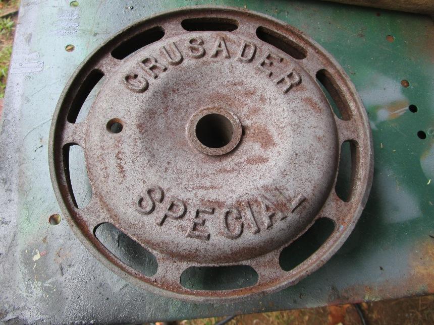

Picture 1 & 2 A mower wheel as removed

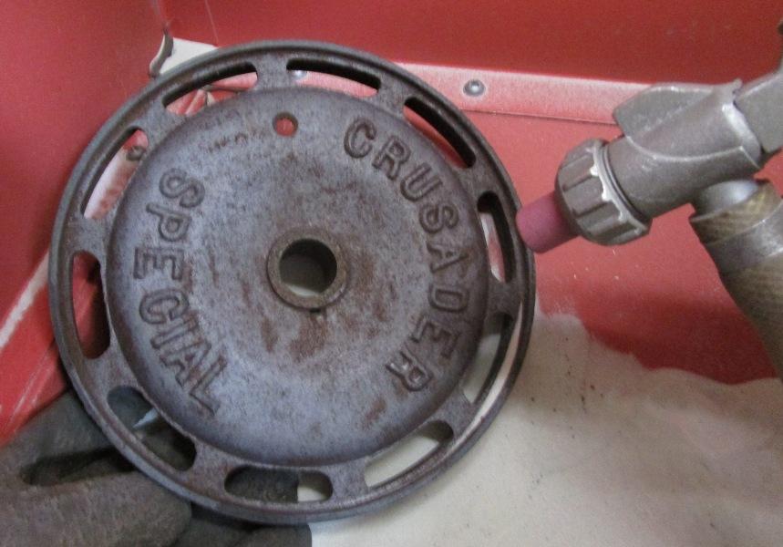

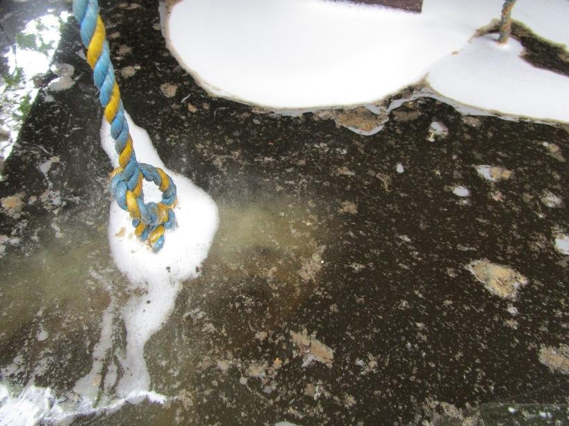

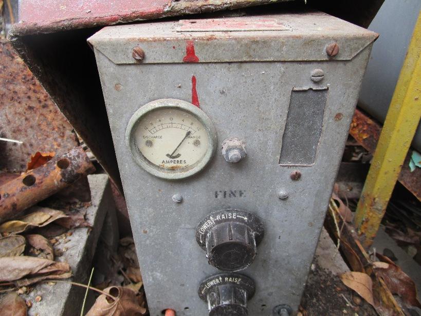

Picture 3, 4 5. In electrolyses bath running just over 8 amps
And video of action

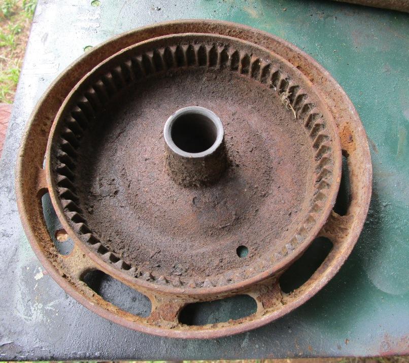

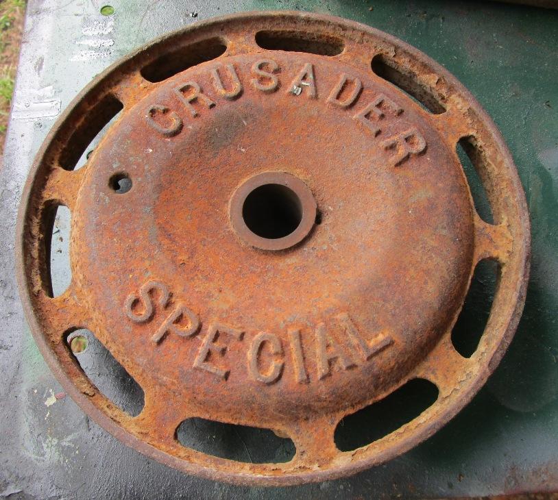

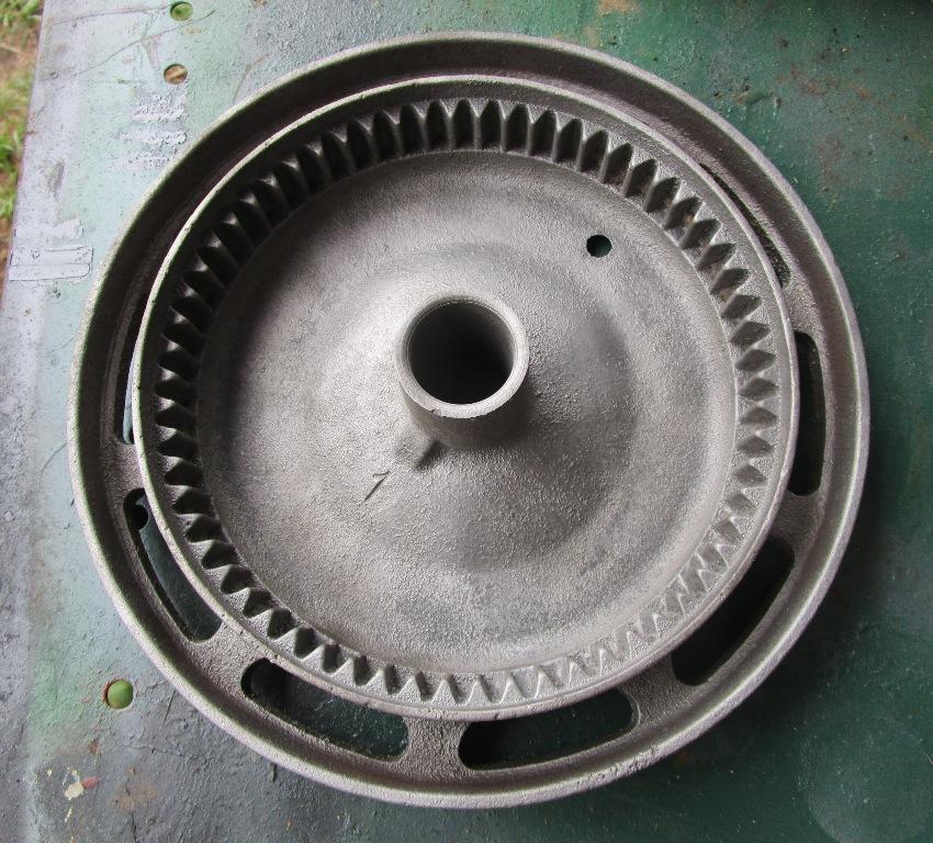

Picture 6 After about 6hrs removed and water jet blasted
Picture 7,8 Result of being jet blasted, the darker is more of a stain not rust

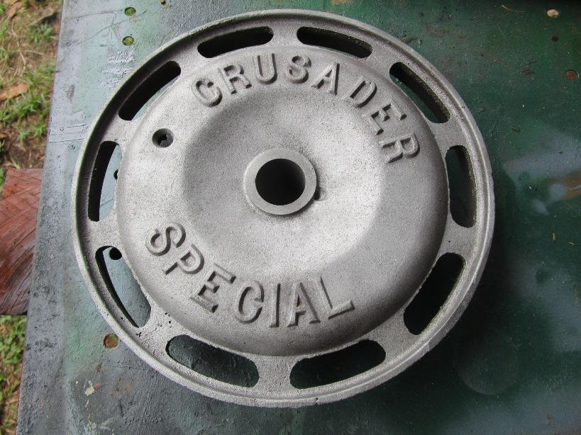

Picture 9 Glass bead blasted with a fine bead unlike sand blasting this does no pit the surface just cleans it
Picture 9, 10 result of glass bead blasting a nice clean surface not a pitted surface like sand blasting would do

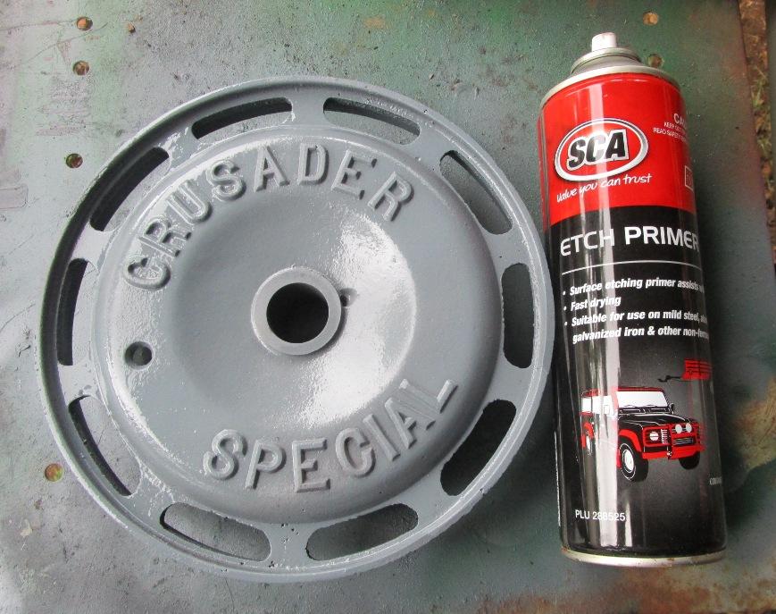

Picture 11 Painted with Etch Primer bought from Super Auto when on special

Just remember if you leave that alligator clip connection submersed it will dissolve too. Did you get much pitting from the bath? I have read that much above 2 amps and it will work faster but can cause deep pitting.
This
Joined: Dec 2013
Posts: 373
Likes: 5
Southern Cross Registrar
""Just like new.
Just remember if you leave that alligator clip connection submersed it will dissolve too. Did you get much pitting from the bath? I have read that much above 2 amps and it will work faster but can cause deep pitting.":"
I have being do this for about 25 years with the same alligator clips and at 8mps
PITTING ??? it does not eat the metal you wont get pitting
All it does is form Hydrogen bubbles on the GOOD steel and everything outside that is pushed of by the bubbles
I would like to know where you read this:-
Where you will get pitting if have the current going the wrong way
The + must got to the Anode the - must got to the job
