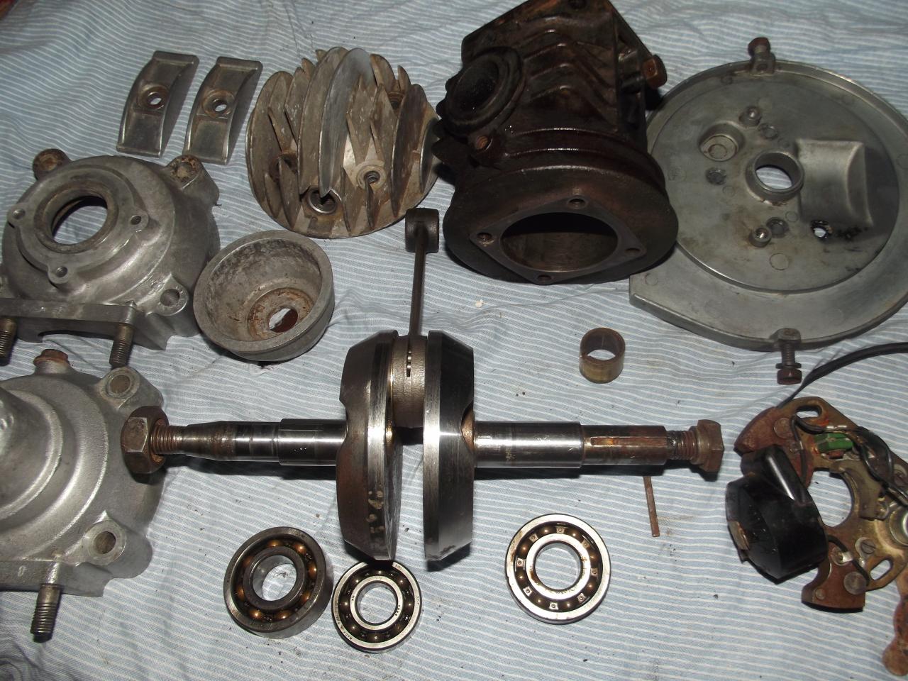

Hello all. I was wondering how I would go about removing the top 20mm bearing. special tool maybe
[Linked Image].
i presume your everyday 3 pronged puller will get the bottom bearings off.
thanks

Assuming you are replacing the bearing anyway cut it off with a 1mm cutting disc on an angle grinder if no other way is available. Cut parallel to the crankshaft from the key end.

There is a tool for removing bearings up against the flywheels but they cost a few dollars and probably a bit expensive for a one off, otherwise you have to get it off the best way you can

Yep, the bearing separator type puller is the type that Victa used to supply as a factory service tool.
See this excerpt of a Victa Workshop Manual, 8th page; https://www.outdoorking-forum.com.au/pages/V...icta%20Workshop%20%20Engine%20Manual.pdf
Note also that the manual says:
If this tool is not available the bearings may be prised off with two screwdrivers.
That usually works, except for the occasional very tight bearing.

Thanks fellas.
Gadge. although i would like to own that cool tool i opted for the screwdrivers.

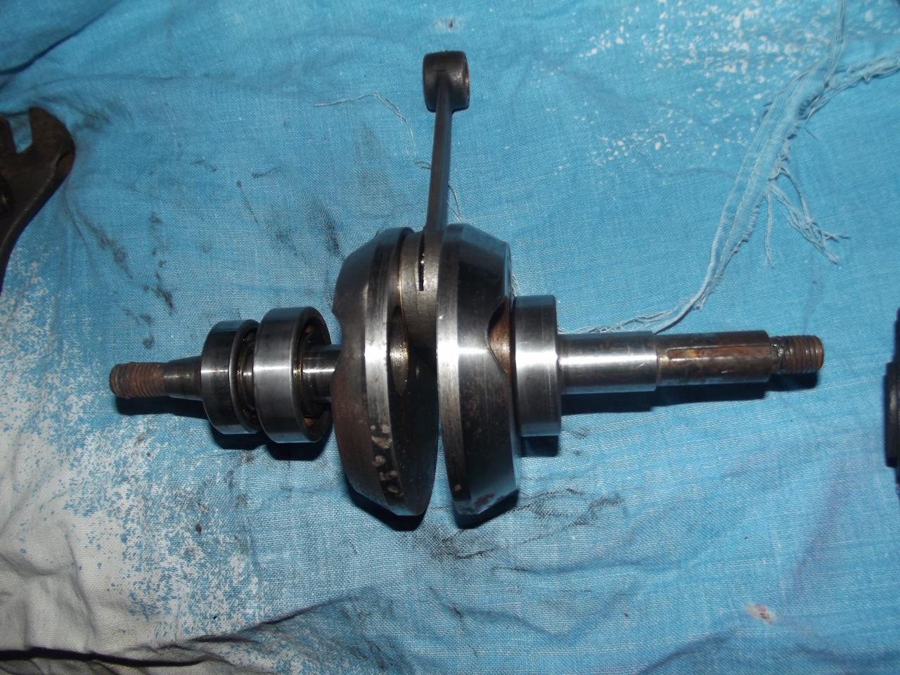

took a bit of gentle persuasion to remove the bearings but in the end they came off with no big deal.
awaiting parts.
this is where i am at
AVB. [Linked Image]
now i have to think about painting the base. hammered avo for the base and brunswick green for handles i believe is correct.
