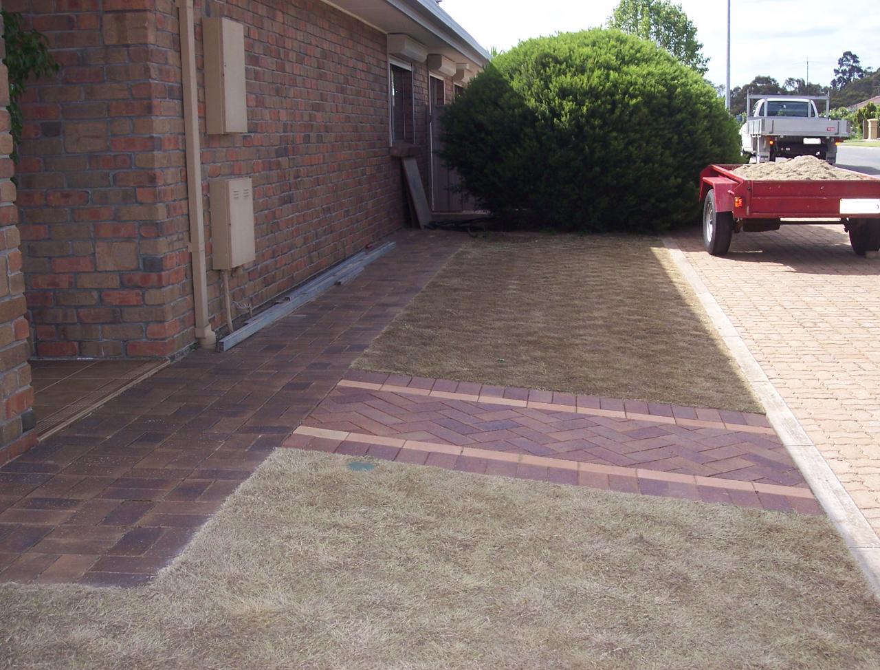

Since the ODK Admins have given us a place to discuss lawn care and maintenance I thought that we needed some content. Since winter is approaching I thought I would put some projects up that I have done that might help some members get themselves ready and inspired come spring.
Probably the most important aspect of getting the most out of your reel mower is having a level smooth lawn without major undulations to eliminate scalping high spots and gouging in low spots.
I have undertaken some leveling on a few different occasions and have come up with what I think is the best method.
Early spring I always shave my couch down as low as I can, firstly with the rotary mower then finishing with the reel mower and remove all the clippings and stemmy trash. The lower the better. A standard bedknife on a SB45 should get you down to about 7mm which is fine. You can further dethach with a dedicated machine or core aerate if there is excessive organic thatch matter evident. Once you have it scalped it down low the undulations become so much more visible and will enable you to fill with material.
I always use sand to level out. In this case a coarse grit sand like a paving or concrete sand. This type of sand is better than a uniform particle size sand (eg play sand) as it tends to lock together and provide a solid firm surface. Around 1 tonne per 100m2 is a good place to start. Use the back side of a rake to roughly distribute the sand then use a topsoil level to finish off by working back and forth. You can make a drag mat out of a flat piece of wood and some mesh to make it super smooth by working back and forth and around and round. Deep depressions may take 2 or 3 applications of sand to level completely and doing smaller applications is better than totally burying the grass under 10mm+ of sand.
Next up add 0.5kg of Nitrogen per 100m2 from a high quality slow release fertiliser. For example, a 25-1-5 analysis you would drop 2kg of actual product per 100m2. (2kg x 0.25N = 0.5kg N)
Give it a really deep watering as soon as you are finished and continue with 3 medium waterings per week until it is fully recovered. Once the lawn is filled back in switch back to a weekly deep watering. Sit back and watch your lawn come in looking silky smooth!
Mowing can recommence again once it has reached your desired mowing height. Don't let it get too long as you want to induce the plant to grow low and dense, not tall and leggy.

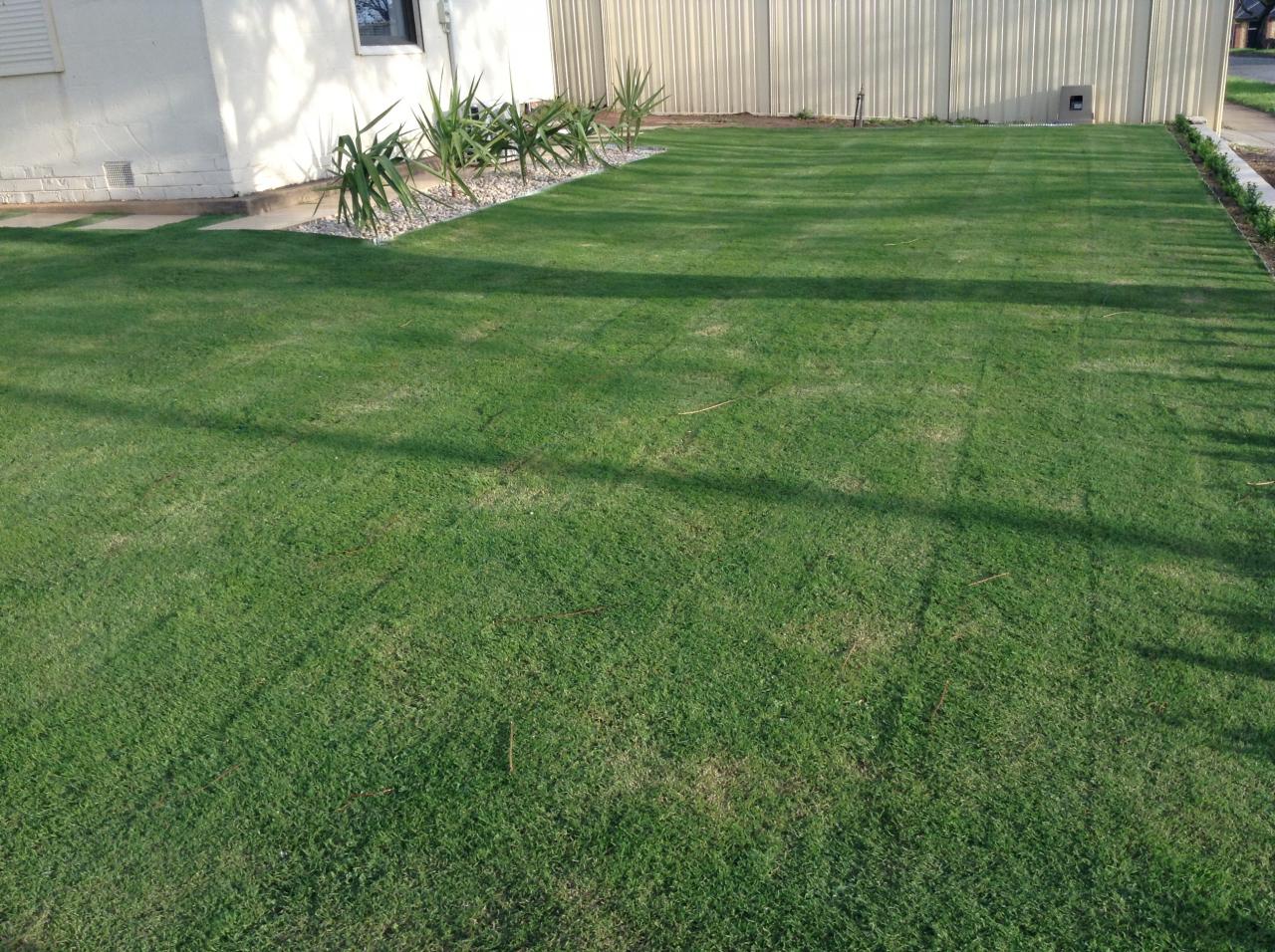

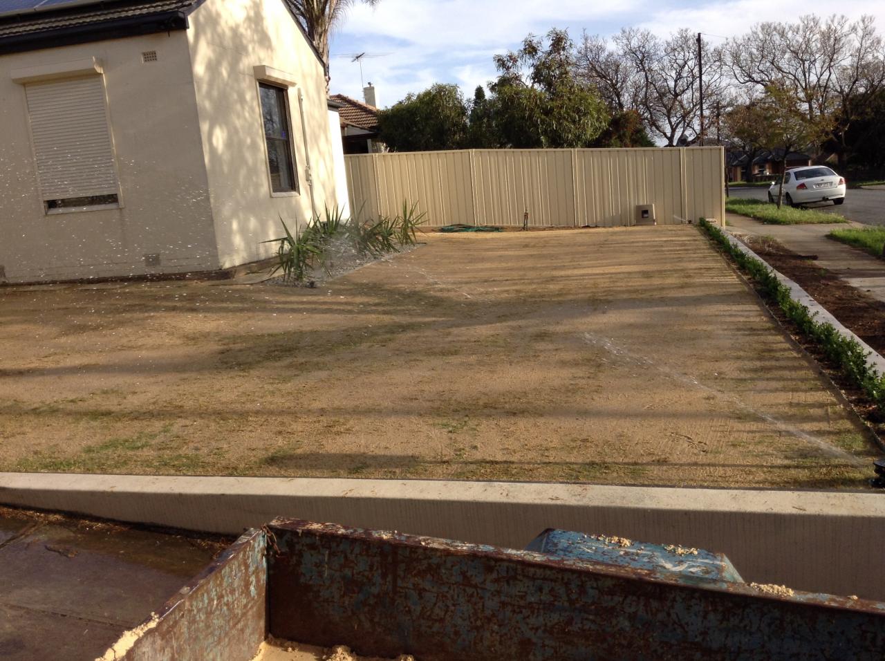

I scalped, scarified, aerated and sanded the back lawn about a month ago.
Just starting to come in now with some better weather.
Joined: Apr 2013
Posts: 118
Likes: 5
Lawn Freak
Still some work to do out here including some weeding of the garden beds.
Will get some sand down over the weekend.

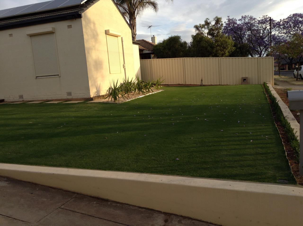

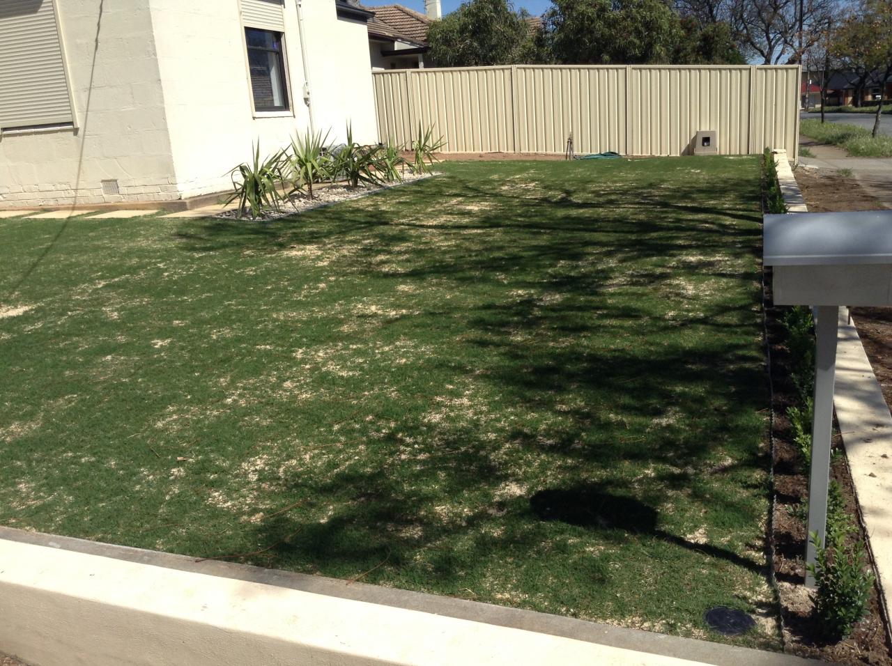

I had a look back at some photos I took around the same time last year and this season is about 2 weeks behind. When you scalp it the soil is able to absorb a lot more heat from the sun as there is no grass blades in the way to insulate the soil. Anytime from now is fine to scalp it and get some sand down. I usually find it takes about 2 weeks just to re-shoot and from there you can see it filling in everyday. Just remember couch is extremely hardy and will tolerate a lot of abuse and in most cases come back better than before.
Kamba M won't do anything to crab grass. That is a broadleaf weed killer (and not a great one IMO). Hand weeding with a pocket knife is probably easiest if populations are small. Pre-emergent is the way to go to control those grassy and broadleaf weeds before they even become noticeable. I have 2L of the stuff and am happy to give you some if you want to try it out.
BB, that is looking so good. A light sanding and that will be schmick! I filled my 2 green bins plus 2 of my neighbours bins with clippings from the front lawn alone last week. It is amazing how much material is there.
Anyway, update from tonight. I mowed yesterday with the Toro @3.2mm and mowed again tonight to see how much came off. Considering it was fairly mild today it is growing at a decent rate.
This last photo was 14/10/15, and that was the warmest October on record. So in all it isn't that far behind and this has been the coldest October I can remember.

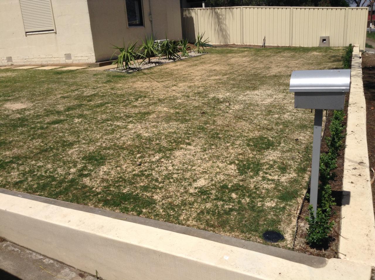

Hi Guys,
I must admit I'm still finding that my lawn hasn't come into season as yet. I've scalped it nearly a week ago and still absolutely no signs of life. I did my side lawn a week earlier and still zippo.
I think that as I'm in the foothills that my ground temperature is lower than what it is down Simon's way.
BB. (still waiting)
Posts: 88
Yea mine isn't great at the moment either. I still had it at the winter length until Friday when I scalped it and it's looking awful. I know it's only been a few days but even after the previous mows at winter height it just takes ages to bounce back.
