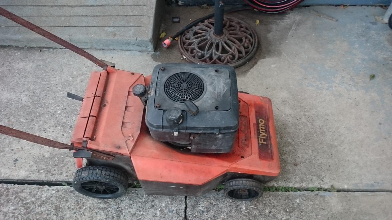

It's a Flymo.
... But with less flying capability.
The angular styling and first model Quantum suggest mid-late 1980s...
an interpretation of James Bond's Lotus Esprit I guess.
Not an overly handsome machine.
[I love the ornate stand behind it though]
p.s. it's quite a good image there.
The boring angular concrete and mower contrasted against
the circular, radiating flywheel cover and ornate stand.

That one has a Series 1 Briggs Quantum engine [roughly 1987-9], going by the central mount oil dipstick. 175cc, 3.5hp.
We can narrow the engine manufacture date down, if you can post the Model/Type/Code numbers stamped on the cowling above the spark plug.
