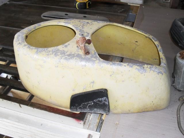

I have a question - the two small holes above the port serve
what purpose? I note that Pope's Pope also has them.

Funny how things turn out. Jack, I do not like the way the handle bars float. I see on the next model they solve it by putting a set of really ugly bolts there for adjustment.
The two holes are countersunk leading me to think that something was on the inside not the outside ?
Posts: 988
Likes: 7
Gizmo may hold the answer to the two holes, looking at his cowl there seems to be a cover over the access port ?
Interesting, also an instruction decal on the back of the cowl. I don't think there would be a Pope decal there as in Popes restoration as there is such a prominent Pope logo on the front of the machine. I would like to see some better pics of Gizmo's cowl if he reads this.

I guess that's likely it; given that the alloy cowl is both
decorative and functional. Perhaps a cover was needed to
stop escape of fan air before it did its cooling job?

this is a rubber insert .i guess the 2 holes are what keep it in place.
