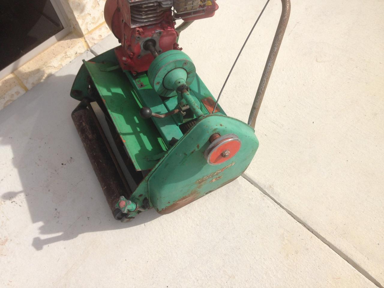

Hi,
I just got this 45 cheap as it doesn't run but looked ok. After reading other posts on this forum I have decided to take it apart, have it sharpened, give it new paint and reassemble replacing any worn parts. I have got a new Briggs and Stratton 3.5 to go on. Just wanted to ask if anybody can see any other problems I might have from the photos. I will get more photos of the chain and sprockets once I take it apart. (Will the pulley for the edger come of with a 3 jaw puller?) Also wondering if anybody can identify how old it is given its had a quick repaint at some stage and I think that is also a replacement engine at some stage. Cheers
Likes: 303
Hello Elton
I'm sure Mod BB and members will contribute shortly.
No, the engine is a replacement from the 1980s.
To answer one question now.
The pulley will be screwed on. See:-
https://www.outdoorking-forum.com.au/forum/ubbthreads.php?ubb=showflat&Number=58163
[I suggest you do not re-fit the pulley. Return to standard spec.]

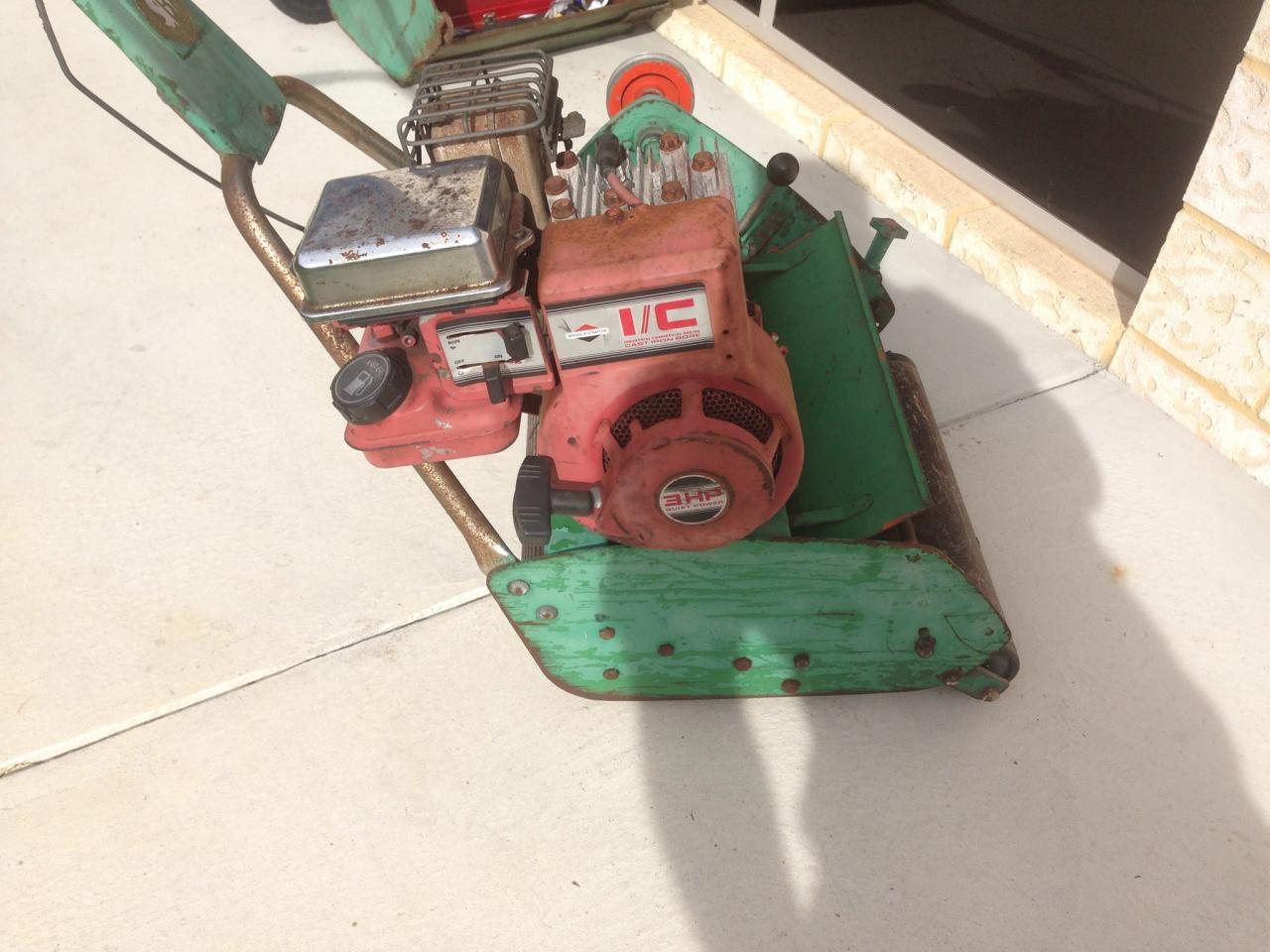

Hi Elton and Mod CJ,
Well this one most certainly isn't the worst machine I've seen, rather it's quite good in fact.
We can not date your machine as as it was originally fitted with a Kirby power plant and never a Briggs & Stratton. Sadly none of the numbers on your unit correlate back to a build date, but from my own knowledge yours would be a late 1972 machine.
Now your next issue you're going to have is fitting another engine onto it as it has the series 1 handle bars on it and as such the later Briggs engines will not fit as they will clash with the right hand side of the handle bars. Your machine is in fact an early Series 2 that was originally fitted with the Kirby HK25 Engine that had the forward facing petrol tank. When SB swapped over to the Briggs line up of engines in 1976 they modified the handle bars so that the 3 HP engine with the large rear mounted fuel tank could be fitted.
You might have to get a set of handle bar adapters so as to fit a later model Briggs. There are many other engines that you could fit that wouldn't clash with your original handle bars. eg. varies model Honda's etc.
Your rails under the engine look rather good with from what I can see as there is no evidence of rail fatigue and cracking, something the Series 2 machines nearly all suffered from.
The reel is still serviceable but as I can't see the bed knife I can't comment on that. If you tip the mower backwards and take a shot of the reel and bed knife contact area I can then pass on better judgement.
I note that the original throttle cable and control is missing due to the engine replacement and as such with this current engine you have to adjust the speed directly on the engine which can be a real pain when you need more grunt in a hurry, especially in a hilly garden.
All in all it looks to be a rather good machine that could easily be renovated into a superb mower.
PS As CyberJack suggested, I to would remove the edger pulley and throw it aside as they are one of the most lethal things that was ever fitted to a Scotty. Definitely wouldn't pass today's OH&S regulations that's for sure.

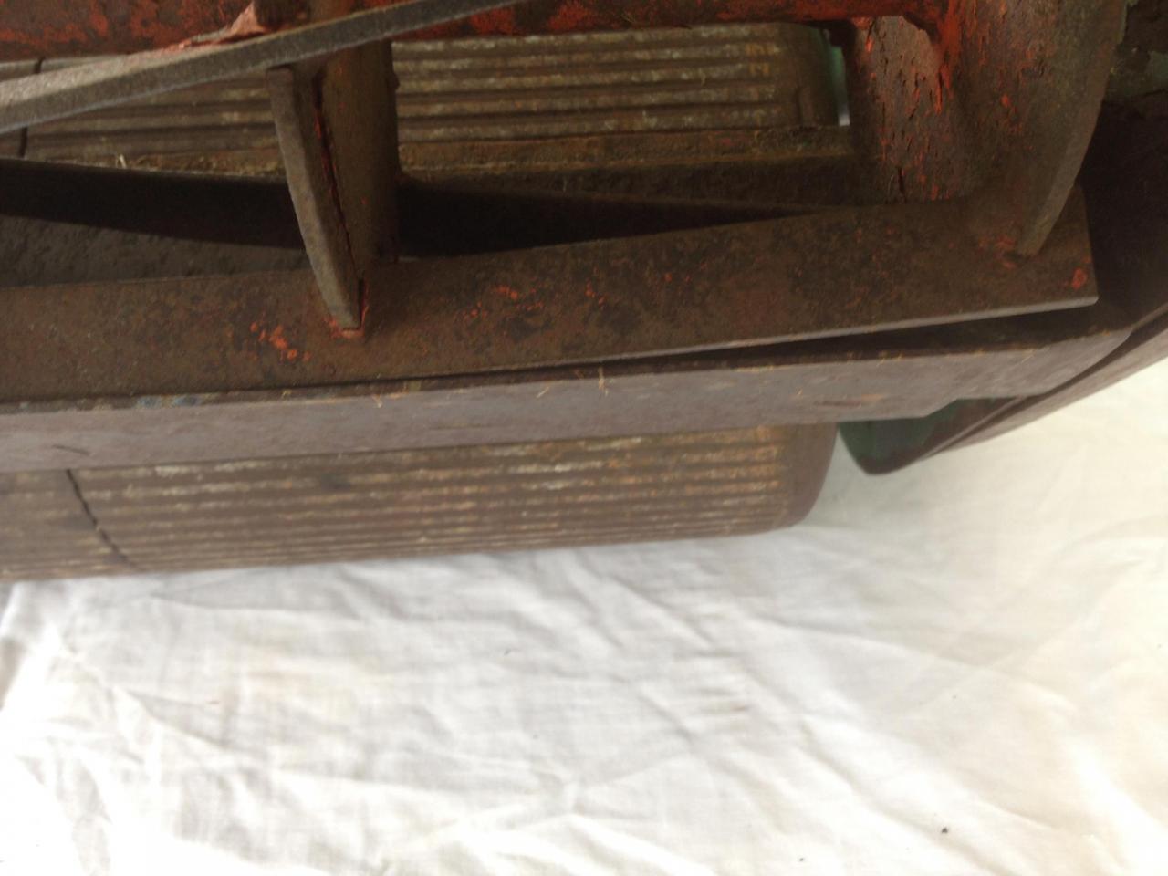

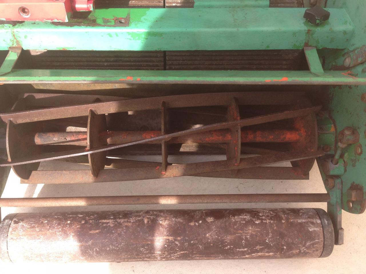

I have found a lot of information on other restorations I have read on the forum so I shouldn't have too many questions, but will keep putting up photos of my progress. I have taken some more photos of the blade area and chains. A lot of the bearings seem to have a bit of play so while it is apart I will replace all the bearings. The frame around the engine looks really good with no cracks. Happy to read the reel is still serviceable as this was the only part that concerned me a little bit. Yes, I wont put the edger back on (It did come complete with the mower. The pulley doesn't seem to want to unscrew from the clutch shaft, but I will see what I can do. Apart from that, [Linked Image]
the machine had a lot of oil and grease over it so it has been easy to take apart so far.
Hi Elton....... John ??????
That's got a great Bed knife, so that's a huge cost saving. See if there is any free play in the bearings of the reel by grabbing it (of course not while running)and moving it vertically back and forth. If nothing then I would adjust the reel to the contact method and see how things go. No need to spend money that's not needed to be spent.

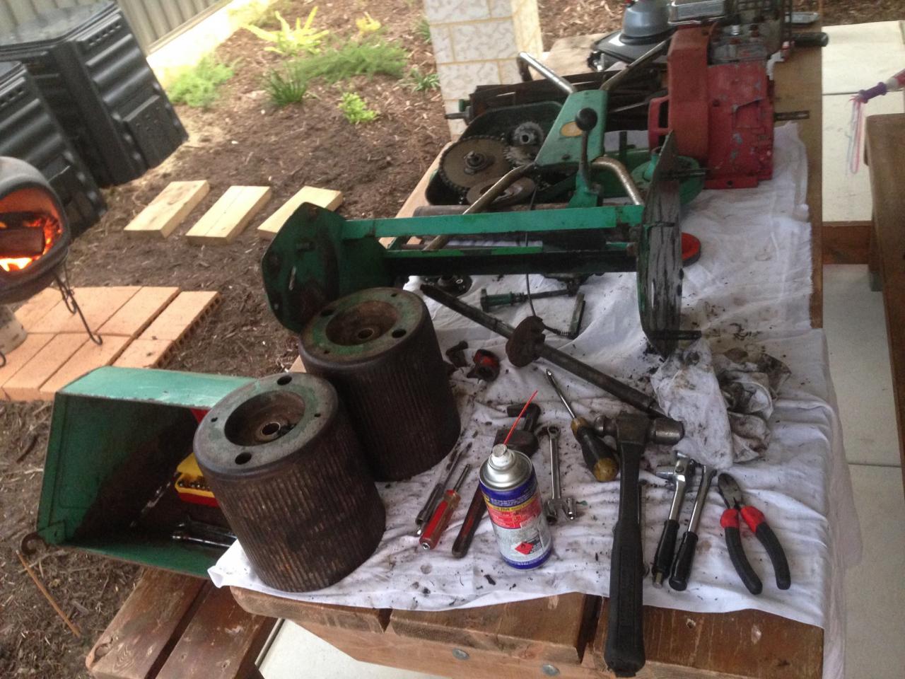

Hi BB,

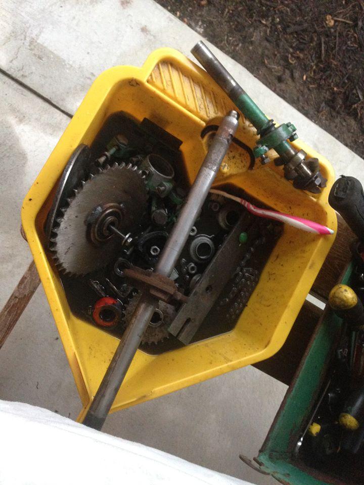

Yes I was born in that era so I am pretty that is where my name came from. Well I did the reassemble yesterday afternoon. Everything looks pretty good from all the grease and oil over it I think whe I first picked it up. The reel bearings had a bit of up and down movement and the rear roller bearings are really bad. Also the bearing for the clutch shaft in the little housing pretty much fell apart, so I am looking at all new bearings. Everything else should clean up nicely. I am going to replace both bits of cork while its apart. Can I ask what is best to glue them on with? So now just the big clean up, paint and reassemble over the coming weeks [Linked Image]
Joined: Apr 2016
Posts: 11
I just noticed I typed reassemble instead of disassemble. Ha Ha
Hi Reginal Dwight,
I thought that you had it back together way to fast LOL !

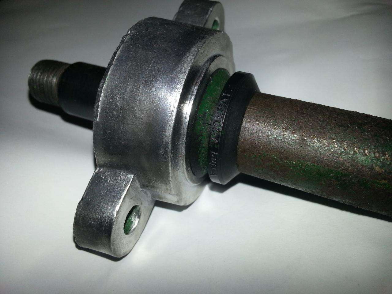

Replacing bearings isn't that cheap but wait until you get a price for the self aligning bearing from the end of the transfer shaft inside that housing. I hope you are sitting comfortably. This bearing is not your standard type of bearing as it allows the transfer shaft to be able to oscillate slightly due to engine / chassis vibration and also clutch movement.
In actual fact those bearings are quite prone to, and are nearly designed to fall apart if not handled very carefully during disassembly, but they can be put back together again and reused. The rest of the normal bearings on the reel and rollers are just standard chuck outs. You'll probably find that the reel bearings are the original open type units and not the sealed type. Replace them all with nylon sealed units. Bearing Number RSL5 for the reel which you should pay no more than $8.00 each for. Don't get sucked in for some that are being flogged on the internet for around $28 a pair.
Just looking at your photo's of the drive train, there certainly is some moderate wear on all the sprockets but depending on your cost restraints they will survive for a while yet. What I'm saying is I've seen much worse and they were still going. When it gets into sprocket replacement it requires deep pockets as the chains must also be replaced at the same time. Ouch ! Have you priced a cutter sprocket lately ? generally over $100.
Have you decided what to do regarding the engine ?
As far as re-gluing the cork, use contact adhesive.
PS. Love the foundry you're running in the background there, is it that cold already where you are ?

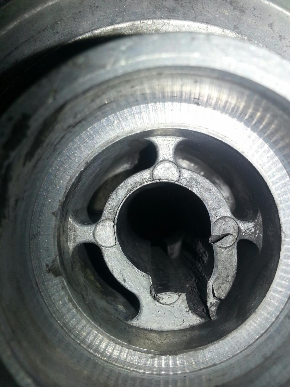

When it comes time to clean the clutch, pull it apart and check to make sure the keyways are not damaged. You can look at the key that sits in the PTO shaft to give you an idea of what condition the clutch will be in.
The SB45 seems to chew through the engine side clutch half consistently. This is probably a combination of a design fault, use of a cotter pin and the way the clutch engages. The clutch has two speeds, stop and go. And a lot of sideway force is applied to the key when the clutch is suddenly engaged. I am not sure if moving the lever very slowly would stop it from jolting like this. Perhaps the cork might wear our faster.
A centifugal clutch in its place would go a long way in protecting the PTO shaft, clutch drive shaft and bearings from damage. It would also allow for progessive engagement of the drive shaft without any sudden jolt. Clutch shoes also slip a bit, allowing engine RPMs to increase before the clutch applies all the torque.
Here are some photos of the clutch issues I have with my 17" and 14" respectively (both cotter pin types). Also my new 3/4" clutch half with holes for grub screws.
Original 17"
Half way along the keyway is very damaged. The ribs are very thin.
Original 14"
The keyway is moderately damaged. The key can still be secured from the other side to the midpont, without any play.
Aftermarket 3/4"
Poor milling of the keyway. Keyway is not centred in the rib and being closer to one edge makes it weaker. The hole for the grub screw is off centre and not perpendicular to the keyway. The ribs are only moderately thicker but there are no longer any fillets and the centre ring is also thinner.
Sorry if I went a bit off track there. Not sure about enamel, it can chip and peel if the parts are not thoroughly cleaned and degreased. I am probably going to go with a powdercoat finish for durability.

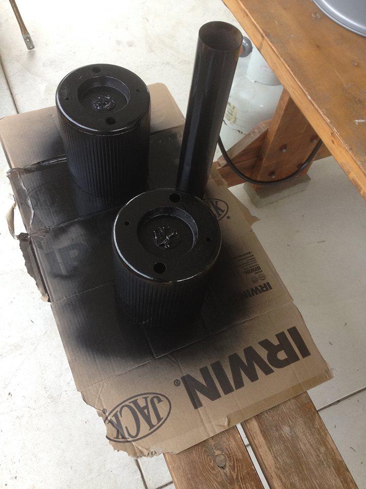

Hi all,
Got some painting done today. Still have the chain cover deflector and handlebars to sort out. I have all the new parts I needed now so its coming along. Thanks for the pictures of how bad the clutch housing can be. This one is still quite good so I will keep it for a bit longer, but I will upgrade it to the grub screw type later. I stripped the reel back and painted it red. Its at the sharpeners now. The plan is to start assembly and finish painting next weekend, so hopefully its up and running in a couple of weeks.
a great read and a top job so far there sir elton . should look amazing when its up n running again .
cheers2 Dave
Likes: 303
Hello Sir Elton and all,
I agree with Dave - a great read so far, and what great work!
That colour green seems very nice indeed.
Hi all,
Have to agree with the above comments. The black rear roller will look great fitted on the machine and the newer "sloper" style Briggs will mean that no adapter plates will be required to fit the original handle bar assembly.
A good read guaranteed.
PS. It's really good to see an unmolested twin rail chassis as they are rapidly becoming a rarity.
