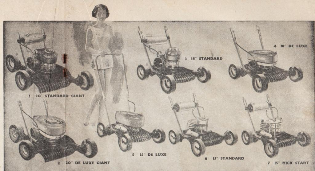

In any case, Mofast realised - before most ... that a range of mowers could
produce better returns on investment. As such, they would offer 15", 18" and
20" mowers, all sizes coming in standard and deluxe versions. There would also
be a kick-start 15" machine, taking the tally to seven models, at a time when
the biggest player, Victa, could only muster three (at best).

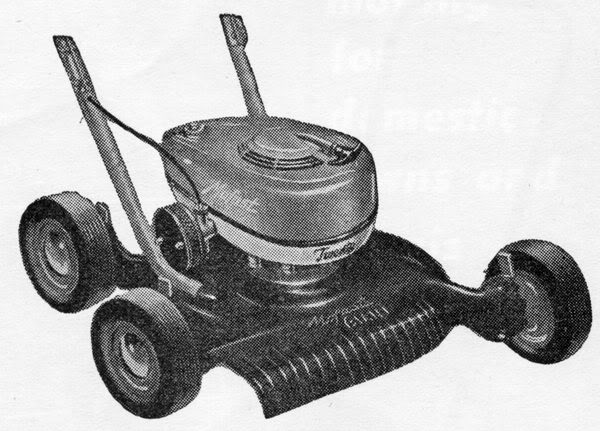

I have already said that the Mofast was made in three sizes, but with several
variants. Mofast used two, possibly three engine makes. The smaller machines used
the British Trojan Tor Minor and Major engines. The larger machines used the
Australian Hurricane 125, 180 and 185 engines.
I have found references in Repco and ACL catalogues of the day:-
Chassis
The Mofast chassis was cast alloy. The wheel base was not typical Australian 4-square.
The smaller machines had a narrower track at the rear, whilst the large 20" machine
had the American-style off-set front wheels and forward chute discharge.
The height adjustment was a more sophisticated form of the four-point
(on each wheel). Without tools, the height-of-cut could be adjusted by levers
in defined increments. This adjusting method, though favoured by American designs,
was becoming outdated on these shores by the single-point lever and segment system.
Only Pope (of the big manufacturers) would persevere with this system into the 1960s.
Special mention should be given to the styling of the De-luxe machines.
The tear-drop cowl and large fuel tank offered a recoil starter. The design is
reminiscent of American outboards of the period. Combined with the distinctive
'Mofast' font and we are clearly given a perception of speed. The Mofast could
turn grass into lawn very quickly!

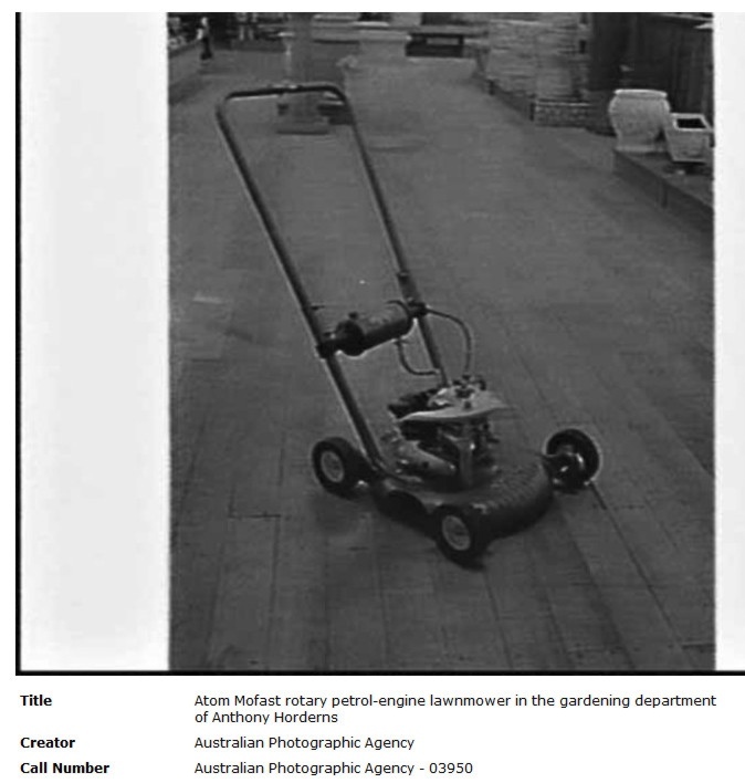

Source: http://acms.sl.nsw.gov.au/item/itemDetailPaged.aspx?itemID=74729

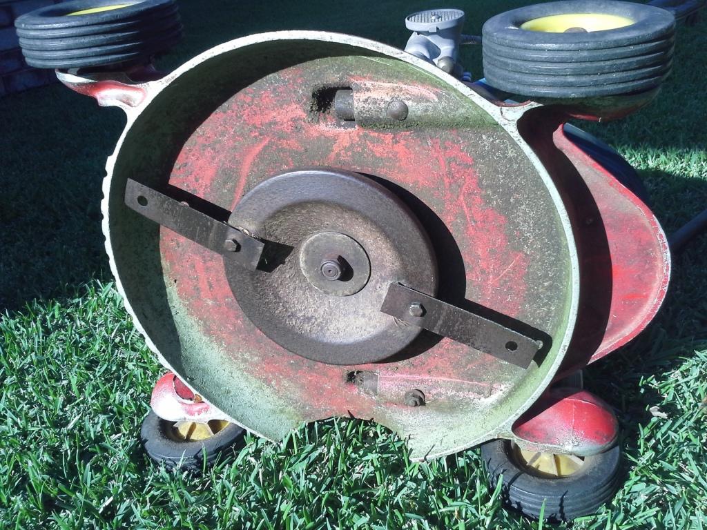

Their most unique feature would have to be the streamlined bases, and the tanks on
the Deluxe models. These were otherwise competent late 1950s rotary mowers with some
nice fatures.

Mofasts are rare today and should be considered highly desirable and collectible.
The rarer machines appear to be the larger models, particularly the 20 inch 'Giant'.

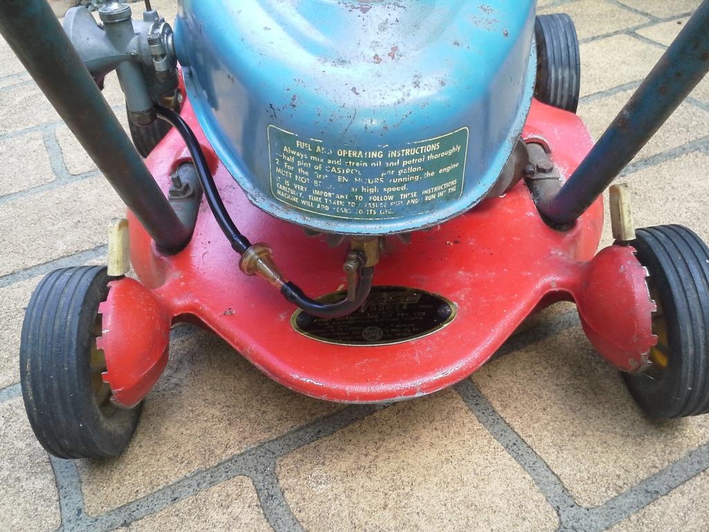

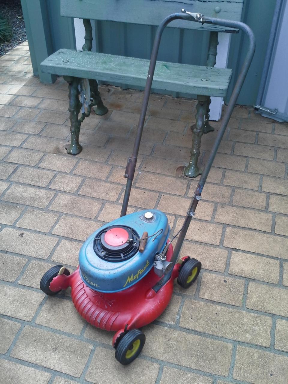

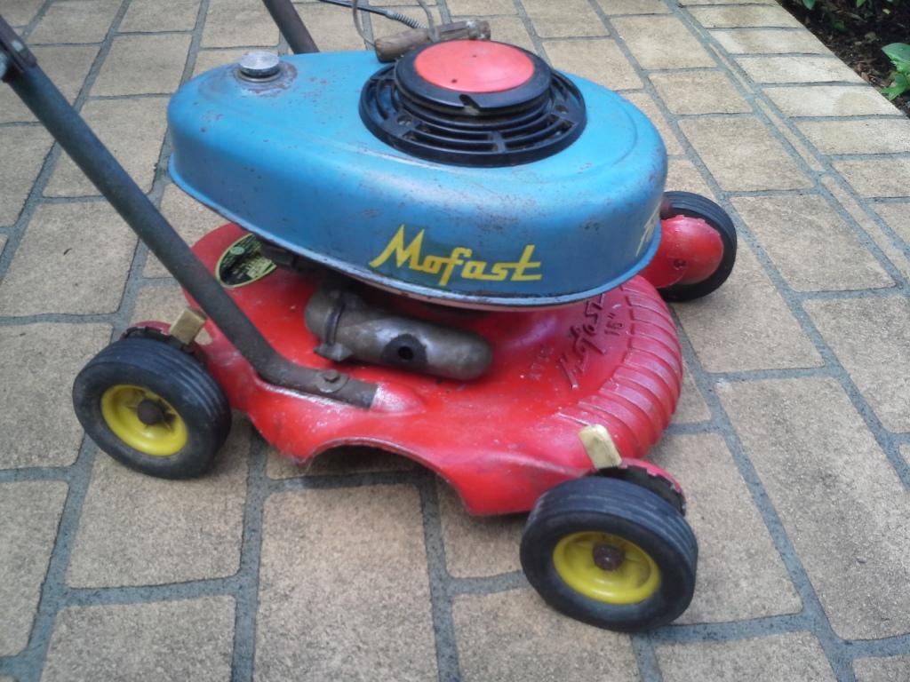

Member Paul C was lucky enough to acquire one of the most
original, low hour Mofast 15 Deluxe machines you will ever see.
