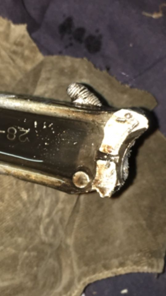

am i correct in assuming this is leg out of bed. or are you hitting on norm?

yep, that's a possible leg out of bed, usually caused by over revving.
if your motor is using oil but not smoking, sounds like the bottom seal is shagged.

Sean, the 'leg out of bed' description actually refers to when a busted conrod pokes a hole through the crankcase, as it lets go.

exactly Gadge, a broken rod through the case, under the starter usually!

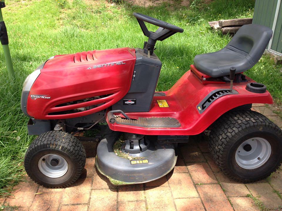

thank you all for the input. i have just recieved word that the owner just bought this [Linked Image]
26hp husky for 1500.
honestly thanks fellas i feel i have waisted not only my time but your time aswell.
i liked the first engine replacement option that was put forward here. easy simple fix.

motorwannabe
Posts: 693
What is he doing with it, harvesting sugar cane? 26HP sheez, make a hill climb car out of it I reckon.

squizzy so you recon after it was run with no oil for who knows how long, you all seen the damage. new crankshaft 250 odd new conrod 130 odd plus whatever else. do you recon these motors are that good that to rebuild will leave you with a superior motor to the new briggs for 450?
