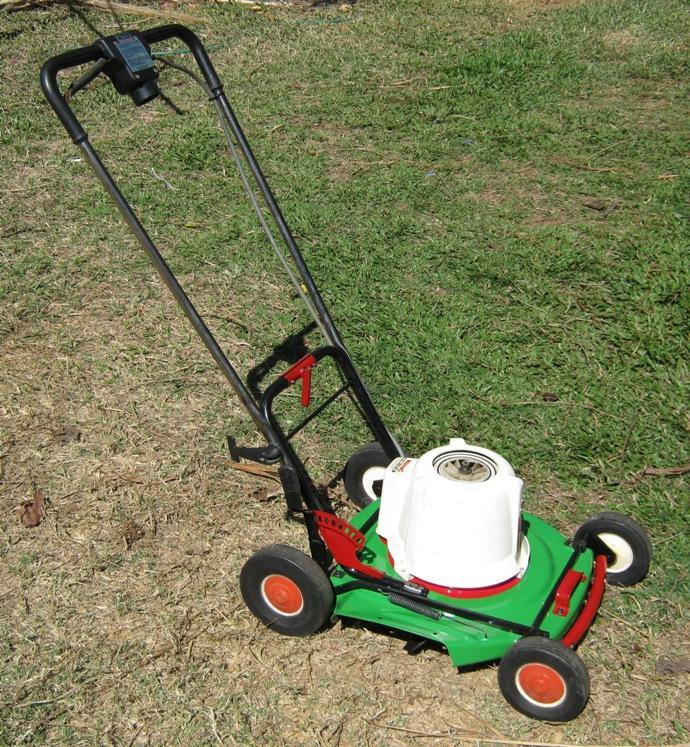

Well just to show I've been learning something from you guys on here I took another slightly-more-critical-and-trained look around my Victa 4-stroke utility which immediately led to a couple of points of interest (see pic below):
1) The B&S stamped crankcase/base number- 430 - does it mean anything? It's near the oil filler (top-right of pic)
2) The base-engine standoff spacers. I take it this is not a 'normal' arrangement?
I'm guessing point 2) points to a bit of a bitsa of a utility. Mind you if it is a bitsa then with the way it runs and cuts perhaps Victa was missing out on something.
[Linked Image from i1222.photobucket.com]
Patrick
Posts: 961
Yep, bitsa for sure, the stamped number is nothing I've ever seen(or noticed) on a B&S engine. Probably a number stamped on by the refurbisher as a way of keeping track of what's been sold for warranty etc.
As for the spacers, nothing uncommon amongst certain manufacturers in order to space up the engine so the blades don't protrude below the lower edge of the base.

Actually up a closer look at the above pic, i can see that the mower originally had a full crank 2 stroke mounted to it (the presence of metal under the sump and the hole it used to be mounted to) and the 4 stroke was a later fit and had to have the holes drilled out to accommodate it.

That base is really odd, the metal under the sump dips down, normally it rises up and the "engine sits on top of the hill".
Looking at the square holes and the lowered engine mount under the sump, i have come up with another theory. The Base if from an electric Victa utility and the square stamped out holes were used to anchor the motor cowl.

If it's a Victa Electric base I wonder if the Victa Electric went the way of the Automatic- the bases either got remanufactured into another (petrol) mower or they were sold off/kept as spare parts? The spare parts idea may explain the good condition of the base, but so would a recycled non-used or dead electric!
I think not. The Automatic was just a poor design. The decision
to put an electric motor on a utility base in the 1980s was, in my view,
totally mis-conceived. The future of electric mowers lay in residential
mowers (rear-catcher), rather than utility mowers.
The proof is in the pudding. The electric utility lasted for just a season or so.
The rear-catcher mowers live on to this day.
This utility base was designed for a Victa 2-stroke.
The engine spacers were a cheap way to adapt to the standard c/shaft
4-stroke engines on offer.
All very electric.

Counted holes today.
There are three square aperture holes plus one round hole on the upper outer ring.
There are three (I think) round holes on the inner sunken ring
There are the three holes in use for the engine mount which (like bigted) I believe have been drilled to mount the engine, in a middle ring area just outside the inner sunken ring. As you can see from the pic below the bolts plus nuts are "normal". Should they be Nyloc?

The base for the electric was purpose made and not usable on other petrol powered utility models.
The blade carrier is Victa, so all correct on the underside. Normal nut and bolt setup is fine as long as your using a spring washer, otherwise nyloc is the way i'd go.

G'day Patrick and Bigted
I'm with Bigted in not being certain about the four-stroke.
I can find no reference to one being fitted from this time.
I feel it is a replacement engine ...
I will say something about the electric. This one has always baffled
me. Whilst I believe it is the genuine thing - a Model 460 -
I do not think it was sold in this market.
The bumper at the front is decidedly UK market.
In this UK brochure note the odd bumber on the Super24, and
that edger looks AUS made - but not by Victa!

The book is the 85-86 spares manual.
The next page has the Professional 460 2-stroke with the
same base. I think the only difference is a bigger fuel tank.
The only electric is the rear-catcher 400.

Image below from the Victa Electric (Victa 400) thread, post by IanOz (as per bigted)?
Date in next image is Mar 1980 though, so 85-86 a bit late, sorry didn't know year of manual- is there a year/date I missed in the text?
Patrick
Yes Patrick,
that's the image that gave credence to a Model 460 Electric. And, yes, about the dates.
As I said, I have no records of it, nor does it appear in AUS records (that I have)
of the time. The Victa electrics entered the market in 1980.
I have made speculation that it was a one-off import from overseas (but made here);
maybe it was sold here. I don't know whether it was a local or export model. I do
know a QLD collector has one. Let's wait and see.
