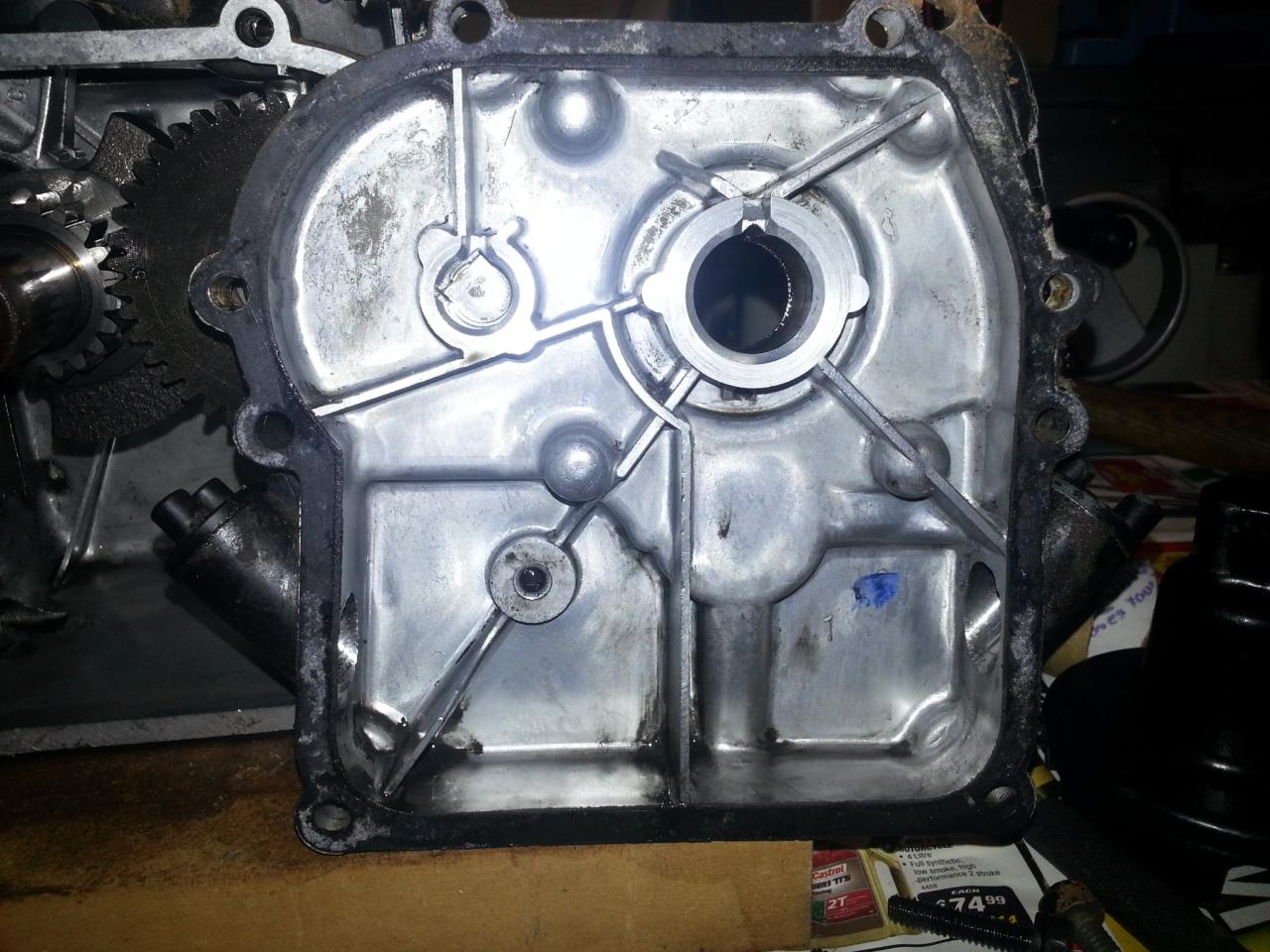

Remember that mangled keyway on the crankshaft?
Somehow I managed to jag a black 3hp briggs engine (a freebie - in a very sad state) but with a crankshaft that is in great condition and a perfect replacement for my red engine. Just have to dump the oil and swap them over. It has a 3/4" shaft to boot! Can finally get that 3/4" bonnar clutch with set screws.
Won't end up restoring the black engine, it has too many problems and won't be much use with the damaged crankshaft. I will end up keeping it for parts, maybe cleanup the carb and fuel tank to keep as a backup. The previous owner even tried replacing the diaphragm, it looks newish and is still quite supple, not rigid like an old one. The valves, springs, retainers, camshaft, head, head gasket and flywheel are in good condition too. yay

It's done. Just have to wait for the silicone to cure and then I can fill the sump with oil. Going to secure it to the edger frame and test it out tomorrow afternoon. I will post a video, if all goes well.

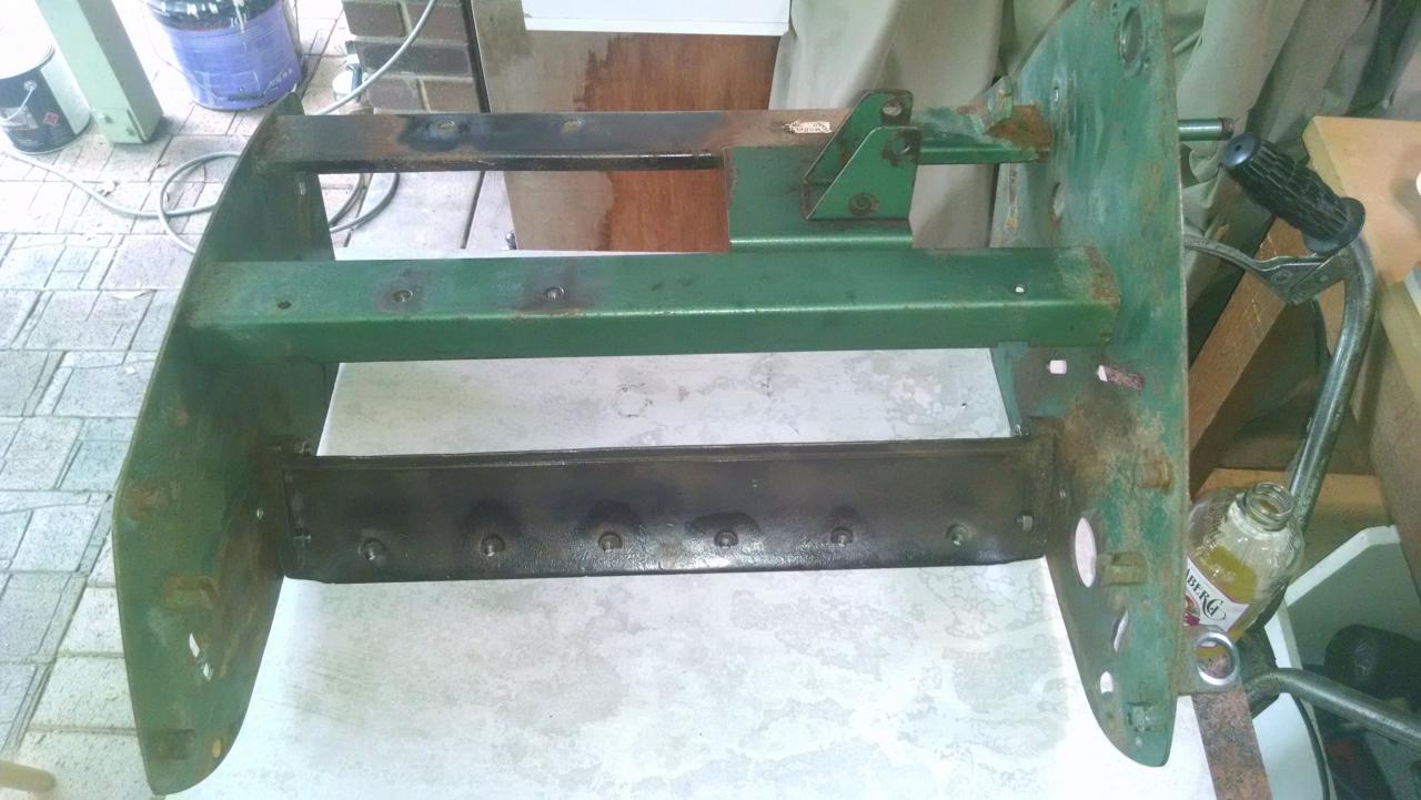

Ummm, before gettig the bed knife and cylinder sharpened, I was planning to repair the twin rails. Especially the one with the bend. Then I thought why not get some 1/8" or 1/4" steel plate cut, remove those thin/flimsy rails and then weld on the new plate? Seems as if those rails have too much flex and only the cast iron sole plate is holding everything together.

Managed to remove the bottom blade, so that I am able to paint that heavy cast iron sole plate. I'll have more photos as I progress. Already started to repair the sag in the rear rail using heat, clamps and a straight edge. Going to try strengthening the rails with some flat bar welded along the sides (underneath) so it can't bend again. Any cracks I find after sandblasting will be drilled out and welded.

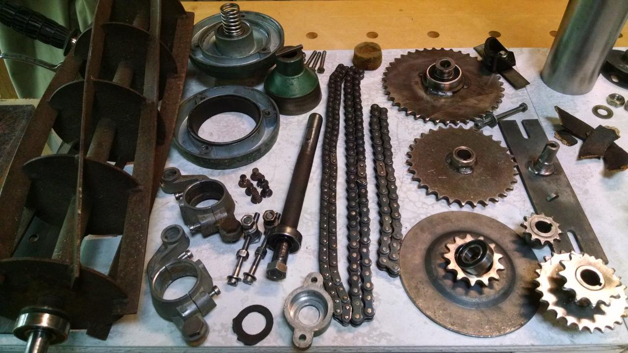

I am looking for some opinions on what I should do regarding parts, as I have noticed wear etc. This is what my work bench looks like.
Now...

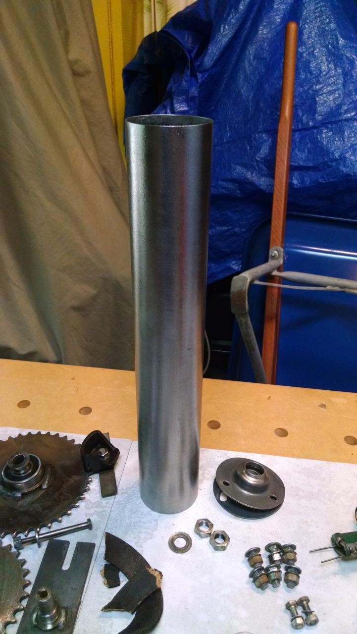

1. I used a bench grinder and wire wheel to clean off the rust from the front roller. For me, hot dipped galvanising would be the perfect choice to protect the steel roller and to stop it from rusting. Only might have to drill a hole in the side somewhere, so it can be hung by some wire.

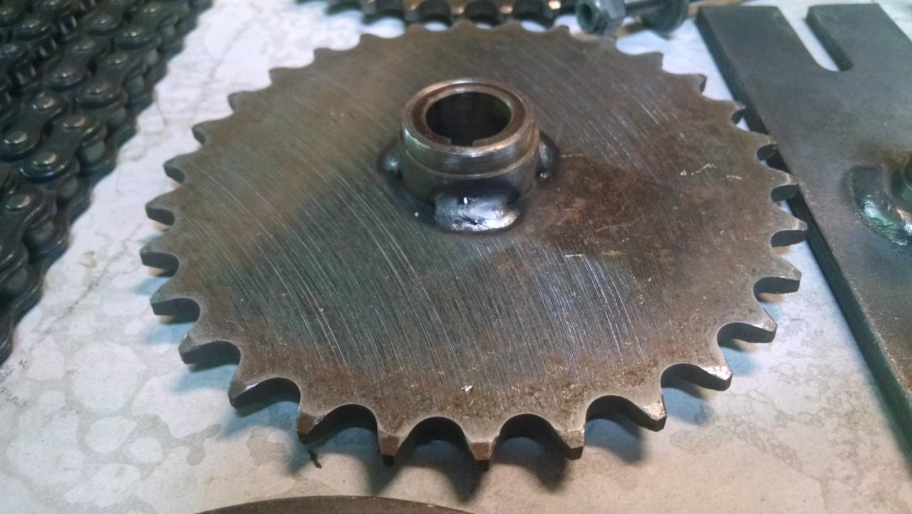

2. Sprockets look really good, from the images does it look like any of them need replacing?

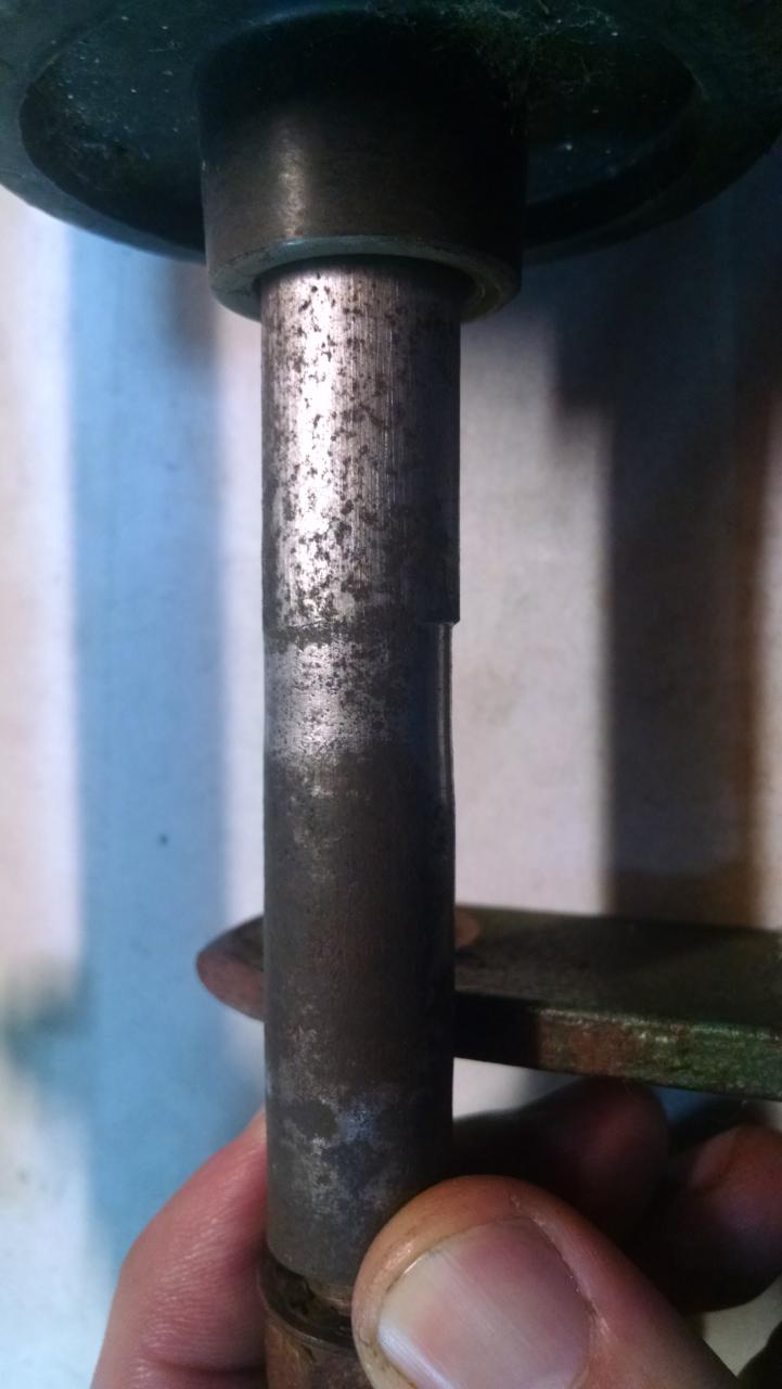

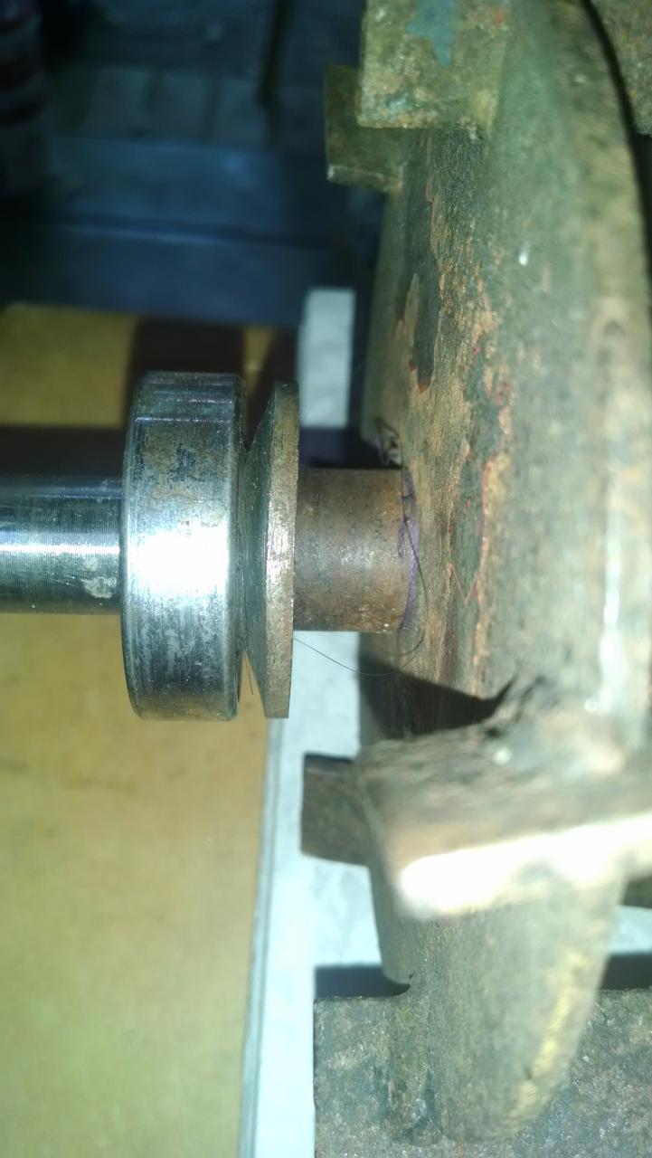

3. The shaft that goes through the front roller has been badly worn, as dirt has got in-between the end caps, causing abrasion and wear at both ends. These need replacing?

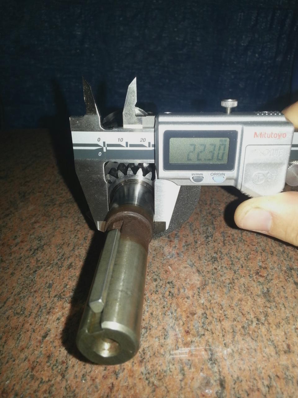

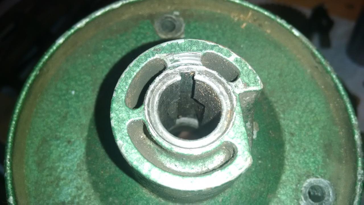

4. I already figured out that I need a new 3/4 inch clutch to match the PTO of my 3hp Briggs that has a 3/4" crankshaft installed. This is what the original 5/8" clutch and keyway looks like... I also need to replace bearings on the cutter, should the shield washers be a cone shape as show, think they need replacing too.
Lastly, I have been fortunate enough only to find only one prominent crack around a bolt hole on the front rail, as it is a lot thicker than the rear one, some small welds should suffice.
About to try ordering parts from this site. Any comments or observations will be much appreciated!
xhall #73931 23/03/16 05:13 PM
Posts: 8,215
Pretty serious resto you are doing on this one, did you get the new sprockets made or were they an off the shelf part? The welds appear recent
xhall #73958 24/03/16 07:52 AM
Joined: Mar 2015
Posts: 102
Hi Norm,
Yea, there is no turning back now. About to get a complete set of new bearings and might even look at getting a new 8 blade reel or one that has thicker blades to stop them from bending when hitting debris. The sprockets are all original, just wanted to get some perspective from users here as to their condition and whether or not they need replacing. There is no welding yet, the blackness is from burnt paint; where the chassis was heated to bend back a dent in the rail.
I did manage to remove the bearings at either end of the reel using an old 3 jaw bearing puller I had in my possession.
xhall #73959 24/03/16 08:15 AM
Posts: 8,215
Sprockets all look in good shape, no sign of wear on them
