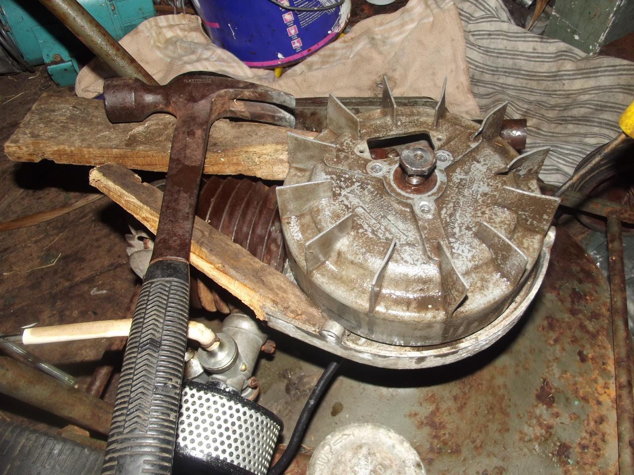

i am having issues removing the flywheel of this hurricane motor [Linked Image]
i have been soaking it for days and trying to to tap it of with the assistance of wedges.
i really dont want to break this, that is all i seem to do lately.
the key looks corroded to the point it looks white.
any tips would be great

sounds like its time to make yourself a puller now . or use a deadblow hammer hard plastic type of thing little or no thread damage then too . but a puller seems the go matey then you have one for future use wink
but you should be able to get the points through the inspection plate im sure ?
i always used a good pair of tubeless truck levers does the job for me . then a good sharp hit and off she pops
cheers Reg
use hardwood too , pine will just absorb the shock .......... just a thought lol

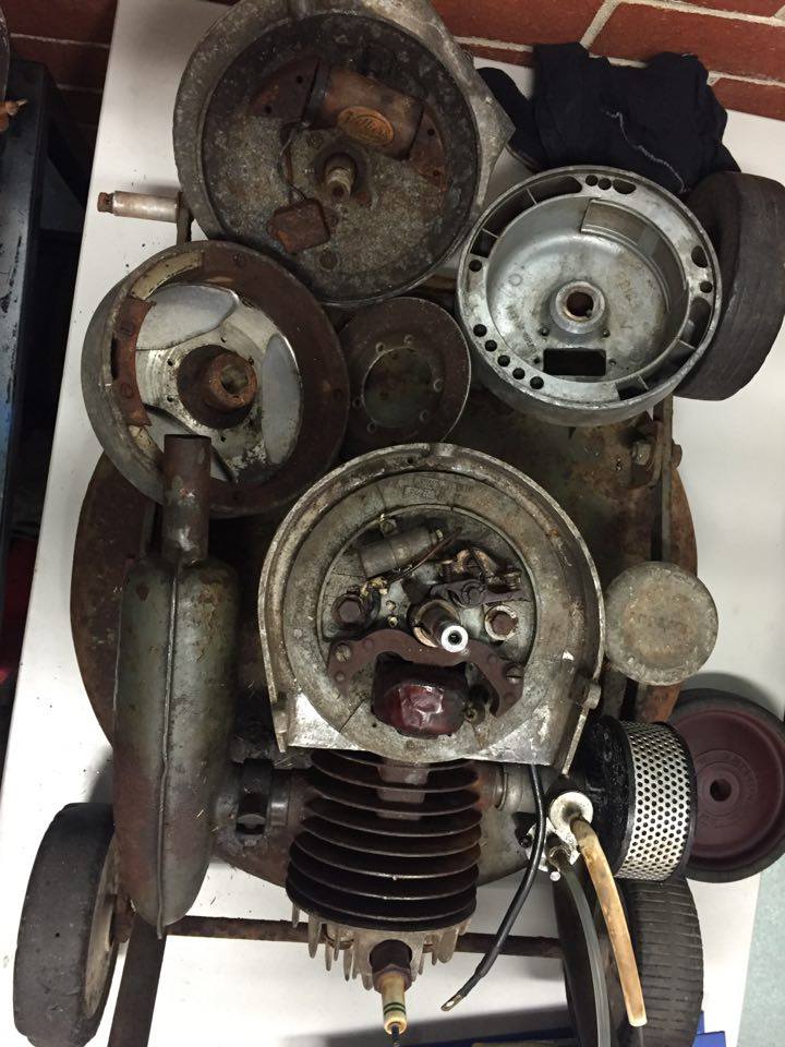

i could not get the plate off the villiars to expose the electrical elements(they just sheared straight off). so i tried to take the flywheel off with a 1/2 inch rattle gun. no go. i had to use a 3/4 inch rattle gun (with the biggest fella in the room pushing down on it)??? it came off with help from a couple of screwdrivers.
the flywheel on the amplion was easy to remove (after i found the right tool for the job!) harmonic balance puller.
the points on the amp were not opening up at all. have set point gap.
the villagers points i had to remove with long nose pliers so they are cactus. any ideas of a similar set of points i could use.
