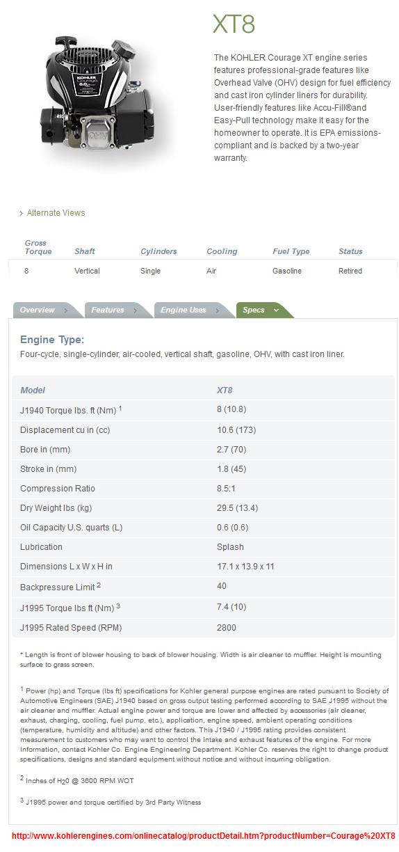

I must be getting old because this thing takes a big heave to pull it over, nearly pulls my arm out of the socket. It has an 8hp Kohler motor on it. If ever a mower needed a starter motor or kick starter this would be one

G'day Norm
As I understand it, the 560 is a big beast at 22 inches.
The engine is the interesting thing.
The Kohler is the optioned bit, but I don't think it is 8hp.
I'm hoping engineer Gadge can help here, but the trend has been to
rate modern small engine by torque, rather than hp.
In Australia, I guess our mindsets needs to adjust to Newton Metres.
This Kohler produces 8 foot pounds of torque (10.8 Nm).
I have no idea how that translates to old school hp...?

Thanks Jack, it sure is a big mower, I just assumed the 8 on the cowl signified 8hp, but boy you need a strong right arm to turn it over It has the XT8 engine fitted. Now reading the chart says it is only 173cc so I wonder why it is so hard to pull over, should have been fitted with a decomp valve like the zip start Victas were fitted with over 40 years ago

I am 'old school' - so 173cc equates to about 4hp (side valve) 4-stroke,
but more likely, about 5hp for an ohv like this Kohler.
I am 'new school' in wanting to adjust to metric understandings.
I am interested to know how we should correlate hp to torque, expressed
in Nm rather than foot pounds.
The reason the Kohler is hard to pull over is simple:-
engine decompressors have little to offer for large flywheels.
The size of a large bladeholder requires a certain starting technique...
You just lean back and pull slowly. Let the bladeholder inertia do the work.
