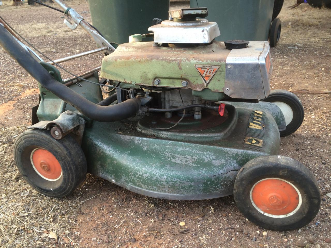

G'day Gentlemen,
I picked this gem up a while ago at an auction. The old kind where you stand there looking at boxes of rusty gold all day and fill the boot with the kind of stuff you need to sneak past the Mrs. Anyway. I missed the first mower, also a Victa it appeared to be in sensational condition with a period fuel can. Sadly I couldn't get my arm up quick enough and it went for something like $7. Anyway I got this for $15 from memory.

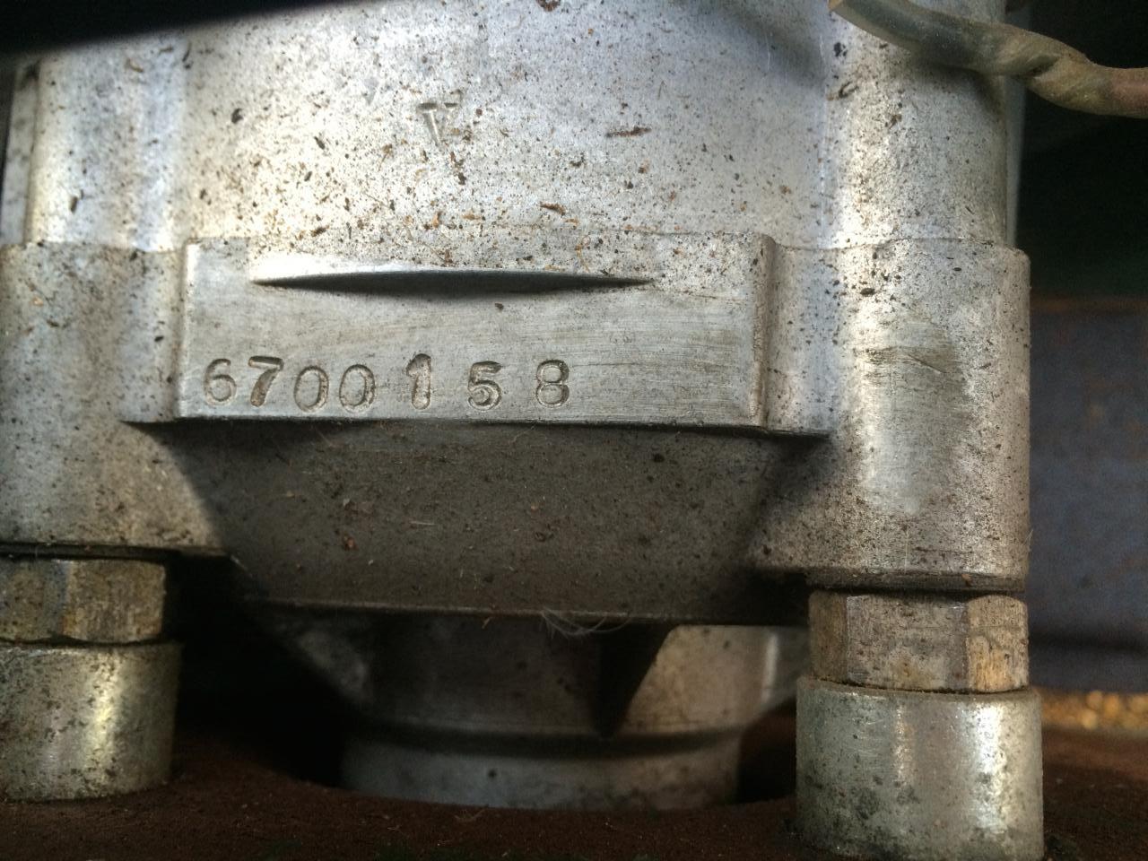

So rather than just tell me the year (which I would really appreciate) can someone explain how to decipher the engine number?
The base is cracked and split which is fine, I expect to be able to weld it but it's so moth eaten I just don't think it's worth the effort so what are my chances of finding another SP base?
Otherwise I might make sure the SP works and cut up a standard base and make one of the two.
Thanks in advance

So can anyone tell me if the 67 from the engine number means 1967 build?

Hello slashburn
We'll just have to see how this one develops.
The issue is that there is a miss-match between the '67' date stamp for the
engine and the 70 series cowling, carby, throttle, etc.
I guess I'm reading that all wrong, and the date is in fact '70' for 1970.
I think the Victa experts may offer some observations.
I certainly will need to think on this one.
p.s. I hope a member will be able to help with the base, as
these early self-propelled machines have been largely ignored.

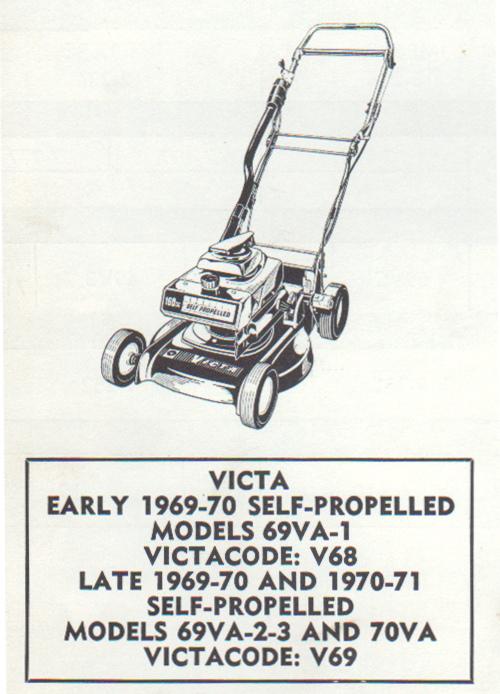

Hello slashnburn and jonesy
Thanks jonesy for helping out here.
slashnburn, to answer one of your questions. Jonesy has linked to a
very helpful topic on this. It is the '70' in the crankcase numbers
that (apparently) designate the year of manufacture of the engine.
The other numbers appear to be serial numbers for factory use.
My understanding is that Victa never published 'public' documents
on how these numbers might be interpreted.
I cannot give you an exact year of manufacture - because the
engine date year was not the same as the model year (the model year
runs from the start of Spring to the following end of Winter).
This means that your mower could date from the 1969-70 or the
1970-71 mowing season. It probably doesn't matter that much.
The thing that compounds the exact mower model identification
is that there were rapid changes to components on Victa mowers
in the late 1960s and some of these changes were made during the
season, resulting in multiple models in the one season. This
is reflected in the summary below.
The authoritative Mr Davis has identified your machine as,
probably, a V68 for 1970-71.
https://www.outdoorking-forum.com.au/forum/u...amp;Main=8641&Number=50596#Post50596

hi s/b, and a nice pickup there, it will depend on what you plan to do with it, but the base is unique
to the sp. so no good using a 'other' model base, if you just want a good looking resto, just use a metal based filler
and it will come up a treat, if you want to use it you will most likely need to find a good base.
cheers pete
