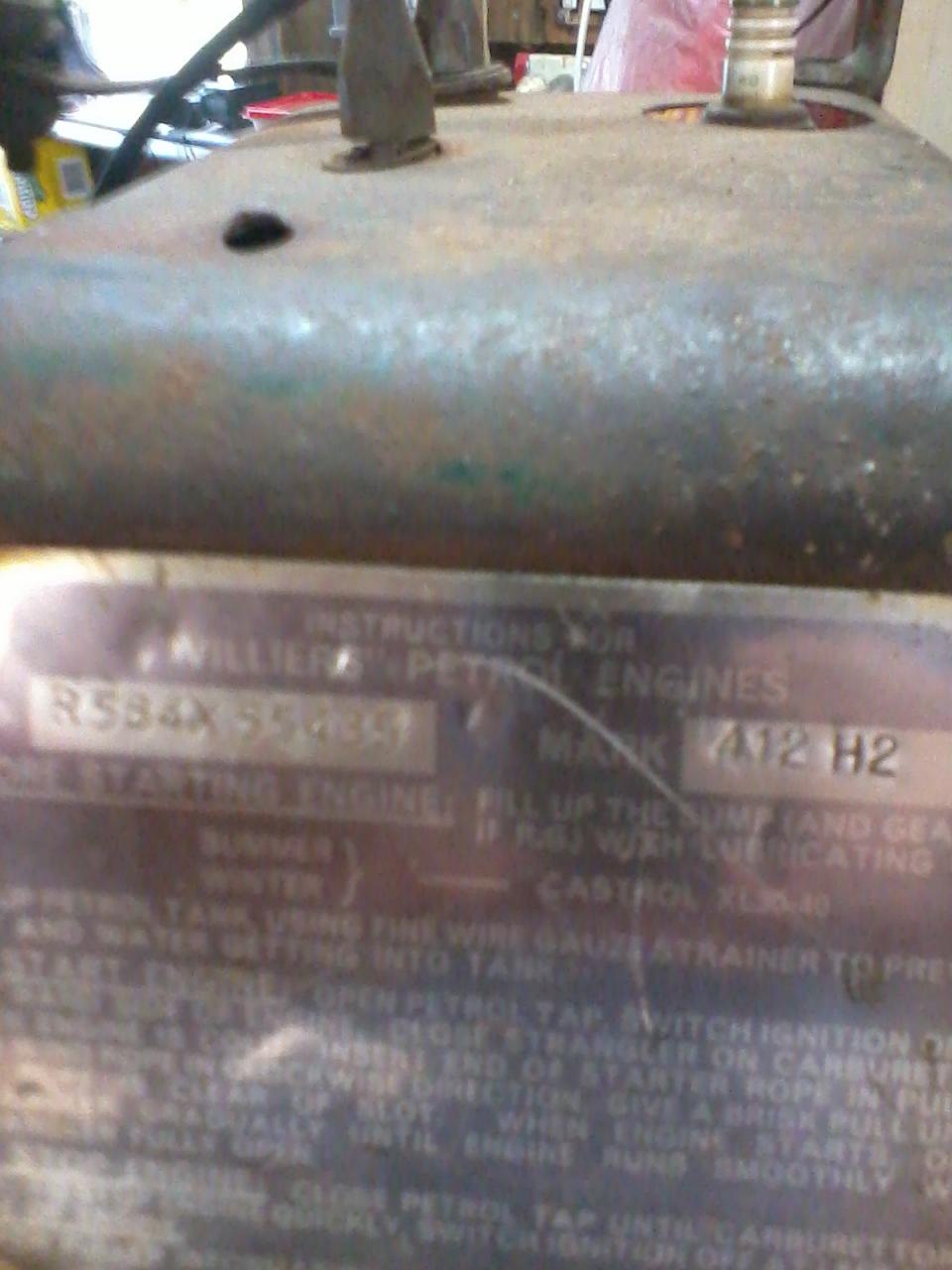

hey every one im hoping that my pic upload has worked if so could any one shed some light on what mark this Villiers is and what type of spark plug it needs and any outer useful info would be great too ps i know some parts seen are not original
Villiers plate

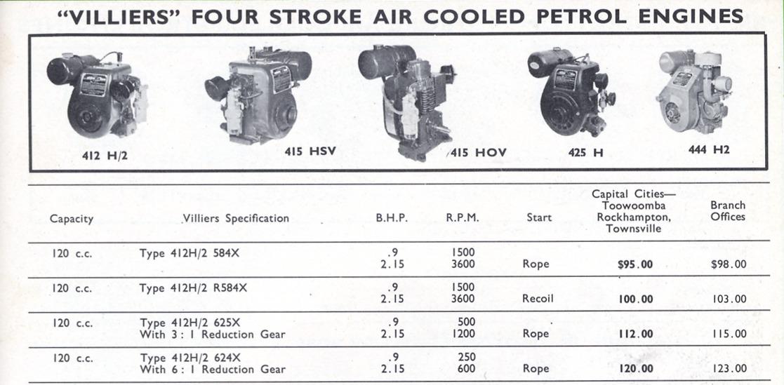

Over 1000 views and no response after 2 years, going by discussions on another forum it's a C12 with a different number designation.

Hi Paul_c
Thanks for answering this one. It seems to have disappeared
into the ether. For whatever reason, Villiers seem to have re-
assigned model designations for their engines.
C12 plug is correct for 12/2. Prefix cross matches so it should take the same plug.

Hi HT6 and CyberJack, not one of mine. I often look through and see what posts attract how many views. The initial post was from 2013 and had over 1000 views but not one response, I thought it should have closure :-)
That's an interesting chart there Jack and thanks for the plug info HT6.
