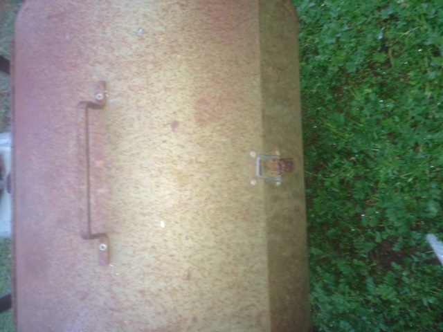

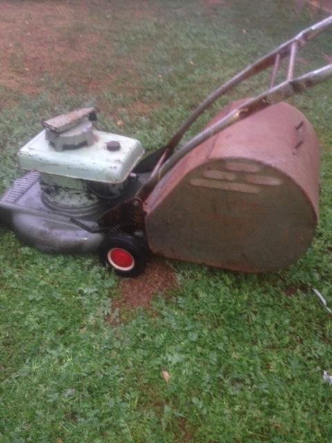

Here are a few pics of the palmer I have cluttering up my place.
Doesn't run but I'm yet to look at it. Could be simple...
Interesting catcher design. Anyways I'm having a clear out. Looking for a bigger boat so the mowers have to go. If anyone wants it pm me an offer.
