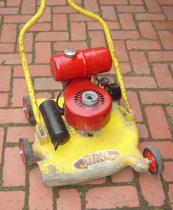

I bought this one locally this morning,
Engine number, what can you tell me HT6 ?
Engine turns freely and looks in good shape, spark plug lead has been cut off but grommet is still there. I will be on the look out for a carb and air cleaner if anyone has one please contact me.
Hey Paul,
Boy oh boy, you and Chris are finding some rare and unusual Pieces!
188X prefix is a Mk3 98cc Midget and was supplied to Technico".
Love the muffler, very rare style...
Hope that helps...

Here is a Nice sales image on "TECNICO" Paul smile

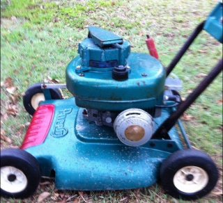

I did notice that this Pace body had some extra holes in it for another engine, would it have had a Midget engine as original and then upgraded to the 7F ?
http://www.ebay.com.au/itm/antique-...-mower-/262066141590?hash=item3d045bf996
Likes: 312
Hello Paul
The answer is yes.
This chassis was offered with the 7F and the 98cc Midget and the 70cc 3G for a period.
This advert dates from December 1957:-

Do I need to remove the flywheel to see it ? I noticed in the advert supplied by Jack that the two mowers on the right of the 7F have the older ? Bases. The 7F is sitting on a different style ?
No mate, its on top of the flywheel, just in line approx with the stud that holds the fan assy on...:)
In regards to the bases, Yes thats correct. This is why I asked you which base you were using, the ebay one or the earlier one...
The later base in your ebay ad(and Jacks ad) only came with the 7F and 3.6 HP 125cc Victa 2s
The 98cc midget and 70cc 3g used the earlier longer bases like the one you put up in the Pace thread....
Posts: 988
Likes: 7
So the bolt holes probably won't match up then ?
