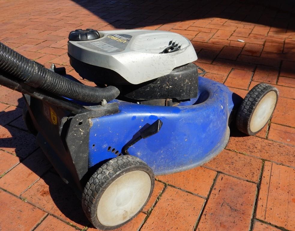

Anyway - this is about kerbside finds.....
Just to console myself about losing a mower - I decided to buy a new Stationary Engine - found a JAP 5 (to go with the JAP 6, 4/3, 4/2, 2a and 2s) out at Arcadia so off to pick it up.
As luck would have it - it was the Council Rubbish Collection time in Galston and lo and behold, as I'm driving through Galston what do I see sitting proudly on top of a pile of junk.....
I haven't had a really good look at it yet, but so far:
  • Doesn't have a throttle cable
  • Wheels are really tight - don't turn very well
  • No air filter
  • NICE BIG FAT SPARK!! smile
I'm guessing about the only reason it was thrown out was because the wheels are so tight its really quite hard to push.
That and the fact that one of the blades has spun right around and is now trapped on the inner side of the blade plate - I bet the whole thing vibrates like crazy when started.
Lose a mower - find a mower - serendipity at its best.
The catcher is in good nick too.
I think I'll chain this one up.....

Well its going.....
Serviced the carby - new O-Rings, Needle, Diaphragm, Primer Plate, new O-Rings for the manifold (big and small) - and of course gave it a real good clean.
Put some petrol in it fired up almost straight away.
Engine is running really well - but running quite fast - despite the new O-Rings - had a few goes at pulling it apart and putting it back together, trying to be real careful with the assembly - now when I start it it run s quite well, will respond to throttle, but once I go to full throttle, it pretty much stays there frown
Gives me the impression that the throttle cable is getting stuck - but when I pull it apart I can see the throttle working OK.
Hmmmmm
Bloody kerb side mowers!!!
blush
Polybus
Polybus #67572 11/09/15 07:24 AM
Posts: 988
Likes: 7
Nice score all the same, you will have to post another pic of the mower after the clean. Well done on getting it up and running.
