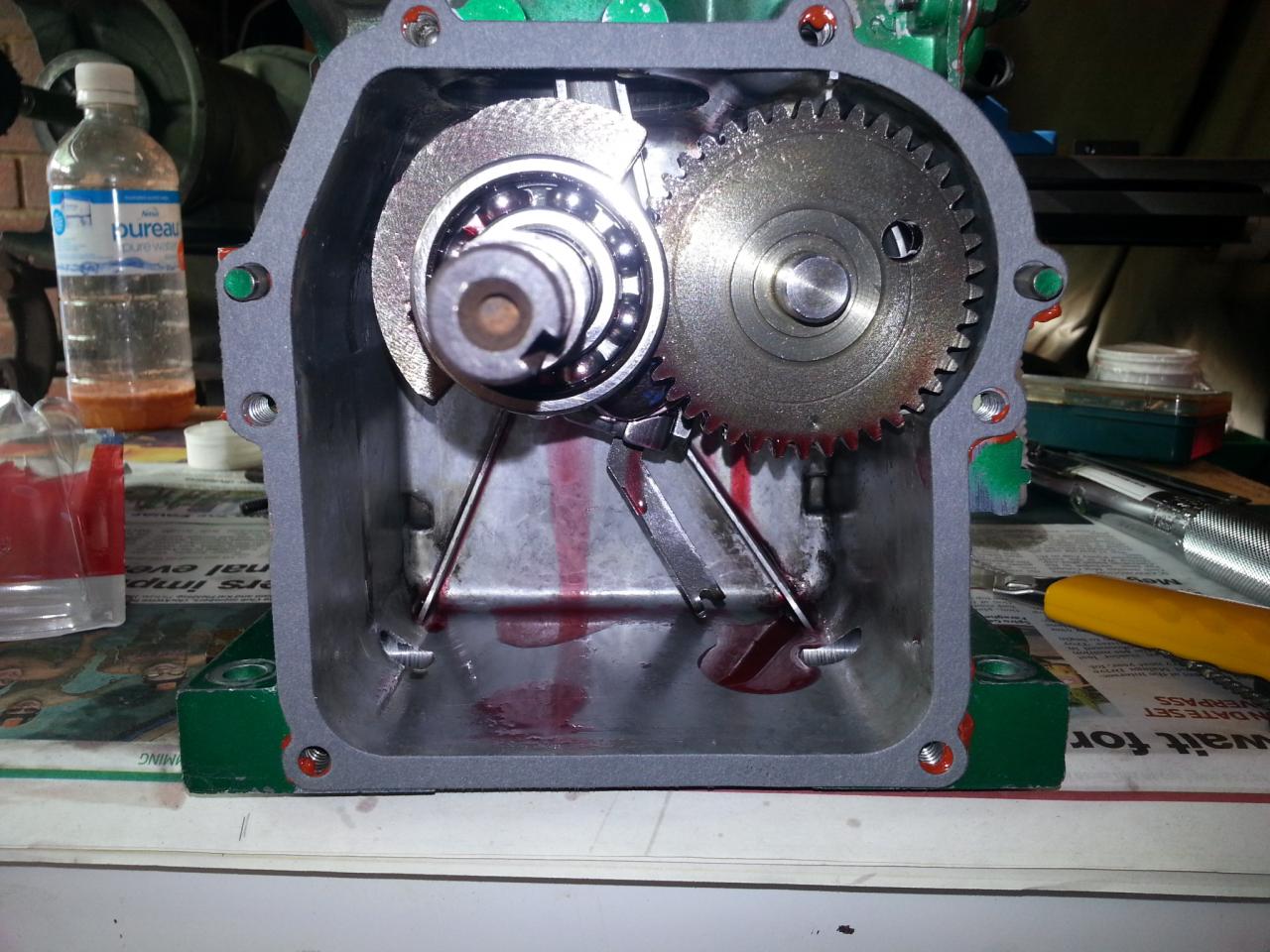

Wanted to know what will happen with a one tooth (either way) misalignment of the cam gear with the crank gear. Reason being, is that I have a flange mount crank bearing covering the usual timing mark on the gear. The punch mark on the crank counterbalance is between teeth instead of alongside one tooth and I am not sure which tooth it is supposed to be referring to. Pic below, to help identify my issue:
Posts: 5,380
Likes: 34
xhall,
The first thing you want to do is remove the bearing and do it properly. Trying to do it the way you have is open for issues.
If you don't line the marks up correctly you will have timing problems and the machine will not run or run badly. cheers2

Don't have a proper bearing puller and it is pretty tight. frown
Should I try to heat the bearing up first and then attempt to move it?
I think I only need to move it about an inch along the PTO to get a good look at the gear, not remove it completely.
But then again, maybe they didn't even mark it....

You need not to remove the bearing but your trying to time on the wrong side. Your current picture is way out of time.

Oh wow, I was way off. Your a lifesaver AVB; saved me a heap of time and trouble!
I assumed that the timing marks had to be aligned in a horizontal plane as per my previous engine. Boy was I wrong (I definitely need to take the time to inspect the parts more closely before taking them apart).

Timing marks now aligned correctly wink

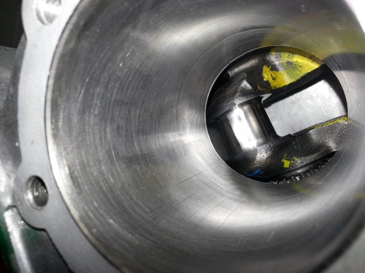

Even after 30mins, some scoring still remained, luckily it's at the bottom of the stroke and not too deep. Must have accidently chosen a really fine stone.
Cross hatch pattern left in the bore. Not quite 45� but close enough. Drill was rotating at about 80-100rpm and you have to work it hard and quickly (up-and-down) 1/2-1 second per stroke to get a good hatch pattern. New rings were fitted.

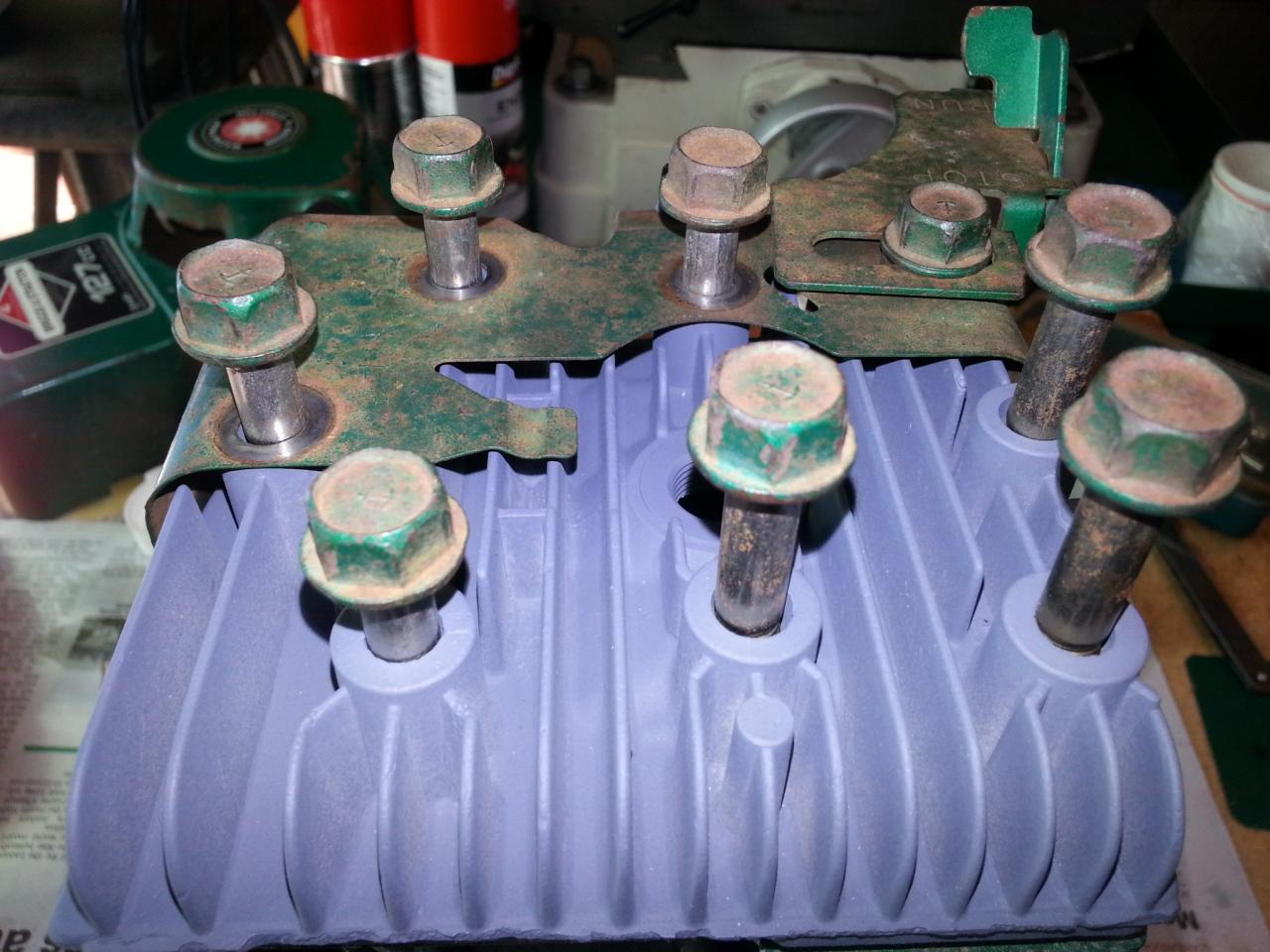

Decided against painting everything, only the cylinder head got primed. Oh, and the 3 longest bolts go around the exhaust port.
