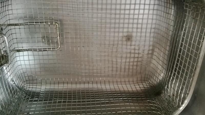

I got the idea of using an old deep fryer from "Roebuck".
Cheers, it should work a treat.
So for $2 at the recycle centre, here it is.

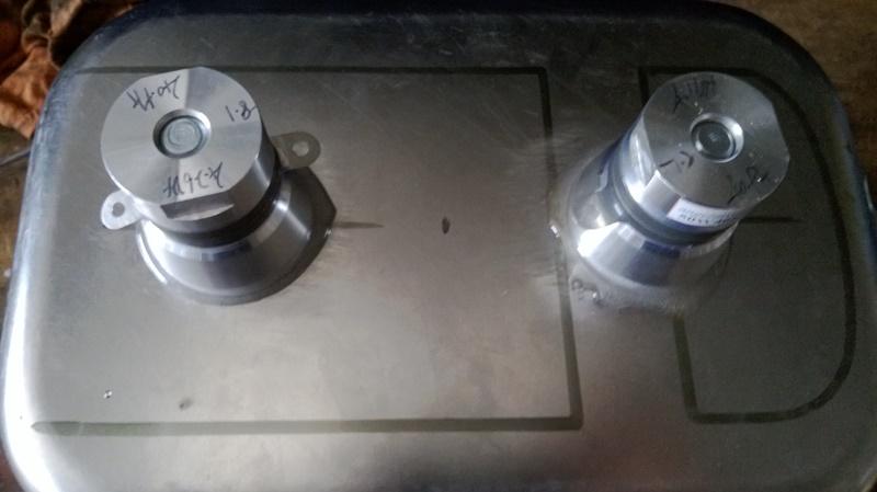

The kit I bought is a generator circuit card and 2 x 50W 40kHz transducers.
Basically, 240 Vac supplies the board.
The output from the board powers the 2 x transducers that get attached under the cleaning vessel.
The Card I mounted up in an insulated enclosure.

I didn't do solder connection to the transducers, as 250 deg C max is recommended.
I was going to use heat sinks and solder them, but ended up connecting them with small nuts and bolts.
