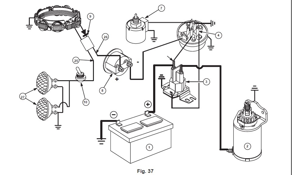

briggs and Stratton 8hp wiring diagram please help
model 190707
type 552501
code 82030812
it has electric start please help
hi
Hi Josh, welcome to Outdoorking.

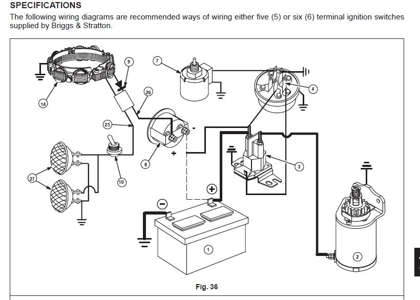

The engine just has a kill wire, a pair of alternator output wires, and a terminal on the starter to connect the heavy wire. The more significant wiring is almost entirely on the mower, not the engine.
There are two standard designs for the mower wiring recommended by Briggs. The difference between them is that one uses a 5 terminal starter switch, and the other a 6 terminal. Here are the diagrams:

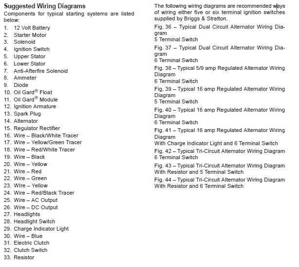

I'm an electronics technician with 50 years in the trade and neither of those circuits make much sense to me without a legend. What is No.7? An interlock, or a kill button? Or is the kill built into the key switch? Where is the wiring for the spark plug? Maybe it would be easier to work out with the machine to compare to I guess.
Joined: Mar 2013
Posts: 193
7 is the solenoid on the bottom of the carb bowl
Joined: Mar 2013
Posts: 193
The diagram only shows the 12 volt wiring, no coil nor kill switch shown....
The legend for Briggs wiring diagrams is generic rather than specific for those two diagrams. Here it is:
