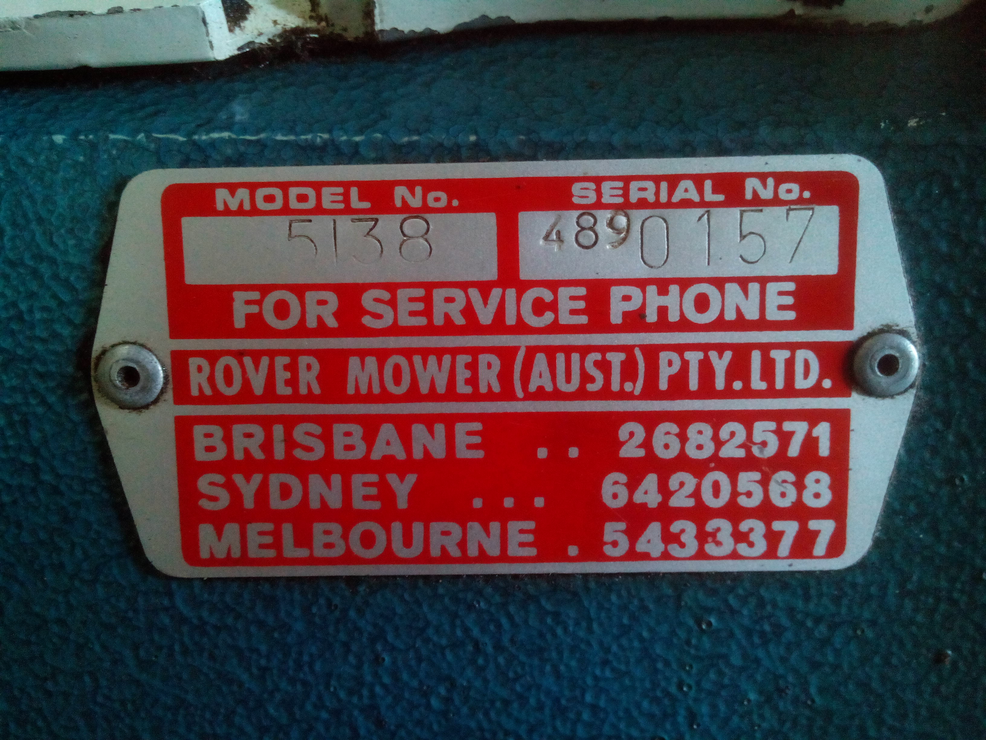

For the record, I wouldn't mind a close-up of the manufacturer's plate.

Here is a picture of the plate as requested.
Vegamo is quite catchy laugh
If a man says something in a forest, and no woman is around to hear him... Is he still wrong?
Hello Fireside
Thank you! Very much appreciated to have this on record.
If you want to date your machine, the Model, Type and Code on the motor
should be pretty accurate (assuming the motor is original).

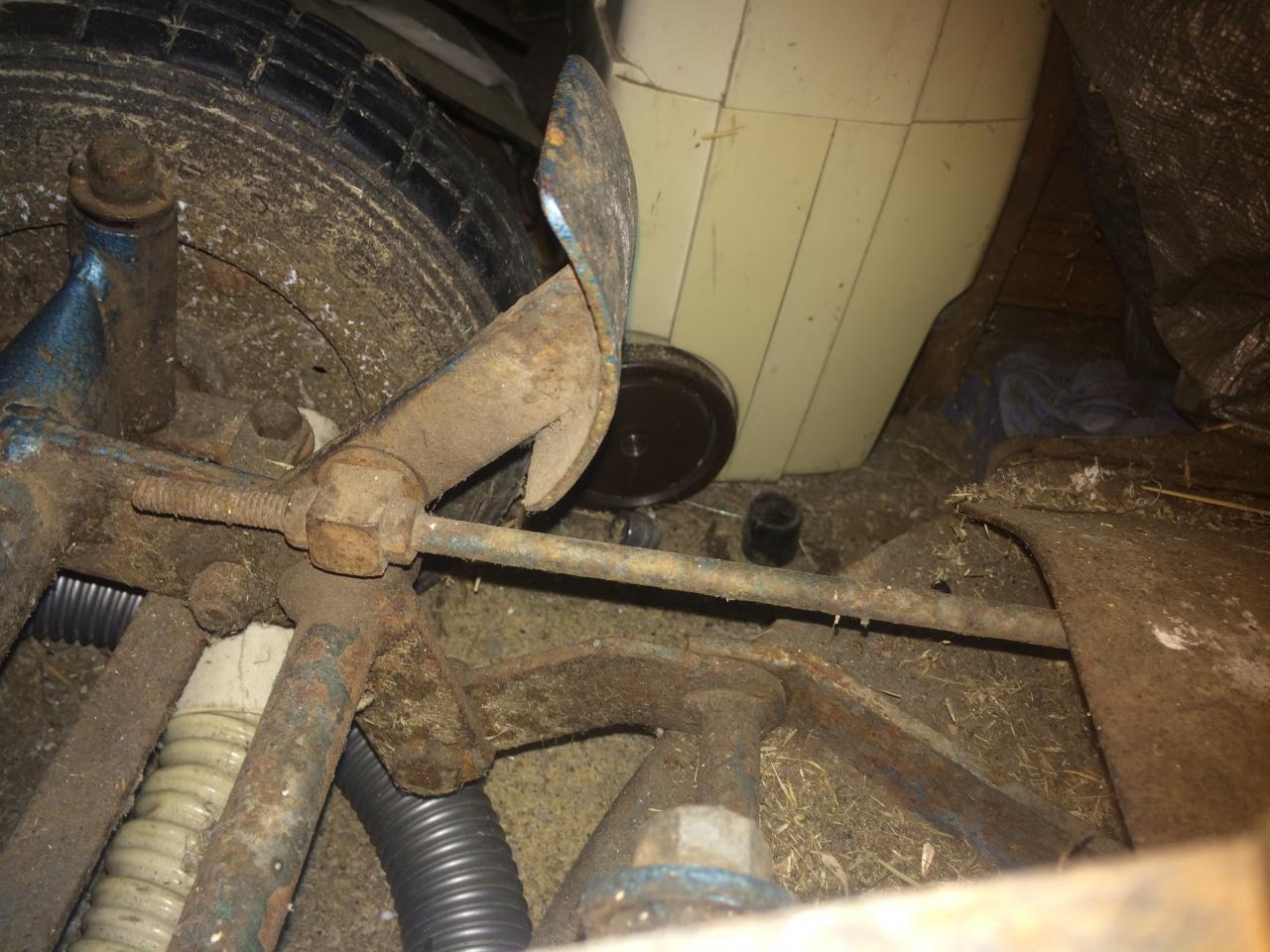

Thank you for your offer. It would be great if I could obtain a photo of the linking rod that is attached to the lever (attached) on the scrubber brake shaft.
Many thanks.
Posts: 387

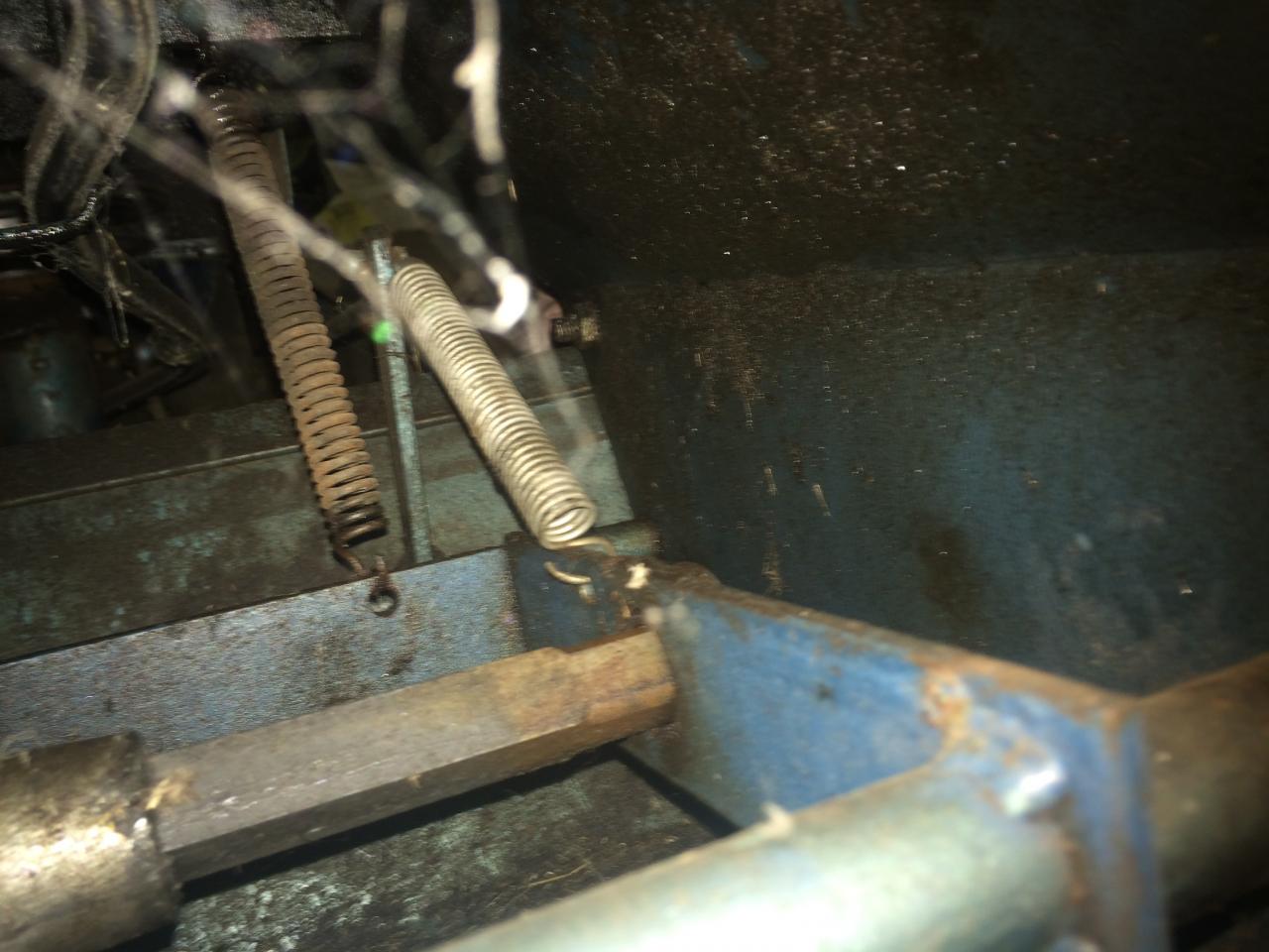

Sorry it's taken me so long and for such a bad pic. The rover is in the back corner of my garage that would send fear deep into the heart of the bravest mountain goat.
Anyway
I haven't forgotten and hope this ties you over. Would you like measurements so you can fab a replacement item?
I'm in the process of cleaning the shed up anyway.
The long spring belongs to the clutch setup
The shorter is the brake return. If you're looking for a return spring the average self respecting engineering supplies or bolt shop should sell them. Alternatively head to bunnings and pack your wallet.
