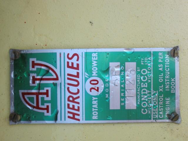

Hi I've recently acquired an AV Hercules minus engine and it matches colours of one on another post with a Clinton engine. Would I be correct in assuming this should also have been fitted with a Clinton as the hole pattern doesn't match a LV30 I was going to use for it. Also what is the significance of the 'A' on the model does this indicate engine type.

I would check the stud pattern again ,the Kirby only uses 3 bolt holes and when I make my Victa Kirby base the same
size as the AV Hercules on the computer screen and measure the holes they both look the same.(spark plug at the back of the base)
Max.

Hi Red Rum,
Going by the link below as you mentioned the other AV having a Clinton motor has the A on the id plate ,you would assume the
A represents a Clinton 4 stroke motor but only seeing a couple of mowers with the A and a Clinton it's just a guess.
https://www.outdoorking-forum.com.au/forum/ubbthreads.php/topics/106808/austral-villiers-hercules-c1959.html
It's up to you how you would like to restore this mower base ,the Clinton 4 stroke is harder to find than the Kirby but
all 3 four stroke motors will bolt straight on as the pattern is the same even a briggs will bolt straight on.
Pics below showing bolt pattern the same for Briggs and Clinton 2 stroke and is the original Kirby pattern.
Max.

Trust me it doesn't the two front holes line up and the rear is about 20mm off

I'd just drill that one hole Red Rum.
Makes sense that one hole being out as my 2 stroke motor had 2 holes at the back so was assuming the Clinton 4 stroke would also fit.
Max.
