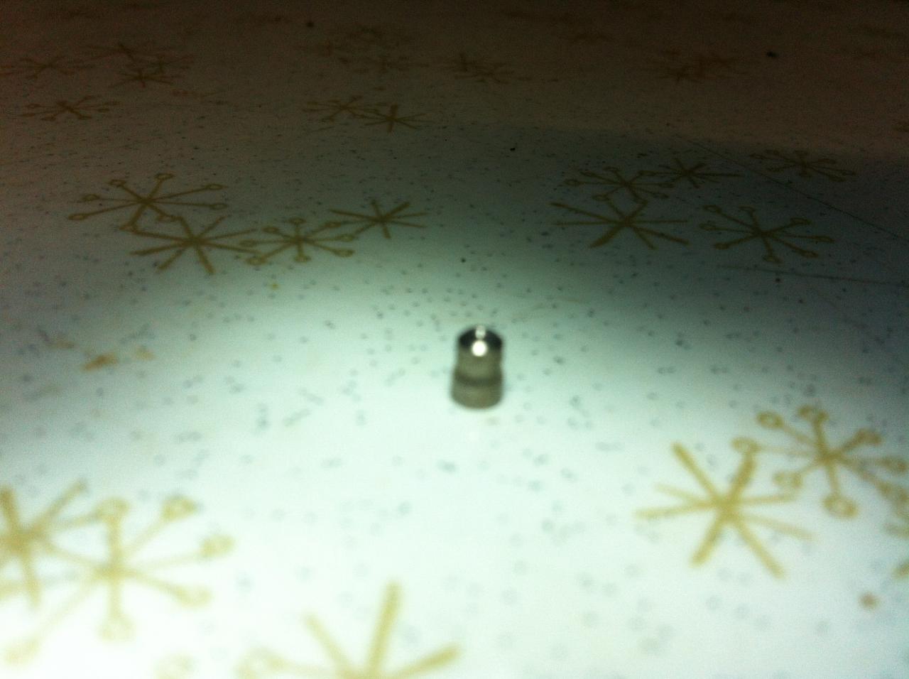

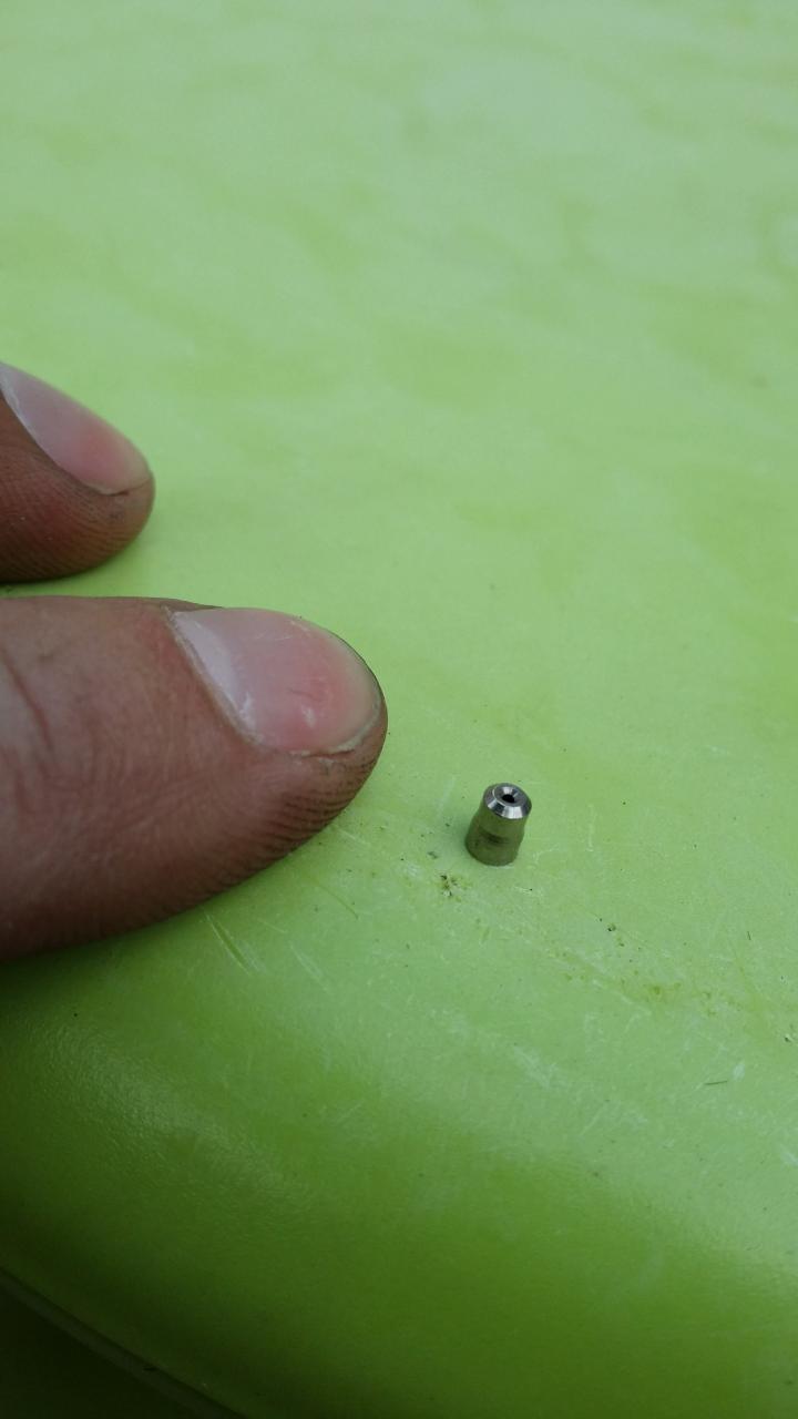

1) When I was removing the carby assembly, this part fell out... I think it might be from the carby assembly, but I'm not sure! If I knew what it was called I could have tried an online search but am at a complete loss. [Linked Image]

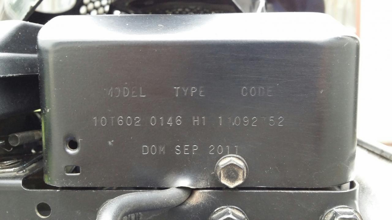

Need to post your engine's numbers. I am not familiar with Victa setup.

That small piece is either a check valve or a metering jet. I haven't seen one on a pulse prime carburetor but that we need to look the engine's ipl. We can't do that without the engine's numbers.

The jet has fallen out of the bottom of the spray tube. It's something that has happened a bit on the newer pulsa prime carby's. It lives under the mesh filter at the bottom of the carb and should snap back in but may fall out again depending on how poor a fit it is.
Hunting is caused by several factors and usually starts with air leaking in the fuel delivery system somewhere or an over revving engine also has a tendency to hunt. Replace the jet, use a new diaphraghm if you haven't already done so and report back to see if the problem has been rectified.

Funzo, I agree with AVB that we need the engine's Model, Type and Code, so we can link it to the Illustrated Parts List and make this thread coherent and useful to other members. They will be stamped on the top cowl of the engine, or on a sticker that is fairly easily visible.

So the jet sits inside the mesh filter? With the narrower end pointing down?

Here are the engine details. I will try to have another crack at the mower today and will report back.
That "hinge" is the connection between the governor arm and the wire link to the throttle on the engine. Hence it moves when the engine is running, to keep the engine speed steady at whatever you set it to with the control lever, regardless of the load on the engine. Make sure there is nothing obstructing that linkage.
Some details on your engine. First, it was made on 27 September 2011, in the Briggs plant at Chongqing, China. All Briggs side-valve engines are now made in China: the small ones like yours have been for about ten years.

Here are a few pics of the difference between the earlier and the late model jet setups on the pulsa prime carby's.
The first pic shows the later model one with the jet removed on the left, notice how the hole is much larger.
And here's the jet.
Last pic with the jet fitted.
Funzo, the jet goes in with the tapered side going into the tube.
I'm still not convinced the carby is not the reason it's not starting although it doesn't eliminate the fact there may be a problem with it.

Hi again everybody, I replaced the jet in the correct orientation as shown by bigted. Don't know if it was that or something else, but I just started up my mower a few minutes ago! and so far at least there is no hunting. I'm very happy and would like to say a HUGE thanks to grumpy and bigted for your help and advice!!
Thanks for reporting back on that Funzo, you've given this thread a conclusion, which makes it useful to others in the future. I think you can be fairly confident you had the jet in the wrong way, and have now corrected it.
