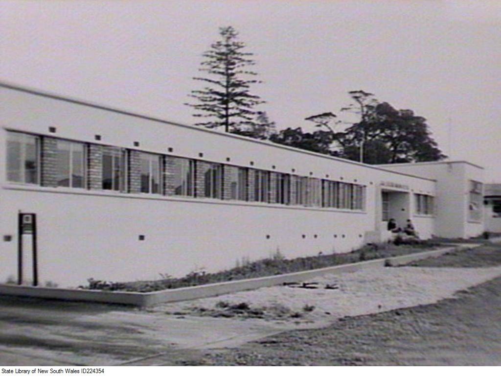

The first was G.M.F. Electric Motors of Bonar Street, Arncliffe, Sydney.
GMF was a significant manufacturer of Fractional Horsepower Motors for industry, and made some
domestic consumer goods, like its famous bench grinders.
Here is a photograph of the then modern Arncliffe factory:-

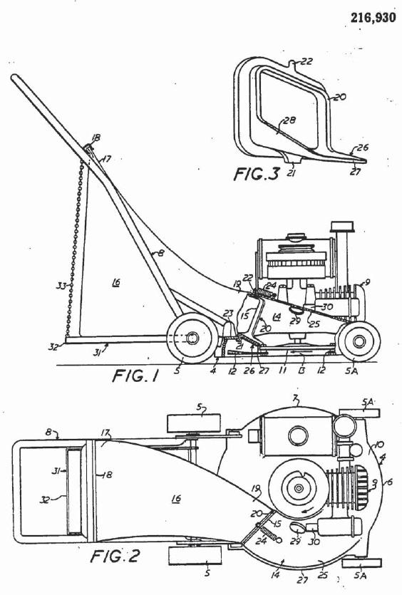

PART 4 - THE PATENT
The patent for what would become the Collect-O-Matic was lodged in late 1956, with the specification
Published and Accepted by mid-1958.
The Actual Inventor was George Albert Cumines, but the Applicant was G.M.F. Electric Motors Pty. Limited.
The patent relates to 'Improvements in or Relating to Rotary Type Lawnmowers'.
The main object of the patent was in providing for a grass catcher ('container') that was lighter,
larger, and more efficient at catching grass.
Most importantly, the patent envisaged 'flanged cutting blades' and an 'inclined open ended duct'.
That 'inclined duct', fitted to this machine, would later become known as a high-arch rotary lawnmower.
The Collect-O-Matic was ahead of its time.
The patent envisaged the concept of the 'velocity of air' needed in the design of the arch and even
discusses the possibility of engine exhaust assisting air flow!
The catcher would not be metal. It would be a flexible material (like canvas) for light weight,
although this design envisaged a metal support for the bag. This was an American-style 'bagger' mower,
and it would pre-empt the use of synthetic catchers used on many lawnmowers today.
Here is the Illustration that accompanied the Patent.
The full Patent Document is attached below.
PATENT 23537/56
Likes: 317

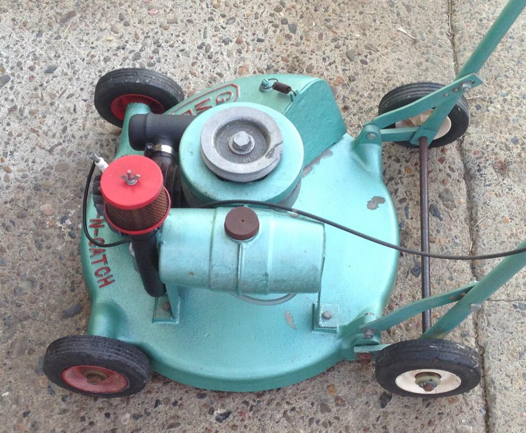

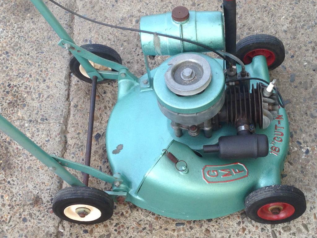

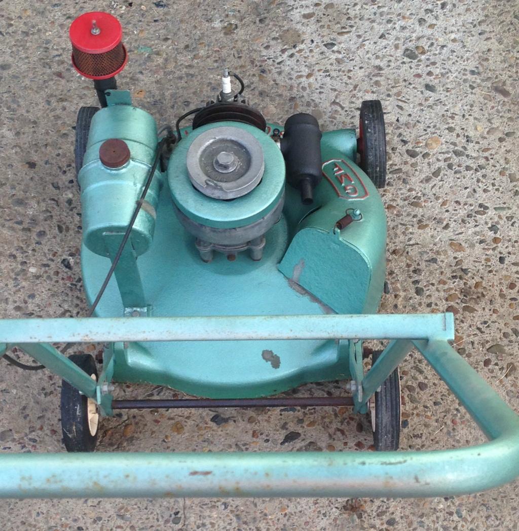

This is the first model Collect-O-Matic, the GMF Cut-N-Catch.
NOTE: the exhaust directed towards an aperture in the arch chute and the manual height adjustment.

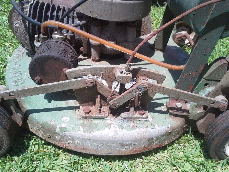

PART FIVE - UPDATE - Exceller Collect-O-Matic
Member Paul C was astute and lucky to acquire an Exceller Collect-O-Matic in
early 2016. This was the second version of the mower, still powered by Hurricane
(before the Victa engine), and with significant upgrades from the original model
(see discussion above).
This was the most advanced Australian designed and manufactured lawnmower of
the 1950s, and should be considered the Holy Grail of vintage Australian rotaries
for a very simple reason - it was a decade ahead of anything else on the market.
Like all of these machines that have come to light, the catcher was missing,
but apart from that, it was in amazing, original condition.

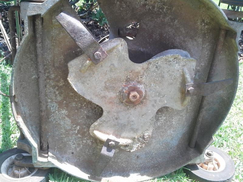

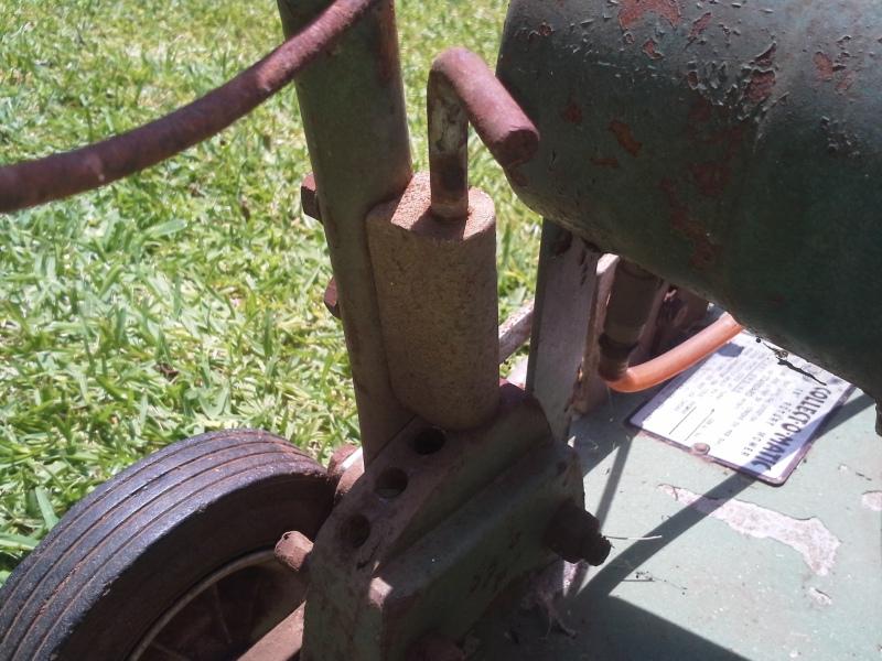

A couple of surprising and unknown features have come to light. The first was
that, not only was the height adjustable from the handle, but there were handle
height pre-sets
for operator comfort:-

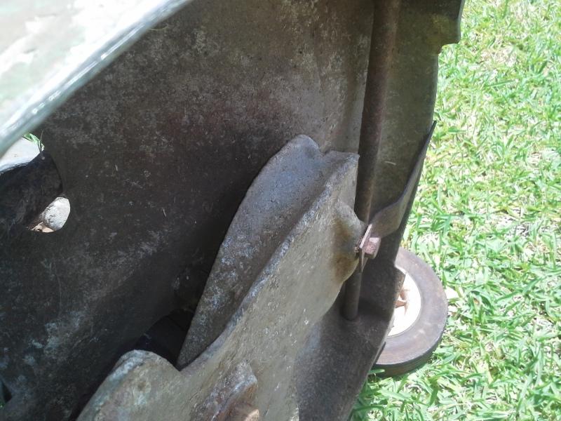

The biggest - and most important - surprise was the blade holder design.
It would appear that aerodynamic lift was achieved, not necessarily by blade
design, but by an alloy three-bladed blade holder! Like the truly revolutionary
British Rotoscythe of 1932, this mower created lift via blade holder design.
This change was probably introduced in late 1958 (best guess).
I do not believe the current blades on the machine are originals, but are
later stepped and fluted types - like Supa-swift blades. We still do not know
what the original blades would have looked like, but they probably had small
flutes as shown in the patent illustration.
