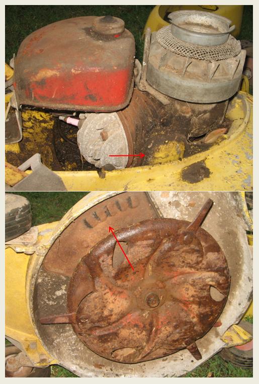

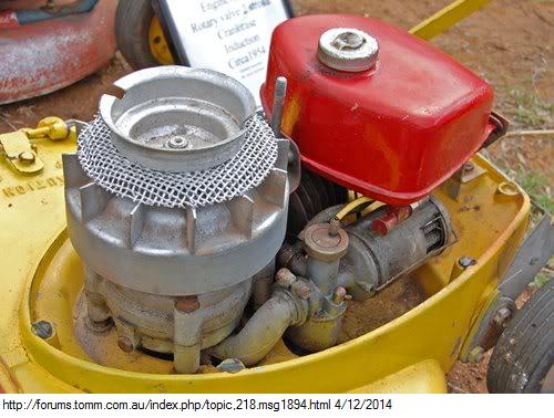

[1] Cowled Engine - 30128/57
The spiel on the aluminium engine cowling says that it 'directs a blast of cooling air over all working parts'.
This was achieved by the flywheel fan producing airflow within the enclosure. I guess the air egress was
at the rear of the cowl but I have no evidence of that.
What is clear is that this patent application design was not an enduring one.
Better engine cooling could be achieved by a more close-fitting cowl. A secondary cowl could then be
used for aesthetic purposes. Here is a The Old Machinery Magazine photograph (Eric Schulz):-

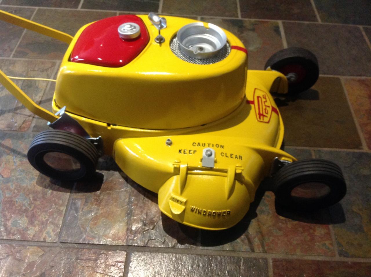

[3] Windrower - 30130/57
This is a patent feature that reveals a patent defect in this machine.
It was never designed to collect grass! It could not be equipped with a grass catcher that would
become so popular in the ensuing early years of the 1960s and then beyond.
The idea was that 'All cuttings' can be piled into a tidy windrow for easy pick up, or chopped fine
and broadcast evenly for mulch. The patent cutter disc (discussed below) and the skirted base
were clearly designed to make this an early rotary mulching mower.

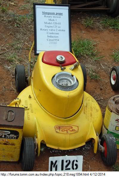

[4] Totally Enclosed Silencer - 30126/57
This was a muffler build into the mower body.
I have not been able to locate this patent for a more exact understanding. From the photographs (below)
it appears similar in concept to mufflers used on the Victa cast base rotaries of the time.
Pope did not use this idea on later rotaries. The later steel base did not lend itself to the idea,
and Pope probably found as good a solution by the fitment of a conventional muffler whose outlet was
directed down to the cutting chamber.

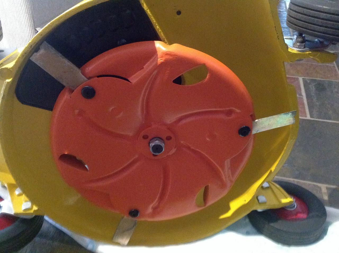

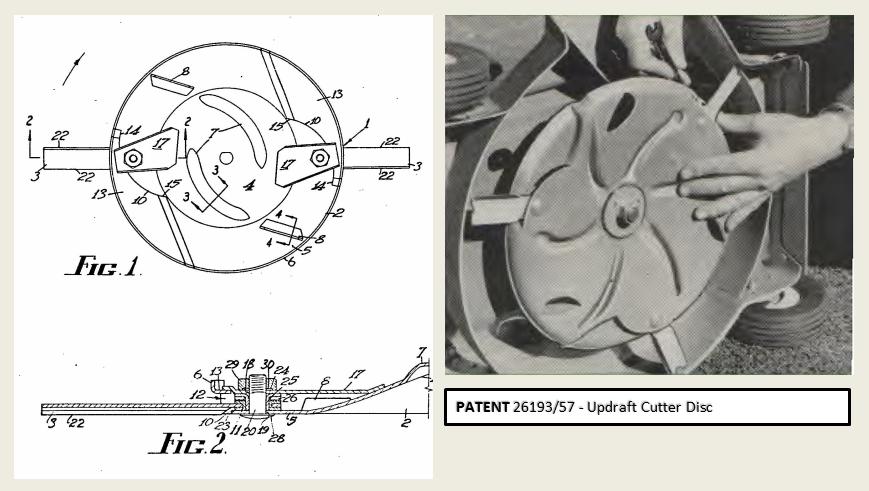

[6] Forced Up-Draught Cutter Disc - 26193/57
The Up-Draught Cutter Disc was clever and revolutionary.
It would be used on Popes throughout the 1960s and would influence blade holder designs for mulching mowers.
I have located this patent and its contents are revealing.
Pope recognised that @the majority of troubles with cutter discs, [was] the blades are attached to
the bottom surface of the disc, constituting a major projection there and consequently being highly
vulnerable to damage by heavy impact forces.@
The new blade holder was designed to improve the 'cutting action'.
A holder with in-built aerodynamic flutes would, 'increase the so-called suction effect of the blades'.
Also, the new design would shield the blade fasteners from impact damage and degradation.
The blades were 'swing-back' for engine shock protection.
A secondary purpose was to increase cooling to the engine and help clear debris from the
underside of the base.
So efficient was this cutter disc that flat reversible blades (not fluted) were used on this model,
and subsequent models fitted with large capacity grass catchers.
POPE CUTTER DISC PATENT

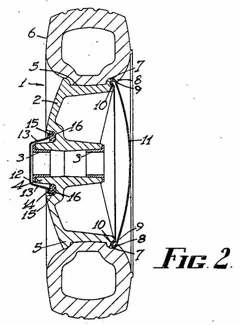

[7] Sealed Wheel Bearings - 26192/57
The wheel design and style was a clear signifier of Pope lawnmowers of the period.
Their design was a good one that passed the test of time over decades.
It was not rocket science. Pope realised that the real damage done to wheels was through abrasive dirt
ingress to the bearing surfaces. The pope design sealed the wheel from dirt and dust, on both sides,
for long life.
POPE SEALED WHEEL PATENT

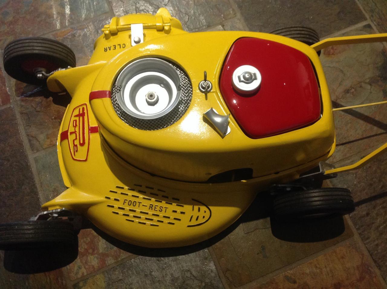

Nothing short of a magnificent full restoration was done by member
Pope on his 320-01. See the link for more details.
