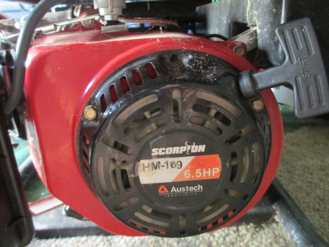

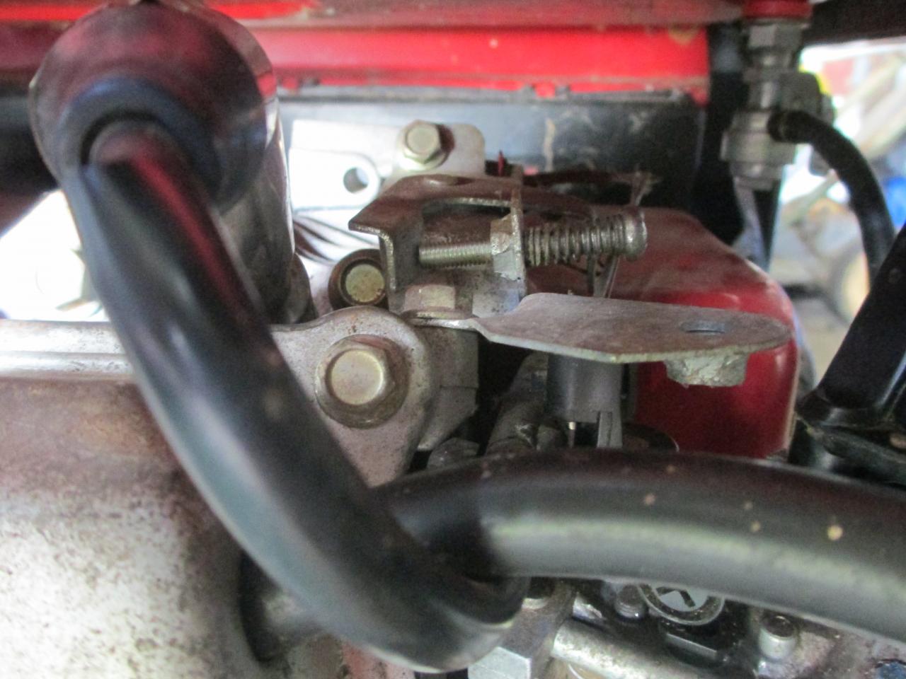

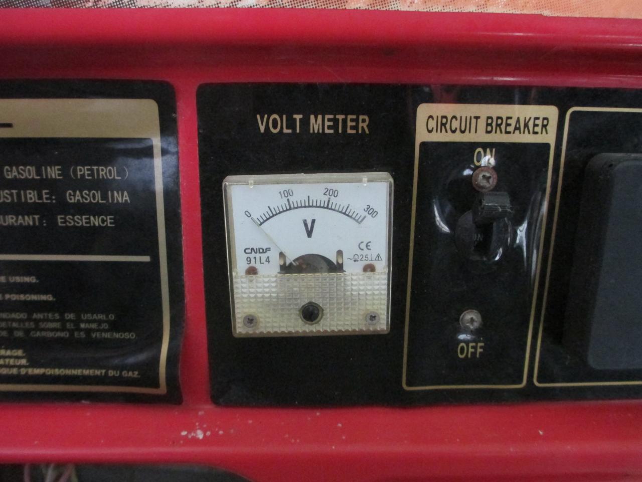

Hi, I am trying to get running a Scorpion HM-169 6.5hp generator. Things i have had to do so far is changed spark plug cleaned carby and new airfilter. Problem is it will only run for up to 20 seconds then cut out. Have double checked carby and fuel hose/tank, I am getting a constant supply of fuel. Spark is also good. The only time it will run properly is if the throttle screw is screwed all the way in (photo 1) but then it actually pumps out to much power, it will hit 300 volts (photo 2). Photos not showing what i explained as i have readjusted them.Everything looks right, just cant put my finger on the problem. No doubt it is right under my nose. Any help or advice appriciated. Paul. [Linked Image]

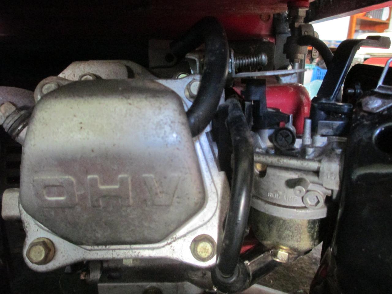

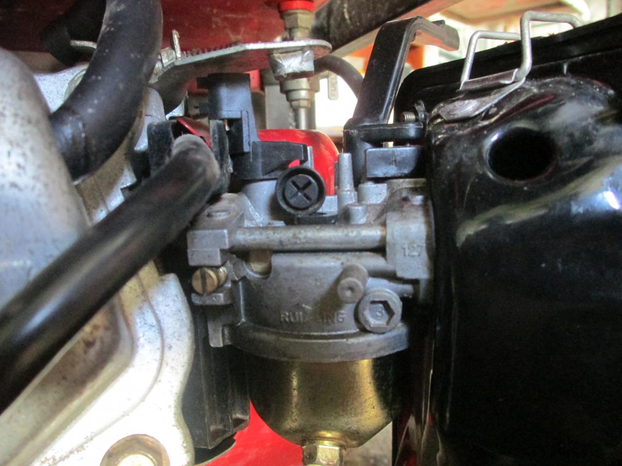

Hi Paul. Let's start with clear identification of what we are working on. Because it is alleged to be 6.5 hp, I'm guessing the engine will be a chonda version of either the GX160 or the GX200, but we need some pictures, especially of the carburetor and rocker cover, plus various bits of cylinder and crankcase that we might be able to recognise. We also need supporting information, such as any numbers cast into or stamped onto the cylinder casting. Then we need some more detail on the exact symptoms. When it starts to falter, does it recover if you partly close the choke? Can we see a picture of the spark plug, so we can see the colour of the side electrode?

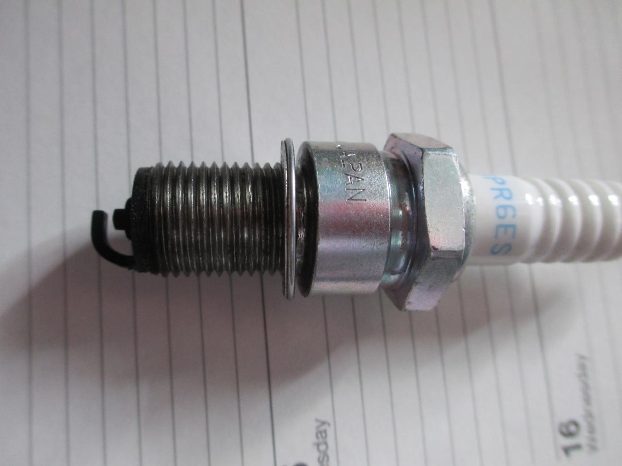

Hi Grumpy, there is no exact time it will cut out, sometimes it will run for approx 5 seconds other times i have counted to approx 25 seconds. It doesnt matter if partially close off the choke, I have even tried to gently hold governor open to half throttle, it will cut out.I even tried force feeding some fuel from a babys panadol syringe as soon as it started to cut out, didnt work. Each time it stops I take the spark plug out , its usually a bit black (as in photo ) give it a clean, have tried tweeking mixture screw on side of carby, have had it out to 2&1/4 turns,just to try, same thing, cuts out. It should be set on 1&1/2 turns shouldnt it, correct if wrong please.

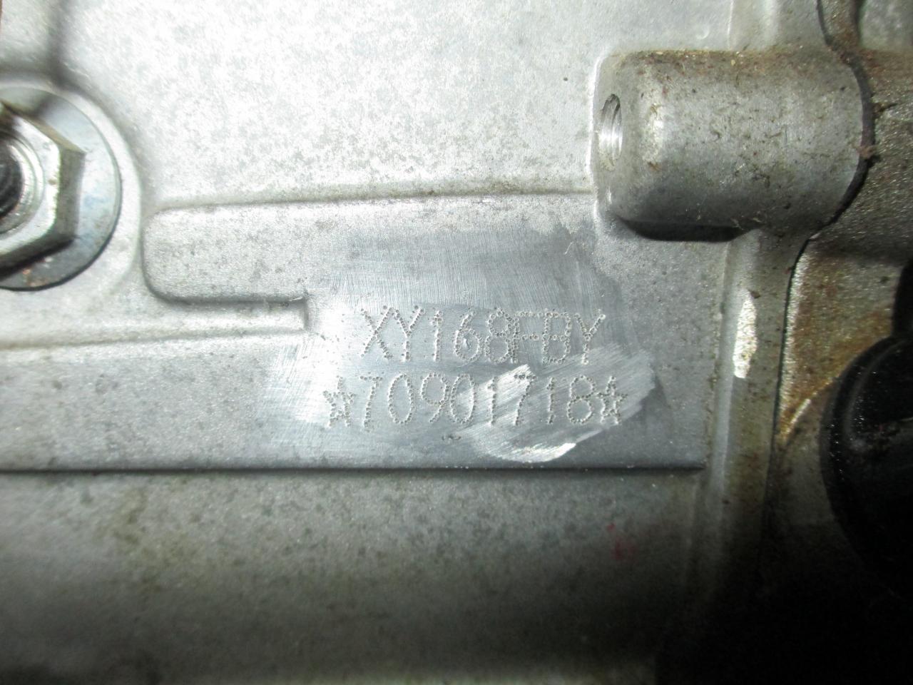

The numbers on side casing are XY168FBY *7090718*, incase my photos arent clear enough. The spark plug is a BPR6ES. Let me know if more photos are needed. [Linked Image]
OK, it's a chonda with a Ruixing carburetor. I'm not really familiar with the GX200, but that is Honda's 6.5 hp engine, so I'd guess that's what it is copied from. Hopefully someone will confirm this for us. It doesn't look like a GX160, which is only 5.5 hp in any case.
Because the plug is black, indicating rich running, and applying the choke doesn't help, I don't think a carburetor or fuel supply fault is the most likely cause of this problem. I suggest you start off by looking for an ignition fault, and move from there to an internal engine fault if necessary. That means finding a way to check for spark. How long is it after it flames out, before you can restart it? If it restarts immediately, we are going to have to use an in-line spark tester to check the ignition system, but if it takes a minute or more to recover after flame-out, you can quickly remove the spark plug, then do a spark test, immediately after it stops.
