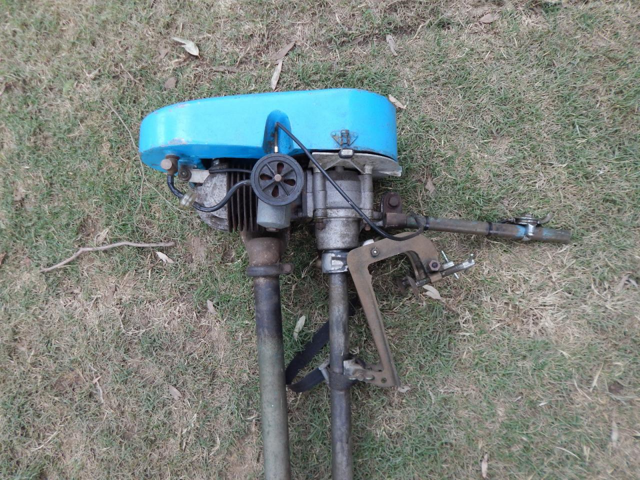

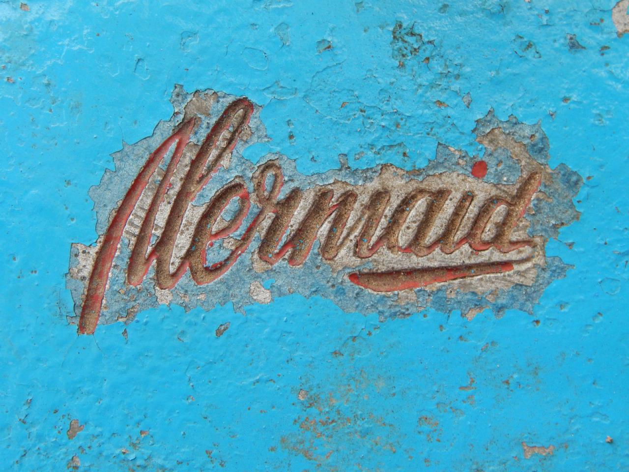

Folks, I just thought these pinched pics, from a recent completed FleaBay auction [seller claimed 1955 model] should be preserved, of what is undoubtedly a very rare beastie:
Hi Gadge, and many thanks for posting. grin

Who stole images of my Mermaid?...lols
Naaaa Mines prettier...

Was gonna grab this as its an accurate tidy original.

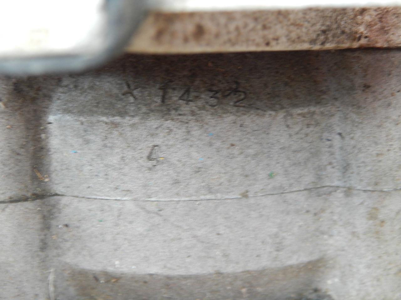

Note the correct X engine coding. Claim of 55 is hard to verify,but the engine did exist in this year for mowers,but im certain industrial and marine came after.
I dont recall if the ebay ad showed if the engine was stamped with Victa"
1956-7 Would be a more accurate date,but 55 may be a possibility especially if the engine was unnamed...
Oh well another goody got away,add that to 2 Rotos I also missed cause of my lame memory...sighs*
