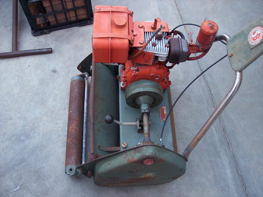

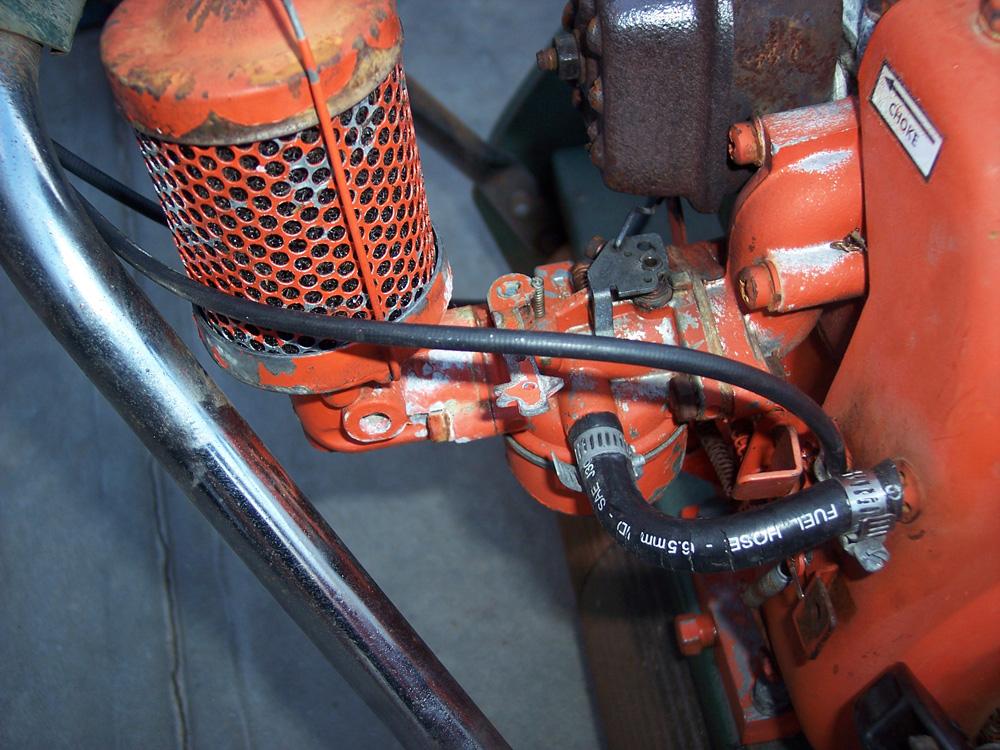

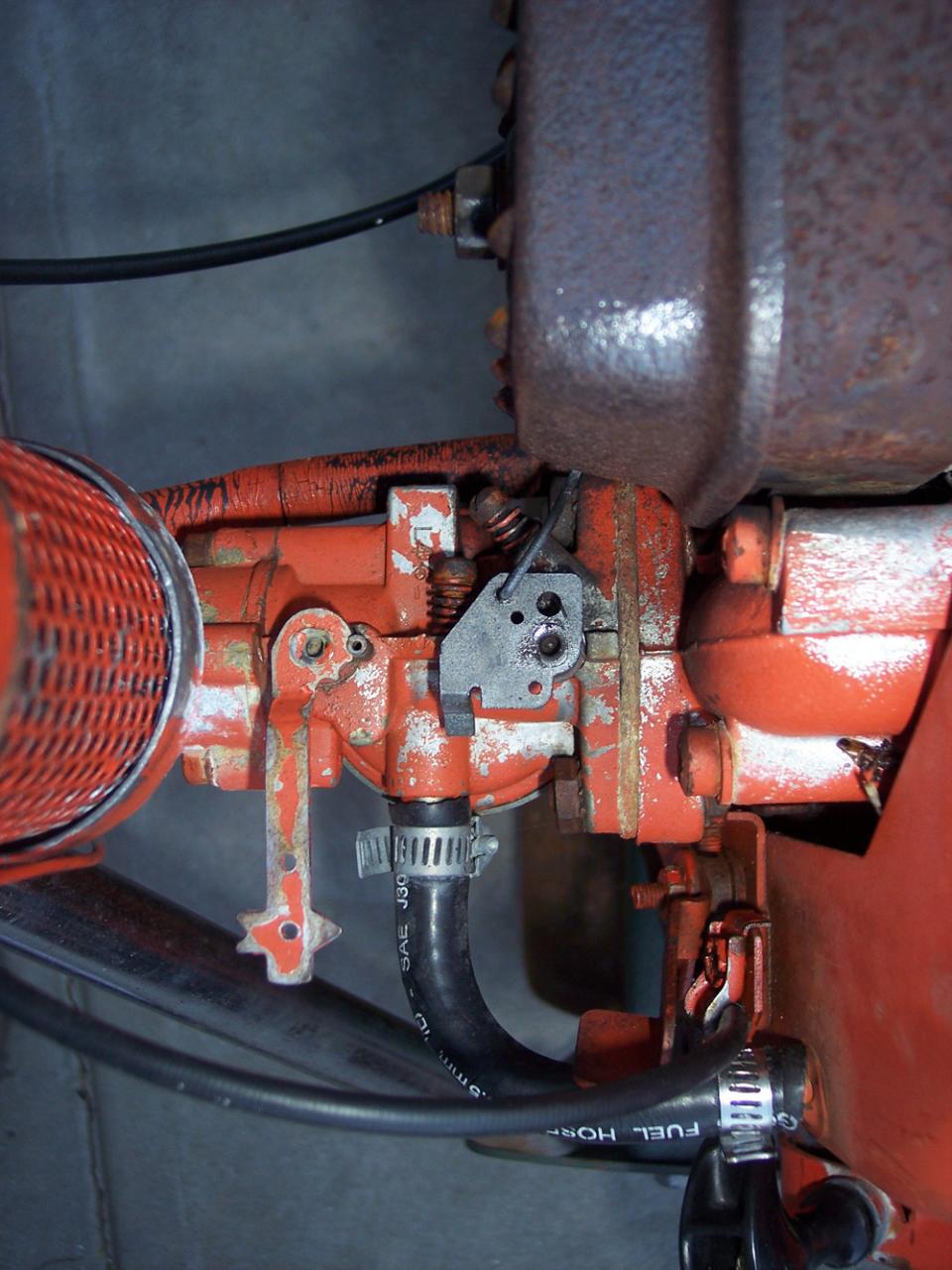

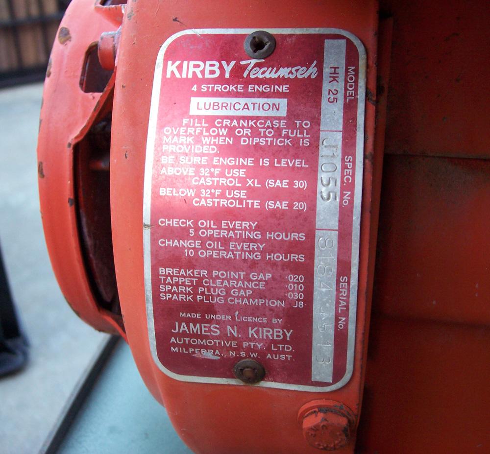

Here are the photos of the early Scotty I was given, it is basically identical to deviosi machine complete with chaffered reel blades and 2.5 HP Kirby motor and Large fuel tank.
Just added these prior to resolving the hunting issues that I have with this Kirby and as we are currently being doused with rain I thought I'd take the opportunity to do this
The mower number is 45 - 01208 which in essence makes it the one thousand, two hundred and eighth model 45 off the line at Thebarton opposed to deviosi's 867th machine off the line as featured in "the Most Popular Topics", thus why they are basically identical machines with the same specifications. I must admit that there aren't that many really good survivors from that era that won't require that much work to bring them back to their original glory.
