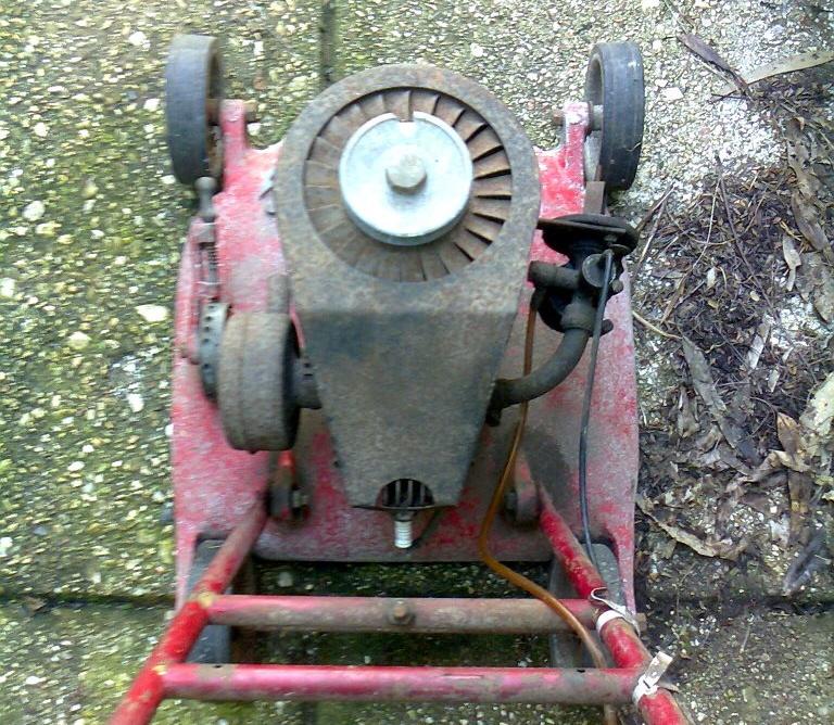

Here is a photo of what I think is the first model Lawn King:-
Note that the petrol tank is missing but would have been handle-mounted (1955 advertisement).
The fan and cowl are tinware and do not appear in any Villiers manuals for the Midget that I have found.

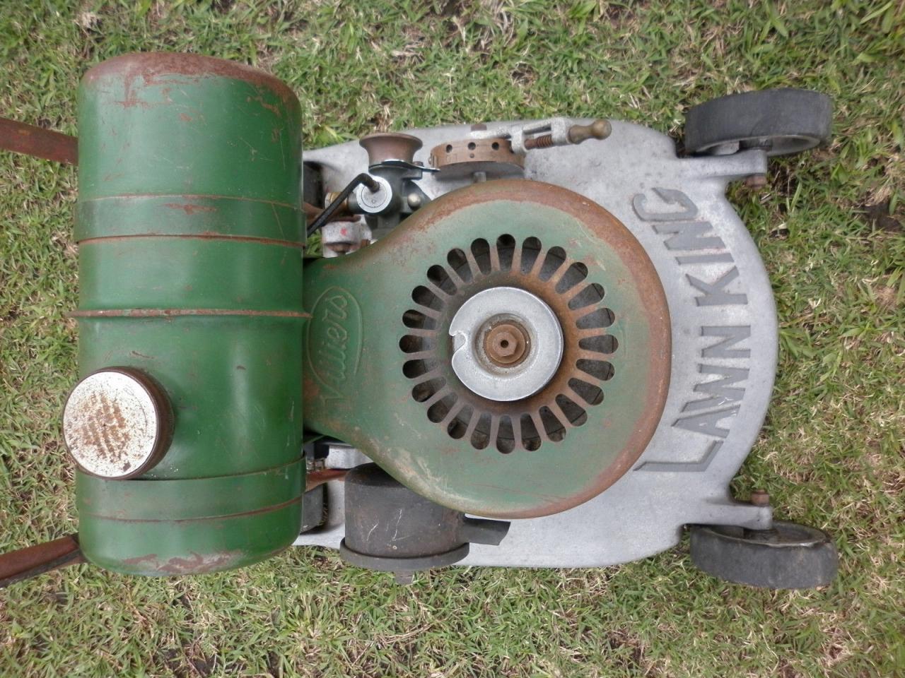

The newer model, displayed in the 1956 advertisement has the Villiers
cowling and engine-mounted fuel tank:-
