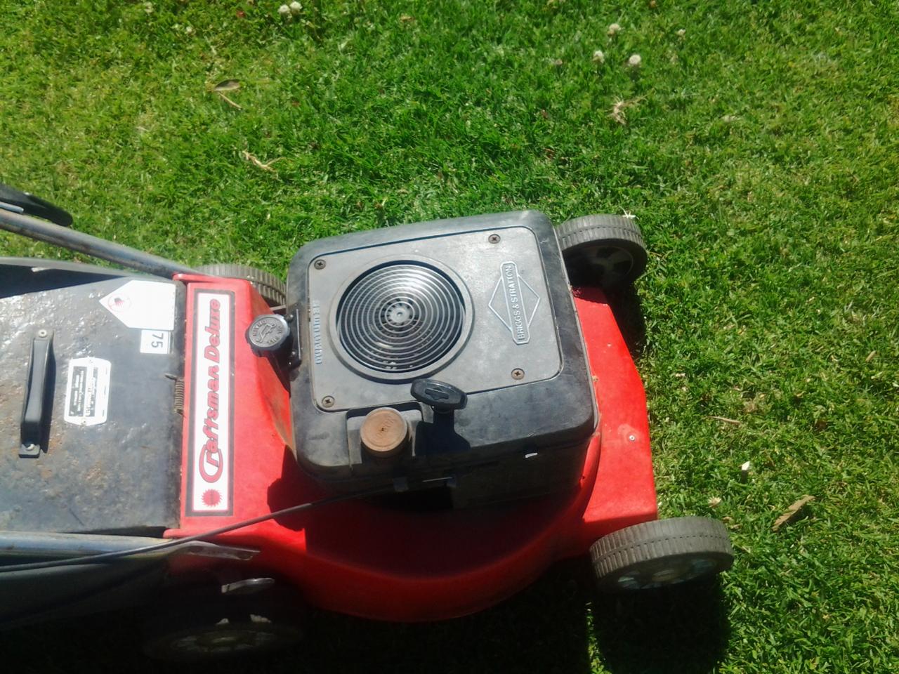

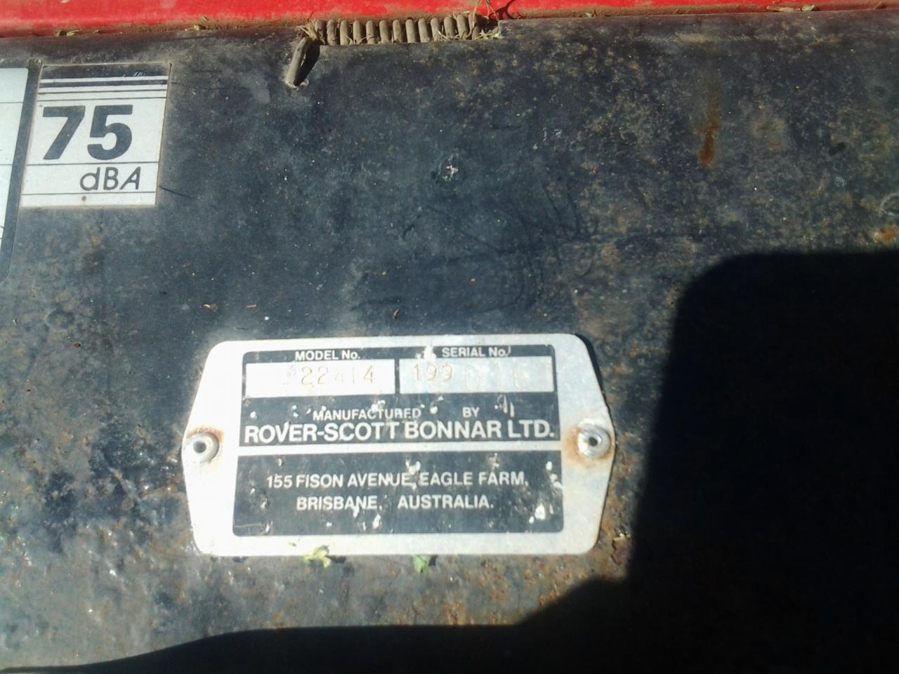

Can anyone give me some background on this mower? The B&S number is 100708 0129 01 88061325. I know the numbers are telling me the engine is manufactured in 1988, but does the engine belong on the frame?
Picked it up for $40 and it goes like a dream. Blew a little white smoke but that seemed to disappear when I ran it for a little while. No visible oil leaks. I don't think the fuel cap is original, looks like something off an old petrol tin. Only visible rust is on the flap that holds the catcher on.
I was just gonna clean it up and sell it on.
Yep, that looks original I'd say. You're correct about the fuel cap; the original would have been plastic.
'Craftsman' was an MSAA [Mower Specialist Association of Australia] 'house brand' here for 40 years or so [in the US it's a Sears/Sears Roebuck mailorder brand]. All of the major local mower manufacturers made 'store brand' mowers for them AFAIK.
I'd tend towards giving it a full service [cowlings off and clean out the cooling fins; empty and clean fuel tank and carby bowl; air filter and oil change; blades, bolts and spark plug replacement] before selling it on. A little time, but not much in parts, and much less chance of a comeback.
Posts: 961
As Gadge said, totally original, it's a nice model craftsman with the ball bearing wheels, 1 piece U shaped lower handle bar and the big 3.5hp quantum. They generally are a really smooth running engine and have a nice sturdy rigid frame. Overall a very tidy unit and should make a reasonable profit from you $40 investment.
