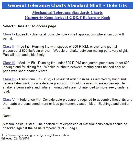

Here we have the dilemma, was the bearing surface designed to be a 'push fit' or a 'sliding fit'.
Grumpy has suggested it is actually what is called a 'transitional fit'.
Obviously this was a design issue at the factory, and the bearing area was made so as the bearings could be put on and removed from the shaft by hand....removing the need for a bearing puller; which can only grab the outer ring of the bearing, resulting in brinelling of the bearing surfaces. wink

Grumpy - ODK's resident engineer and Global Moderator - has narrowed this to
explain my experience as an apprentice. The original specification must have
been for a transitional fit:-

Note: I guess it goes without saying that the lateral movement of the reel
is caused by loose bearing fit. The other possibility is that the bearing itself
is sliding within its alloy housing. That would be a simple fix as well.

I'm starting to think that the original fitment was a firm slide on and not an actual interference press fit.
You'll probably find that most machinists would want the reel to sit very firmly on the inner race so as to get a very accurate result from their centrifugal grinders.
Once you have the slightest bit of movement, this will only accelerate the wear factor. I personally prefer a very firm contact with the inner race as this then allows a very fine and precise adjustment of the reel to the bed knife.
