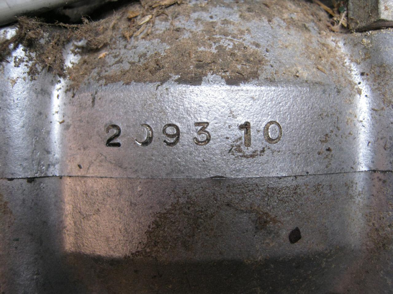

How do I post photos? I'm not great with computers. One engine has the number 209310 and the other has the number AC 65544. I have one of the large round low mounted air filter assemblies with a rotary switch. Which engine would go with that air filter assembly? Cheers, Brad.

Hey brad,
Model 5 S2....Filter goes with the AC mate, just get them pics up so we can make sure the engine and filter you refer to are correctly mated to the right base. ...:)

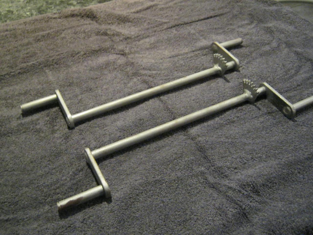

OK, here goes. Thanks for the help guys. I have also included a couple of photos of new axles I made for the Victa 18's. They are all new but I re used the segment gears. Cheers. [Linked Image]

Correct me if im wrong mal but is thw 1st photo a model 5 series 2

nice work on the axles they look a treat, I agree with Blue as that air cleaner/choke goes with the later AC engine and would suit a base without a edger groove or base with an edger groove but without the front or rear axle extentions, so either model 5 series 2 or series 3, the 209K engine I would estamate to be a series 1 and would sit on a base with the front and rear axle extentions and edger groove, as for paint, also as Blue has said each to their own, I had some Dulux tint SS27 in galmet gunmetal hammertone mixed up and once compaired to some original paint I ended up trying to get it matched to the original but it ended up being a bit to yellow looking so I used it to paint my Lathe lol, so start again and can get expensive at $45 a litre, also as mentioned the shades were a darker shade on the early ones, would be good to see some more pics of your other stuff as there are suttle differences in other things as well. cheers.
Great axle reman Aus:). The first engine photo Cj? That is a model 5 series 1 serial, base with edger groove and axle housing overhang, exactly as Jonesy has stated. (Let me know if your unsure about the serial runs CJ as im happy to clarify:). The second image is a model 5 S2,edger groove with no axle housing overhang. The AC stamping is of the early style so its a bit too early for a model 5S3.
