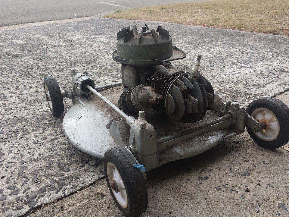

the 1st few pics are how i got the mower and from advice from Mal it turned out to be a miss match model 4 motor and model 5 base but Mal had a spare base that i got off him (the photos are in the model 4 auto forum) and this is how it has come up so far

After a media blast with aluminium oxide and a quick polish

Got some good and bad news regarding this build bad news is the bore has already been bored out to .060 thou and finding .080 thou piston and rings are hard to come by but I have found a top end that has been bored out to .020 thou and hasnt been fitted to a motor since and also new piston and rings to match and a head that is in good condition as mine has 2 cracked fins and at a good price as well
MrCJ #56196 04/06/14 08:51 AM
Cool..good score mate,problem solved. You know time and time again I hear of others stripping an engine to find it O/S which naturally would be the case after 50 years. The odd thing is though out of the last 50 rotos and specials ive stripped only 2 have been OS roto at 30 thou And a special at 40...what are the odds....made my life easier as ive never had to source another barrel.
