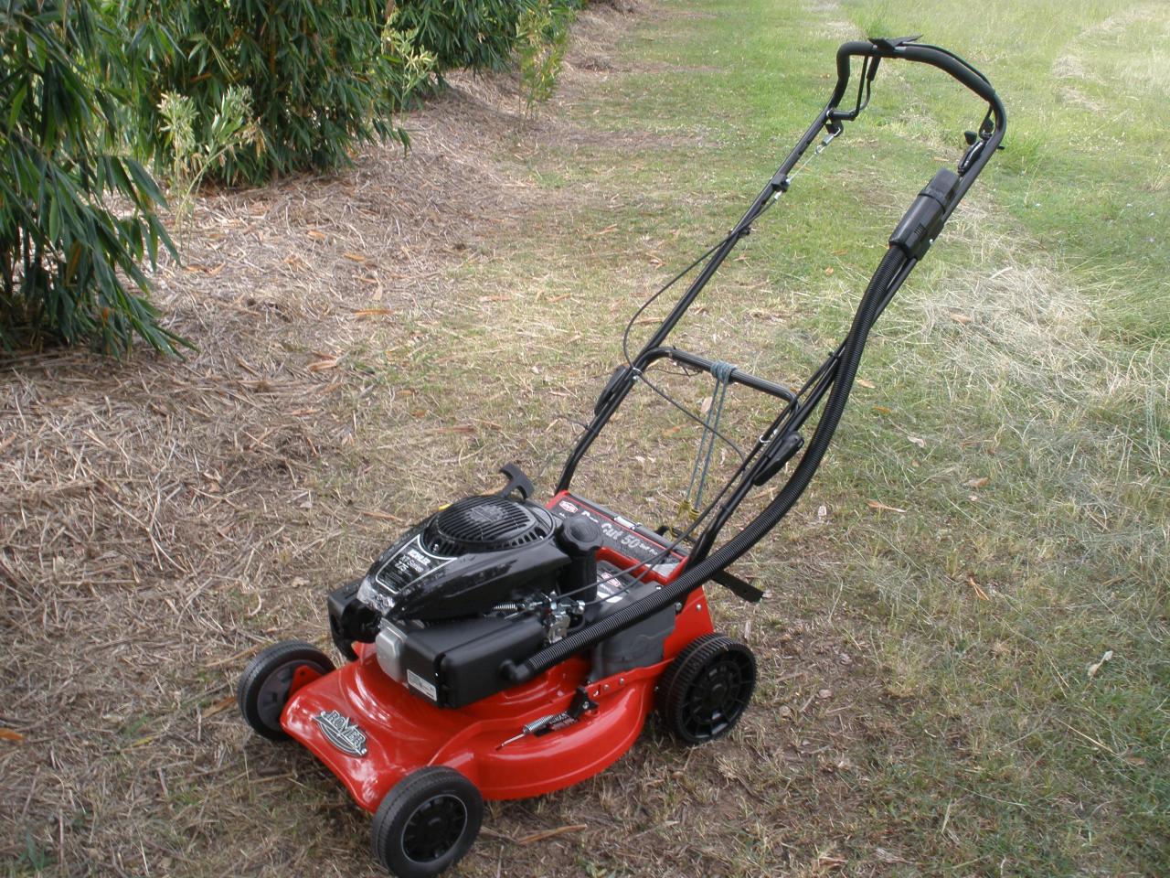

Bushie #56649 24/06/14 06:45 PM
Joined: Mar 2014
Posts: 99
Here are a couple of photo's of the Rover.
Still hadn't trimmed the cable ties on the cable for the hour/tach meter.
Have fitted a metal full tap.
The engine is now called XT 7.75 to confirm with the new regulations.
Hate the cheap and nasty push on clips to hold the wheels on, especially the rears which need to be removed fairly often to service properly.
Does anyone have some idea of a better way to secure them?
I have drilled a hole and put in a split pin and washer on one, but think this might be a bit weak over time.
Cheers.
