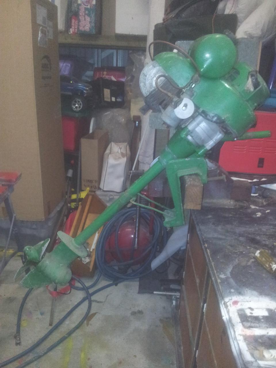

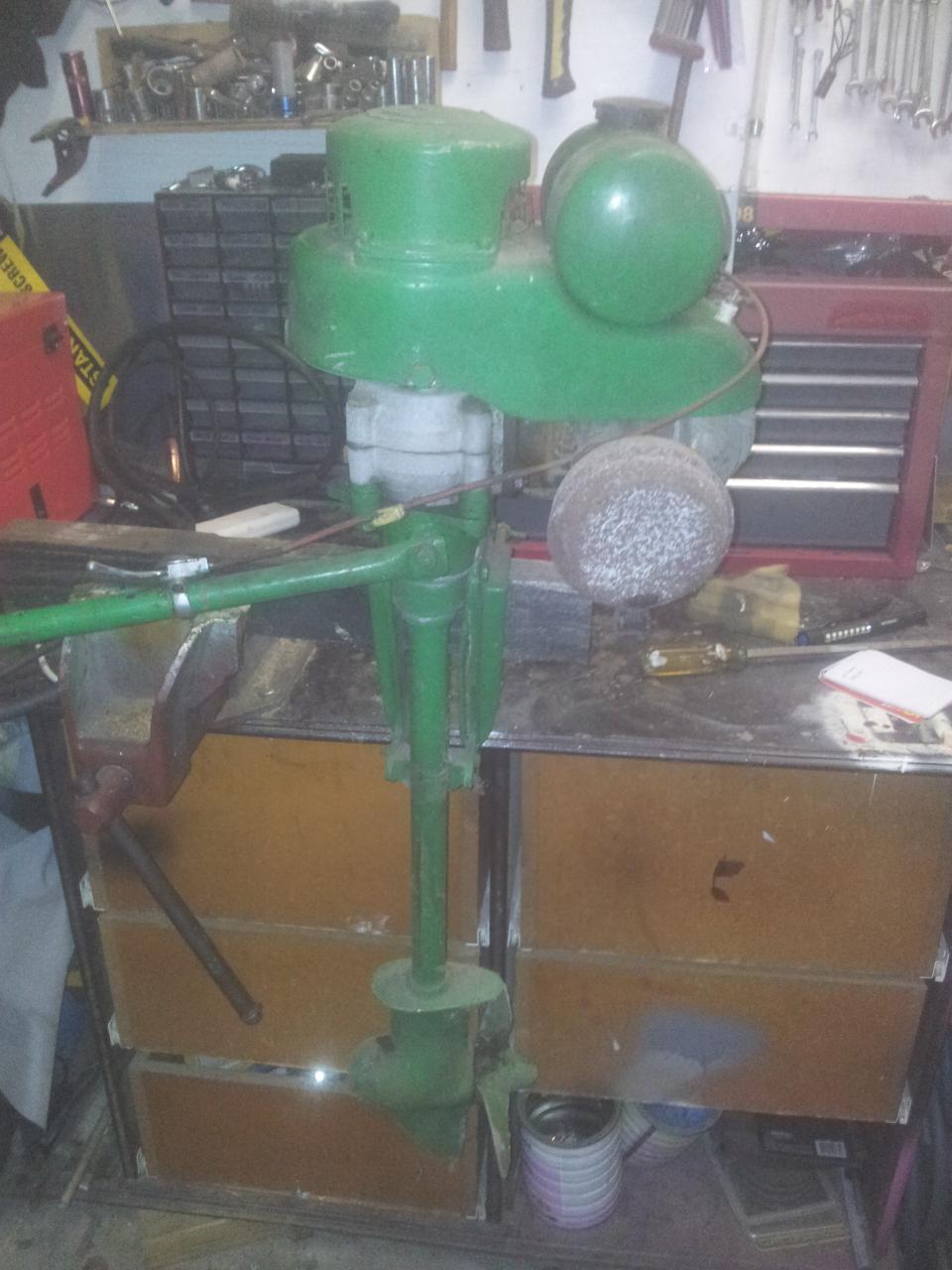

I am new to the site so I thought I would add photos & numbers of my collection
Outboard no.304281, mower 1,1AAA4220. mower 2,222442. Thanks[Linked Image]

Nice collection you have there fuggins....The restored Rover looks very nice Ive not seen one like that before is it a two stroke?...
And yeah your in the right place for people suffering from MAD (Mower Addiction Disorder) lol....Cheers Chris

Yes nice Rover,running a Villiers Torque master,seemingly an Auto with a Victa impulse starter. Never seen that starter on this engine,seems to have an adaptor plate underneath. I like the date coding on the rover badge too. Very interesting example fuggins. Loving the Marine,will restore up beautifully. 2 model 5s as well cool! Serials seem ok just switch the engines from one to the other if you want as they will be more accurate if your after originality. Thanks for the inages mate,nice lil collection you have:)

Yes Fuggins thats how it all starts lol, you have got a few good ones there to keep you busy, the outboard is the same as mine Here only mine has the gear selector between leg and engine, :welcome: to ODK.
