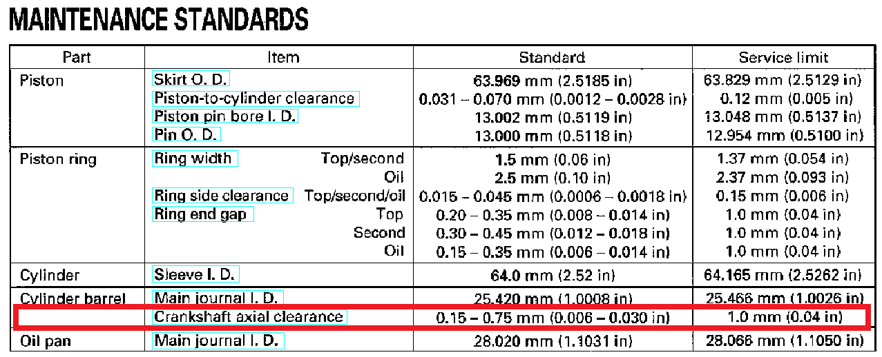

I still can't see your video but I can hear it now, and the sound is much the same as I've heard from multiple Hondas, but the actual movement is what matters rather than the sound. Honda has set a limit for the clearance, which I have outlined in red:
So, it sounds as if you need to make a more precise test to establish whether yours is within the service limit.

I don't get an image from either of your videos. If the crankshaft endfloat is over 1 mm, it means the engine is defective. The crankpin is only 1.1 mm wider than the connecting rod, so the crankshaft is moving far enough to cause the connecting rod to be pulled too far sideways, which could cause a variety of bad things to happen to the rod and piston. It can't happen due to the crankshaft being bent, though it could happen if the crankshaft has been compressed axially in a press. I'd say it is either wear or defective parts, unless the engine has been damaged in an unusual way.
