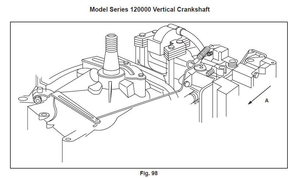

Here is the illustration from the workshop manual showing your governor:
It looks to me as if your governor spring is missing.

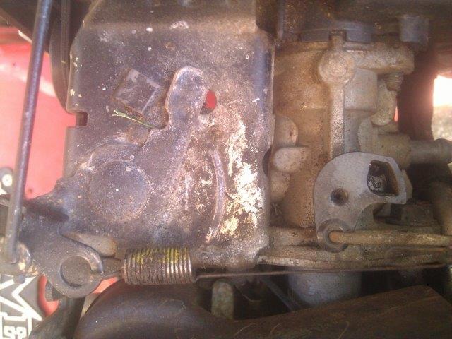

the spring is there, you can just see the straight part(209), so when you pull on the throttle it all moves forward, its when you return it that they don't move back, what makes it return back?

i have include 3 photos, one with closed then full,
then returned where the spring is back to its position but the butterfly remains the same .
if the crank is used to return then that explains why it doesnt go back,

My main concern with the governor set-up is that the mechanical governor can only pull the throttle toward closed, it can't push it toward open. The only force that opens the throttle comes from the governor spring. In the first picture the throttle butterfly is completely closed to the point where it hits the idle speed adjusting screw if it has one. In this case it does not seem to have one, but neither does it have the alternative: a small second governor spring to control the idle speed. Briggs calls that "governed idle", and if you look at Figure 98 from the manual which I posted in this thread, you will see that your engine would normally have this second spring. The second spring holds the throttle slightly open unless the governor pushes it further toward closed.
When the speed control is set to maximum, the main governor spring should be slightly stretched. If it isn't stretched at all, it may be the wrong spring, or the speed control lever may not be moving as far as it should toward high speed. I'm not sure at this point whether it is stretched in your second picture.
We need to see it from a bit further away, so that the speed control lever is visible, to the right of those pictures, where the Bowden cable attaches to it. Let's also see the whole spring and both of the attachments at its ends, so we can be sure whether the controlled idle speed spring is missing.

the spring is slightly stretched, as you should be able to see in these photos, and when it returns there is nothing to pull it back so the spring has slack [Linked Image]
At this point I don't understand how your engine can idle without either an adjustable idle speed screw, or a second governor spring such as the one shown in Figure 98. However that will not be the reason it won't start, so let's disregard it for now.

As I read Figure 98, your engine should have a shorter, second spring running from a fixed point on the engine to the throttle butterfly. That would ensure the throttle is partly open when the engine is stopped, and more importantly it would control the idle speed and keep the engine from stalling at idle.

I'll go through my reasons for thinking there may be a missing governor spring.
First, let's look at your carburetor. Here is what the workshop manual says about it:
In the first illustration, you'll see that your engine has a Walbro LMS carburetor. You'll also see that the specific version that has a fixed main jet with dry bulb primer (which yours has) is illustrated in Figure 97. If you look at Figure 97, you'll see that Item 2 is the idle speed adjustment screw. Your engine is later than the workshop manual's publication date, and it does not have either an idle speed adjustment screw, or an idle mixture adjustment. So how is the idle speed controlled? The only alternative to an adjustable stop on the throttle butterfly bell crank, is governed idle. Governed idle uses a second governor spring that operates only at idle. The illustration for your engine in the same workshop manual shows it having governed idle: see the second governor spring in the red circle:
As you can see, the governed idle spring runs from the throttle butterfly bell crank at one end. You cannot see the anchor point for the other end, but it will be a thin pressed steel bracket mounted on the engine's cylinder block. The idle speed is adjusted by bending this bracket.

Thanks Joe, it looks as if there may have been a fair amount of trial and error in the design. The parts list does not show an idle spring, but the workshop manual does, so it seems like something odd has happened along the way to the Briggs design process. If it will idle without the spring, it is obviously not anything to worry about. That may have been the line of thinking that Briggs adopted.
In any case it is clearly not the problem in this engine: the governor spring opens the throttle when the speed control is in the start (maximum speed) position, and that is all we are concerned about at the moment. I'm a bit mystified by what seem to be conflicting reports, though. When ether is sprayed into the carburetor intake, it starts. When petrol is squirted into the same place by the primer, it doesn't. That outcome appears to be impossible, so there is most likely some other factor here we don't know about yet.
