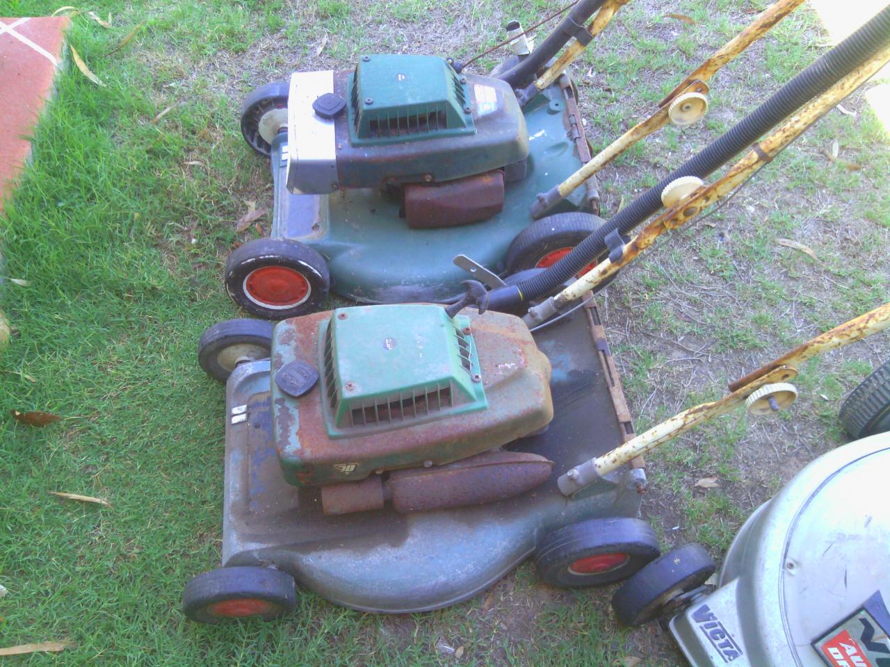

Hi all, is this muffler original, I'm sure I seen this before it also has a white petrol tank and white fuel tap. Made for chandlers I think. Model no,83 7201131. [Linked Image]

Hey ! Im thinking that that muffler is somewhat older than that mower that style would normally be found on early 60's corvettes and things .
i think the fish tail style torpedo would be more likely original, although plastic tank cowls used to have through base mufflers.

Ok she's a bitza mate, when I get some time I'm going to see how well the silencer works, I think older 2 strokes have got a sound of their own , so it will be interesting if it makes a difference. Thanks Tomo4192.
roebuck #53747 18/02/14 08:51 AM
1972 Series 70MKII engine, on a low arc stencil base, most likely a storebrand mower.
Not all that much of a Bitsa, although the muffler is definatly older. G3 carby fits the timeleine, and the cowling and base combination seems fine, and fits with the engine date... Now...let's have a look at the books...
roebuck #53748 18/02/14 08:56 AM
OK, looking at the books, I'm thinking it's the 1972-1973 Storebrand Premier, The pic looks like a 160cc engine to me.
The Muffler looks like a 1963-64 Corvette muffler, as for which muffler would have been original, I'm guessing Box Type, and the books agree, but the definitive answer would be found looking under the current muffler for a rectangular hole in the base for the box muffler exhaust to go down to the blades.

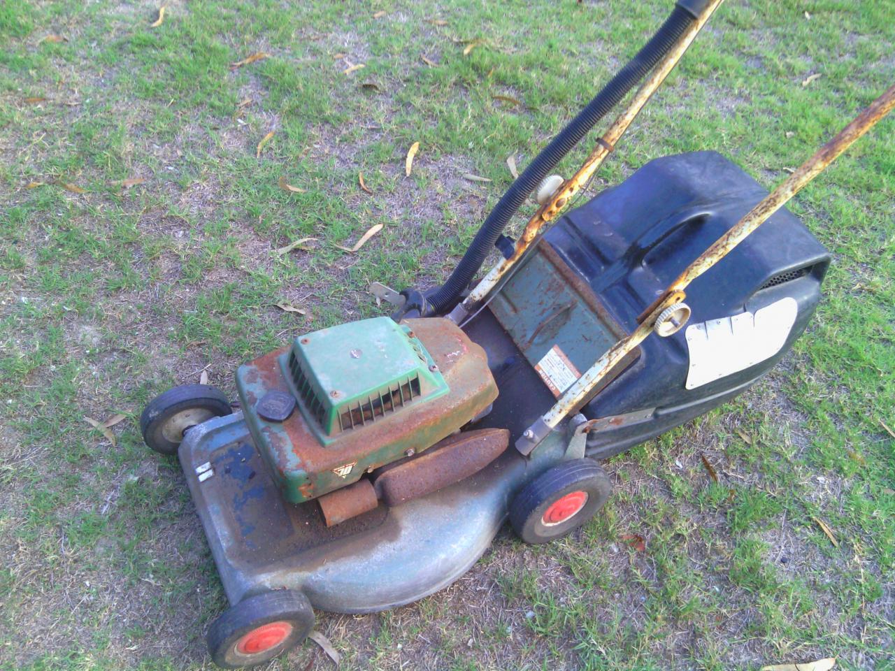

Hi, I have another one close to this ,I'll drag it out tmrw and take a photo and some more info, thankyou.

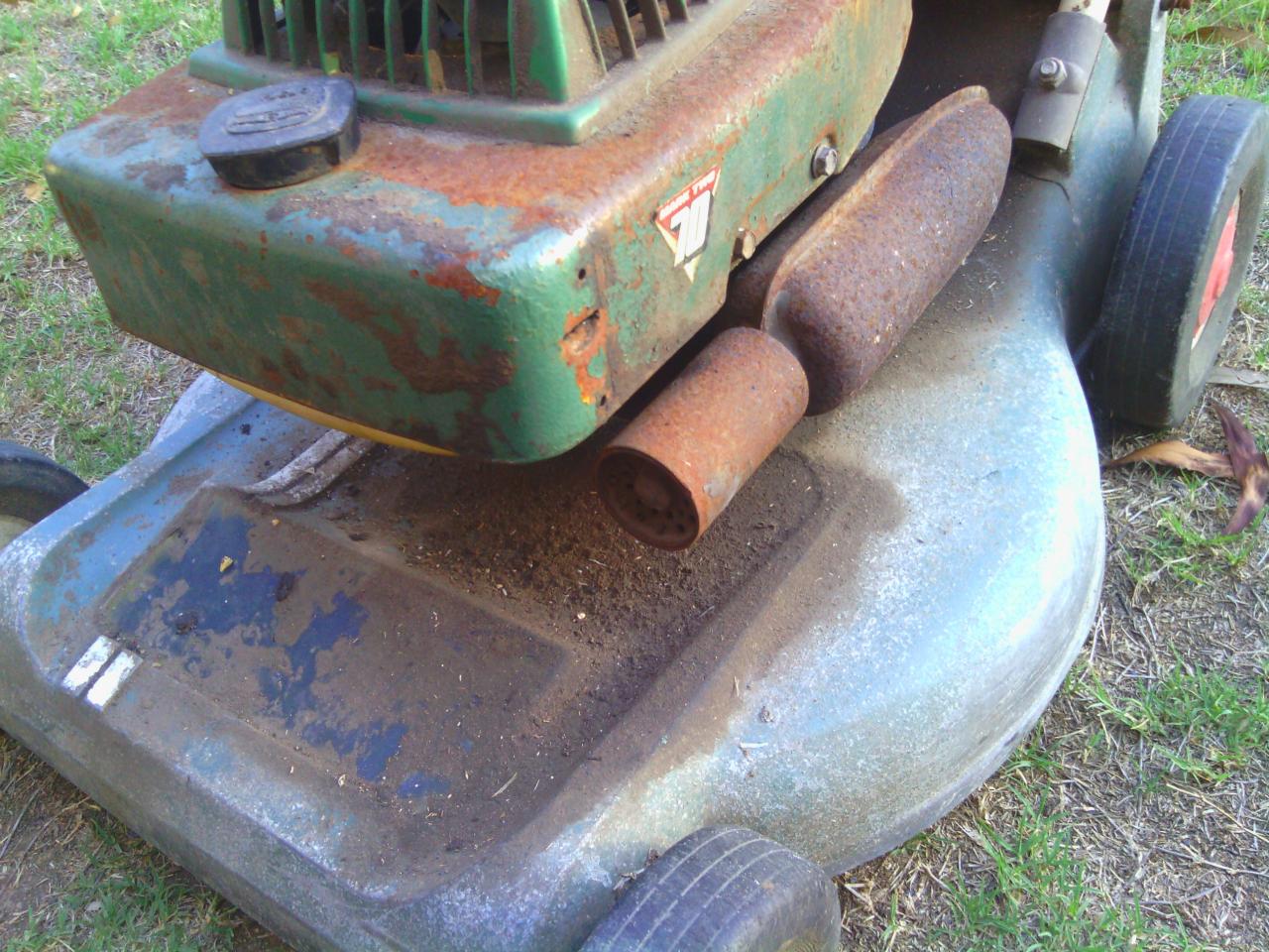

roebuck #53762 18/02/14 08:40 PM
Joined: Apr 2013
Posts: 336
It does have a spot in the base where the original muffler would go , thankyou. [Linked Image]

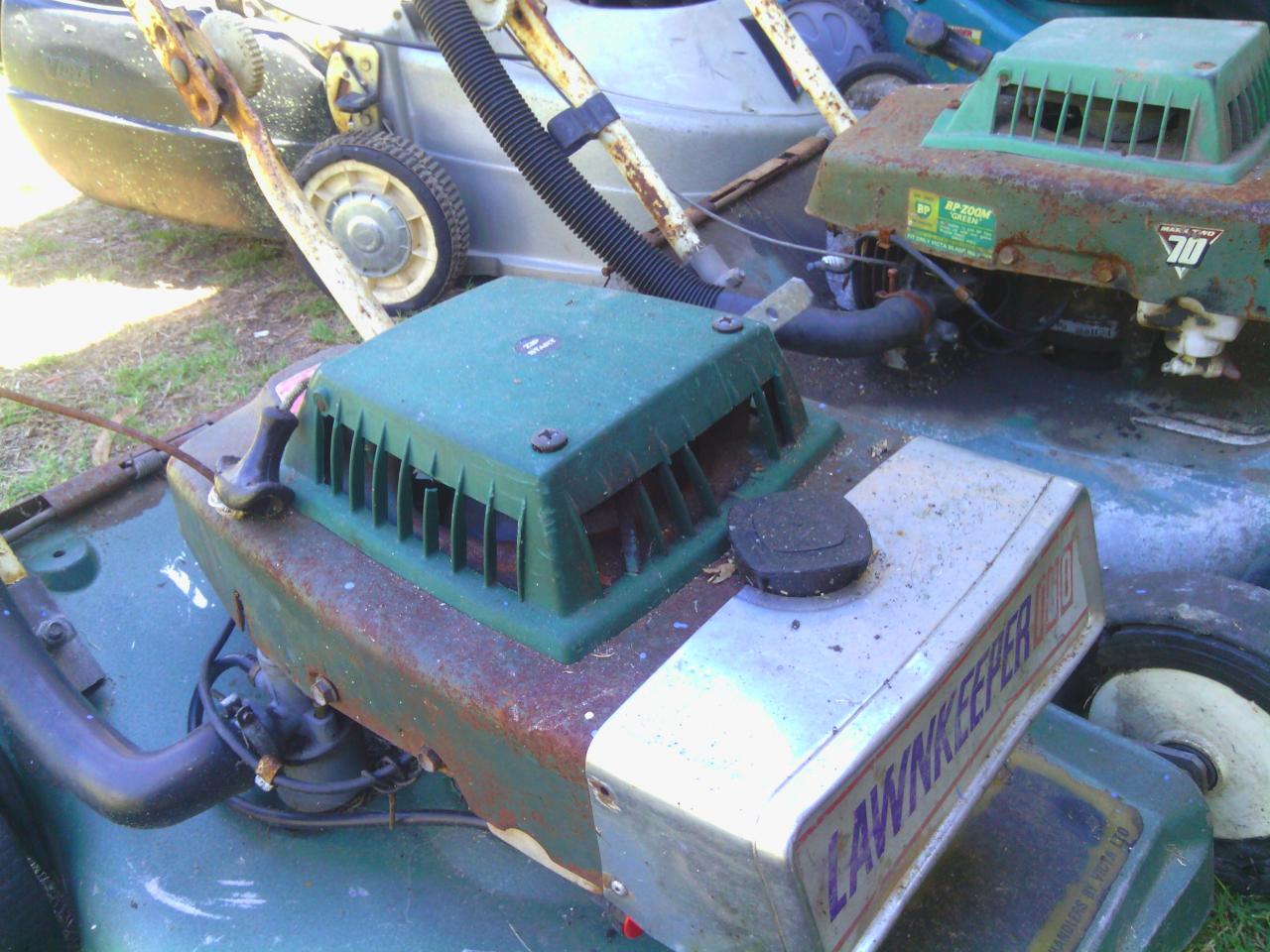

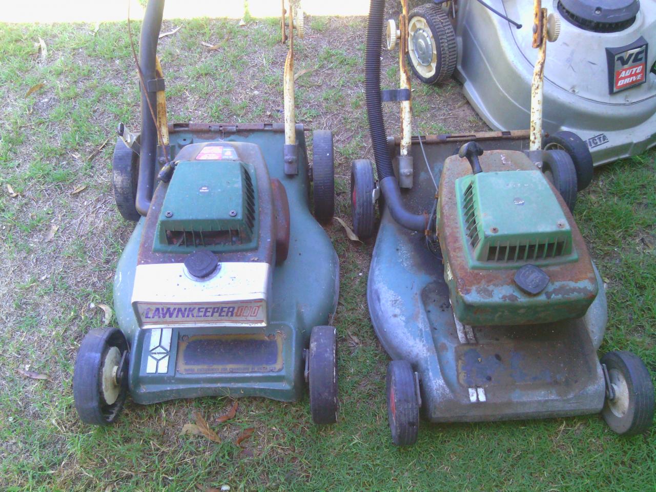

Two different carby's [Linked Image]
roebuck #53814 21/02/14 04:19 AM
Hmmm... what's that ones serial? it might be 1968-1970, or the carby could be a mismatch...
roebuck #53816 21/02/14 06:08 AM
Joined: May 2012
Posts: 467
defiantly a miss match Ty , it appears to be a 160CC with a 3L carby no decompressor hump in cowl in photo 2.
roebuck #53819 21/02/14 06:54 AM
There is still a chance it is original, the very late 60's saw the 160cc engine with the 3S carby, which was the same as the 3l with different jetting.
roebuck #53820 21/02/14 08:17 AM
Joined: May 2012
Posts: 467
Yes this is true although I've never seen any. also you can see a kill swich wire
hanging off next to the carb would suggest not original or an engine swap ?
roebuck #53823 21/02/14 09:24 AM
You are indeed right... infact a G4 kill wire... Maybe we need to look more towards 74 onwards for this one...
