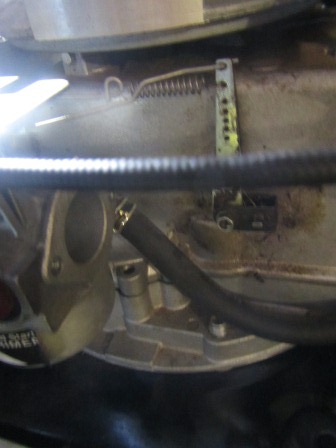

I got this mower as a trade on another mower as the previous owner got the sh*ts with it and went back to a trusty 2 stroke. He is happy now so that�s all that matters. I have seen Tecumseh�s before around the scrap yard however most of them were well past their use by date and not worth while trying to repair. This one is different. I�m sorry I couldn�t find any model numbers for the archives but I have included some pictures of the carburettor set up. The mower would only kick over with a little fuel down the spark plug hole so I proceeded to do a carby clean. After a good clean and re-assembly and managed to get the mower going reasonably well but it�s really only going half speed at the very highest rpm. The mower starts first pull now, doesn�t smoke and runs very smooth. My question is in relation to adjusting the engine speed, if this is in fact possible as I don�t want to stuff it up as the mower has done very little work or could the low speed be due to another common issue with these engines. I have included some photos of the carburettor and linkage set-up to assist. I am hoping the RPM adjustment is easy like the Briggs Engines! Thanks Guys. ![[Linked Image]](https://www.outdoorking-forum.com.au/forum/uploads/usergals/2014/01/full-6412-14489-img_0420.jpg) ![[Linked Image]](https://www.outdoorking-forum.com.au/forum/uploads/usergals/2014/01/full-6412-14490-img_0421.jpg) ![[Linked Image]](https://www.outdoorking-forum.com.au/forum/uploads/usergals/2014/01/full-6412-14491-img_0422.jpg) ![[Linked Image]](https://www.outdoorking-forum.com.au/forum/uploads/usergals/2014/01/full-6412-14492-img_0423.jpg) ![[Linked Image]](https://www.outdoorking-forum.com.au/forum/uploads/usergals/2014/01/full-6412-14493-img_0424.jpg)
Posts: 6,926 Likes: 11
The maximum engine speed is determined by the governor. The most common cause of low maximum speed is a stretched, missing or incorrect governor spring. I haven't seen the governor spring in your pictures - the only visible spring seems to be the anti-oscillation spring, which runs from the governor arm to the governor's throttle link, in your last picture. If you can post pictures of the serial and model numbers, and the cowl, we might be able to figure out what model it is and look in the manual. Otherwise you will need to look at the speed control linkage, where the speed control cable attaches to the engine, and post pictures of it.

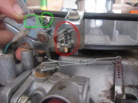

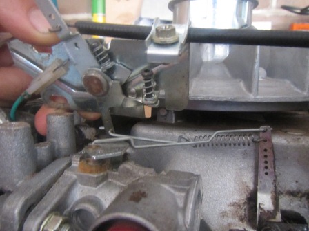

That is helpful - I had misinterpreted the picture I saw before. In the picture below, the spring inside the red oval is the governor spring. The lever in the green circle is the speed control lever. When you move the speed control on the handlebar from slow to fast, the speed control lever circled should move clockwise, and the governor spring in the red oval should stretch: It appears that the speed control cable is not correctly adjusted. If the black outer sleeve of the cable is slid to the right, by loosening the clamp screw in the top-center of the picture, the lever connected to the cable will move to the right, and the adjustment screw at the top of the green circle will come into contact with the speed control lever. If you then move the cable outer even further to the right, the cable lever will rotate the speed control lever clockwise, and stretch the governor spring further. This will increase the governed speed. It appears that because of the incorrect positioning of the cable outer, the maximum engine speed at present is being set by the other adjustment screw, slightly to the right of the green circle. This screw actually sets the minimum, or idle, speed of the engine. So, at present the engine only idles. When you correctly adjust the position of the cable outer, it should have the intended speed range.
Just looking at it, something seems off with where the govenor connects to the carb, I have an identical one I have to pull down tonight I will get a photo of the position to confirm it, but they do have several holes ontop of the carb that linkage can fit in.
Thanks Joe, finding out how it is supposed to work is way better than reinventing the wheel.
It would appear your throttle rods are in the right spot, just to clarify is your throttle cable in the photo tightened down there, that little arm it connects to has a good 20mm travel, it points toward the front wheel when stopped and more or less at the rear wheel when flat out.

Interesting Joe, i've come across a few of these carbs and many with different jets but never one like that. This might be a job for an exploded parts view. www.partstree.com is handy for parts lists, especially tecumseh's. Peter, at full load the hole in the throttle lever lines up with the notch in the top plate, (both circled green), in the below picture. The screw i've circled red is your idle speed adjustment. At idle adjust that screw clockwise to increase idle speed. As grumpy said, the screw that is also in the second green circle is your high speed adjustment. Adjust that one at full throttle to increase or decrease your full throttle speed. As always be careful not to have your full load speed more than about 3200rpm. It's a small torx bit but a really small screwdriver will do it if you dont have a torx set. Let us know how you go when it's done. ![[Linked Image]](https://www.outdoorking-forum.com.au/forum/uploads/usergals/2014/01/full-6430-14509-full_6412_14499_img_0432.jpg)
Posts: 445 Likes: 1
Righto: Grumpy, Your explanation about the throttle cable positioning was spot on after I had a better look. Last night I adjusted the cable accordingly and put the engine back together. I checked my work early this morning against Bigted�s explanation and the throttle lever lined up correctly with the notch on the top carby plate. The lever now moves in a clockwise direction as you indicated. Joe, My bowl nut/jet is very different to yours. I did however notice sometime very strange with the bowl bolt/ jet when I first unscrewed it from the carby. Inside the jet it had a rubber lining that protruded slightly out of the end of the jet. This was very brittle and when touched it perished. It was only a very minor piece which I thought might be something that sealed the jet against the emulsifier however I could be completely wrong. Perhaps your rubber O Ring was serving a similar principle. I would be interested to know if your bowl bolt/ jet has a similar rubber lining or if any others have an idea that would be great. Bigted, Thanks for the explanation. As stated above I went and doubled check this morning at the full throttle position lines up exactly with your diagram. So thanks for confirming. I haven�t played with the adjustment screws yet due to my problem below. My result. I went to start the engine and it starts for about a second then dies. The speed setting is definitely correct as it sounds much better however, I think the needle and seat might be the issue however I am not sure. I checked the seat and it appeared to be ok however I wasn�t able to get it out without damaging it. I understand there is a special Tecumseh tool and others say a crochet hook does the job. Is there a special trick for setting the needle and the seat to ensure they are positioned and operating correctly? Joe you mentioned checking it so I am curious. The configuration of how the needle and clip attach to the carby float to me seems prone to failure. Would someone have a photo of it set up correctly as I might have it wrong! I did some more reading about these carby�s last night. They don�t appear to be very popular with many people. Any suggestions would be appreciated or if you guys need more photos let me know. I hope this turns into a good thread as information on this type of engine is limited!
