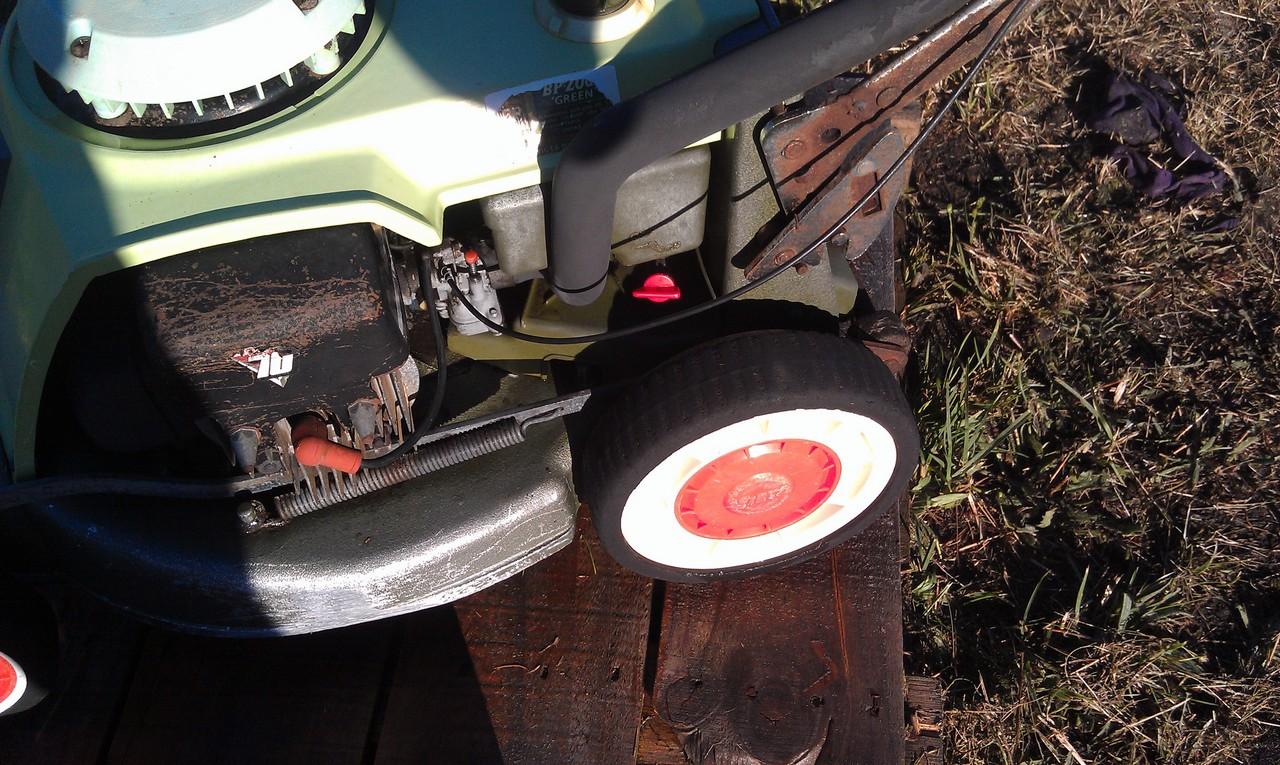

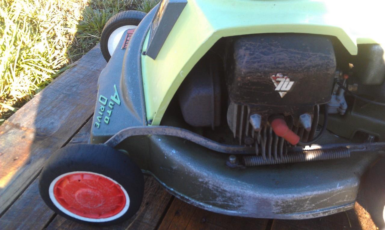

Received this today as part payment of a repair debt,
Now, I will try and get it up and running in the next few days (hasn't been run for5 years), but I am not much of a collector and will most likely try and recover the debt owed.

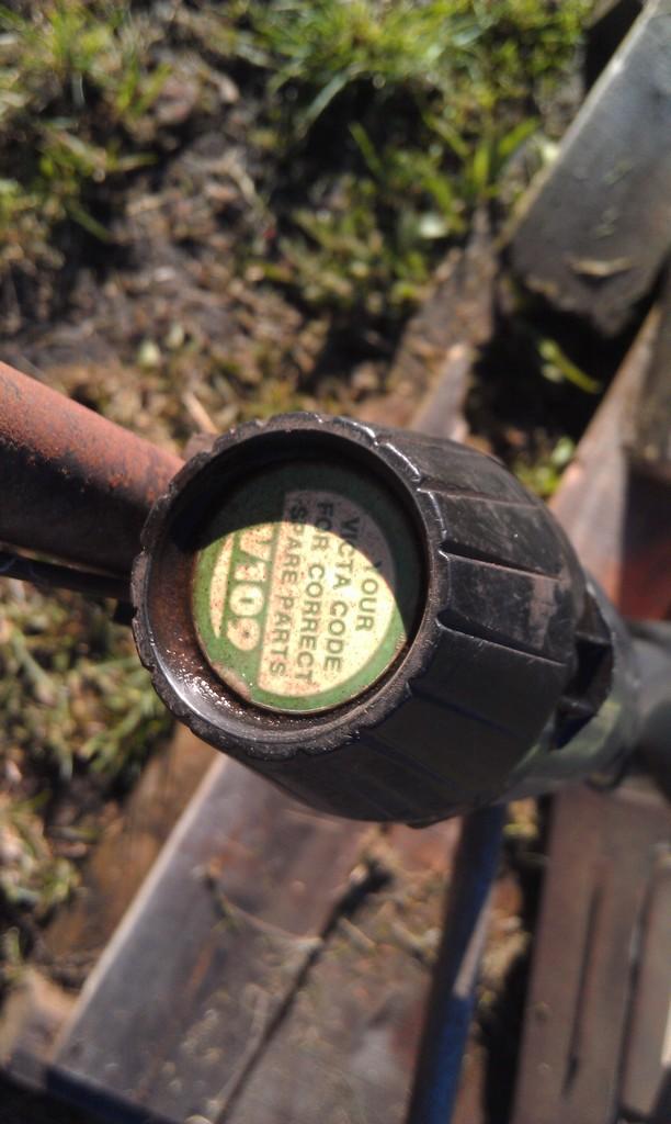

Who would like to ID the machine, and I will offer anyone here to get in touch with any E.O.I before it goes up for sale anywhere else. (If i decide to sell)
It is the one and the only VC-160 Auto Drive Mark I from 1972.
The very same as this one of mine. VC-160 Auto Drive mark I
Wow very very hard to find the original green catcher.Even I haven't found one yet.I have to settle for the black one at the moment.Although may never find another green catcher.

It looks really complete to me, quick clean up and flogg it maybe if it runs well.
However the drive and catcher alone could be worth more than the mower
What does the "repair" owe you?
Mick
I'm all for clean it up and restore it, it's a very hard machine to find, and personally, a favorite.
As Blumbly has said, this is the First Auto Drive, The 1972-1973 Victa VC-160 Auto Drive, V109. It marks a big shift for Victa with self propelled machines too.
Prior to the release of this model, the victa's self propelled models had retained the same principals since they begain, in which the rear wheels were driven by friction rollers resting on top of them on a low arch base.
With this machine the Self Propelled concept was able to be bestowed all the top end features of the premier model of the day, the VC-160, as it utilised the same sesign, and did so by driving the rear wheels internally, allowing the drive system to go through the base rather than over it.

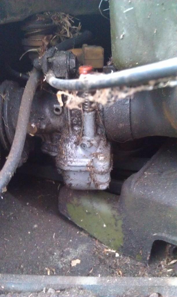

It indeed looks to be very complete, and a great candidate for restore, even having the original black throttle control, and an unbroken catch lever. and provided it is all there, getting the drive system working is often not too tricky. further, if the engine is beyond repair, a replacement can be sourced from any machine with a Series 70 MKII Engine.

IT GOES. Tank of fuel, 3rd pull, away and mowing.
Tries to over rev a little, but, goes and drives. Nice. Will try and post a vid soon.

Some pics after a quick clean:

Did you change the throttle control?
Joined: Feb 2013
Posts: 194
No, that's how i got it.
OH it looked like it had a black one on it in the first photo.
Well it won't be the original one then,but still the catcher is.
Joined: Feb 2013
Posts: 194
So it's meant to be all black, the throttle control? Gee, they would be thin on the ground.

I'm not positive white is non-original, as both were in use in 1972, and I have seen enough white ones to feel that it might have indeed varied depending on where it was built and sold, it's quite possible that it is original as is.
Green not black.They should have been green.Like the VC-125's as the original part number would suggest.I only said black as in the first photo it looked black.
Joined: Feb 2013
Posts: 194
OK, the throttle control is green. Very very very very faded and brittle, but it is green. You could NOT use is for a resto.
Anyways, I am going to sell this one. It will come up in the for sale section after I come back from a little holiday on the 28th or 29th Jan. I'll give any member on the forum a chance to buy (for what it owes) before it goes up for sale anywhere else. Ta
I thought It might have been. Being faded might explain why in one photo a dark green and another white. Might not be fixable but it does at least exist. Where you going for your holidays?

Throttle needs some adjusting. But wish I was closer I so want one lol

I love the way it runs, love the g 3 carb
