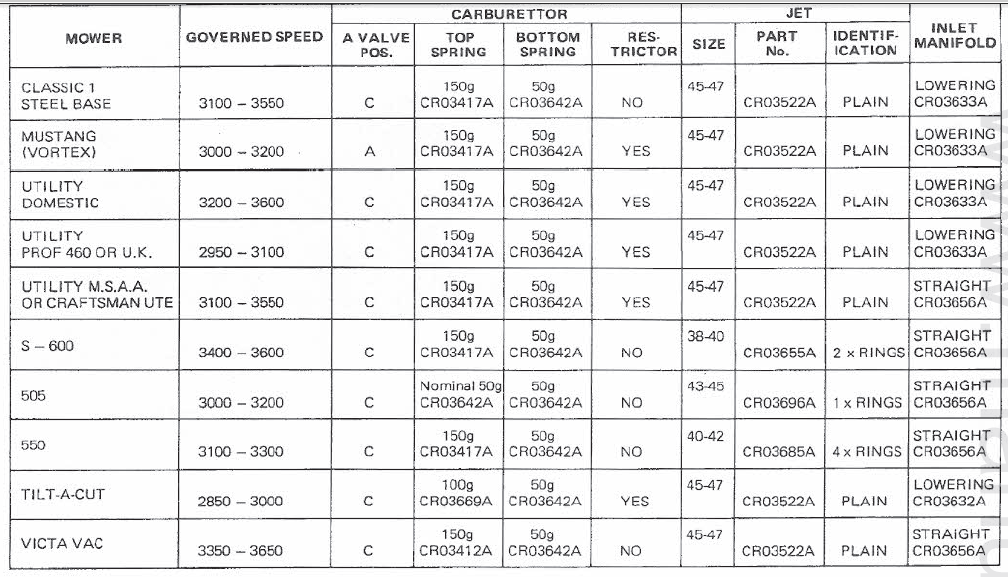

Hi All, the issue with jets has been bugging me for a while now so i did some digging and found what i believe will be useful to a lot of us. Pat you will see your machine requires the 4 ring jet.

Thanks Bigted, I found the same thing in a Gregorys manual from our small local library a few days back. For some reason it was in a different section!!
About the same time a 4 ring turned up on our Trade Me. So that's on its way along with a new wavy washer & carby O ring. I found my old carb body, the jet was a 2 ring. So I will shortly have the full set.
