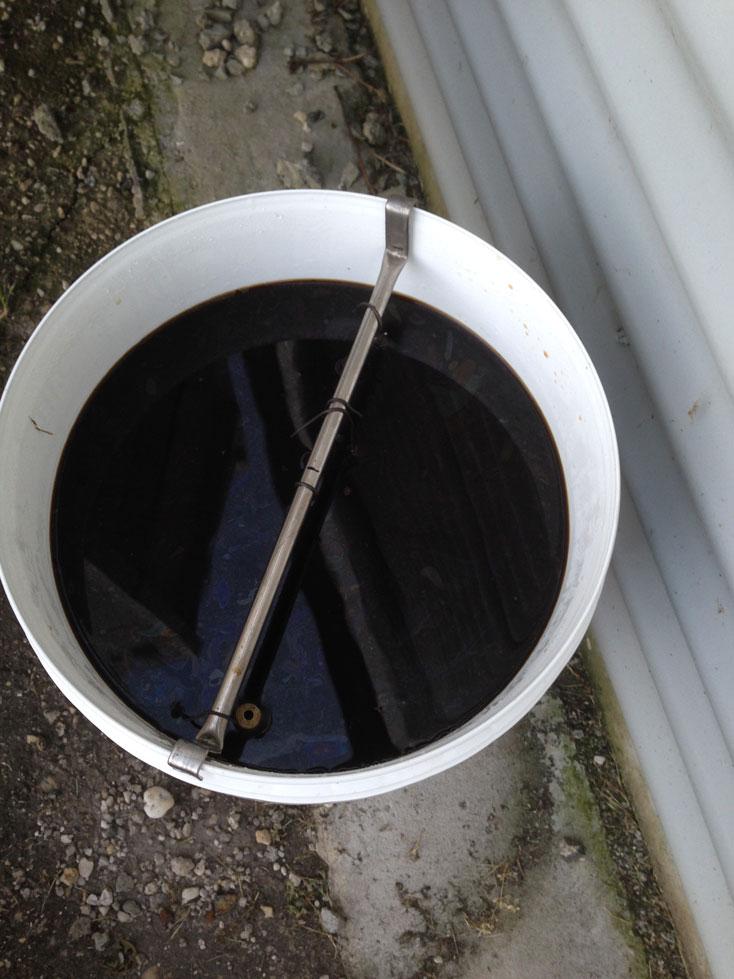

Well today guys I started my war on rusty parts, first up I went to Roberts and bought a 20L tub of Molasses $39 and cut the top off a Blue drum then screwed some white food grade rubber around the lid so it would seal and not blow off, run out the hose from the hot tap and 1/3rd filled it and sat the 20L tub of Molasses in it to get it a bit runny, then poured the tub in leaving about 1 1/2L in the small tub, then some hot water in there as well and mixed up both drums to get the Molasses mixed well, topped up both drums with cold mixing as I went, bent up a couple of bits of round to sit across the top to hang the parts on. One drum for the big stuff and one for the small stuff, now full of parts so sit back and wait for the magic cheers

well I got some of the parts out of my tubs the other day and they were better than I thought, as I did not clean any oil or paint off berore putting them in, I had herd the molasses does not work well for removing paint or oil etc but after a wire brush and a hose down 98% of the paint was gone and the areas were there was oil all cleaned up well, I had put the parts in on thw 2nd Jan so they were in there for a while, but thats fine I have not needed any of the parts before now, so if anyone is considering a molasses tub or two I can recomend it, I have also been useing the electrolysis tub flat out as well and that works great also but I think they both have their uses. hope this helps someone else.
