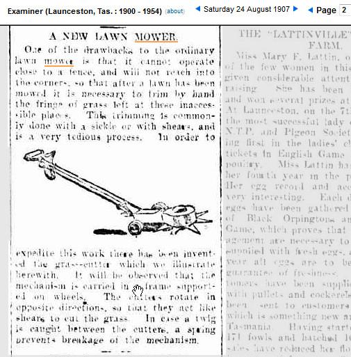

Oh, and for a little food for thought, a clipping from "The Morning Bulletin" a local newspaper in Rockhampton, this add is from an edition marked 07 July 1950. ![[Linked Image]](https://www.outdoorking-forum.com.au/forum/uploads/usergals/2013/11/full-5013-13331-rsc11.jpg)
Cheers Ty

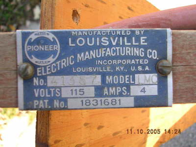

This is amazing stuff from the common myth of Victa "Inventing" the rotary mower (Not to discredit Merv's success in improving, marketing and producing it) we have now moved back 24 years.
This all helps create a valuable timeline, I was aware that electric rotary's appear to have come before petrol ones (perhaps the Beazly Patents 90 degree drive system shows a reluctance to leave the concept of horizontal crank shafts behind, and therefore complexities in design) but so far the time difference is looking a lot closer.
1928 we see the miller patent, which seems to me to be electric, then in 1929 we have the beazly patent, both in electric and petrol.
To give a timeline based on evidence so far we can see
1928: The Idea of an Electric Rotary Mower is recorded. 1929: The Idea of a Petrol Rotary Mower is Recorded. 1946: Evidence of a Petrol Powered, Vertical Shaft Rotary Mower, With Catcher. 1948: Evidence of a Petrol Powered Rotary Mower being Created in Australia 1952: The Creation of the peach Tin, A Light, Easy to manoeuvre Vertical Shaft Rotary Mower Created in Australia
We have all we need easily accessible to discern Victa's first Mower, Catcher, Self-Drive, Rear Catcher, Governed Carby etc.
But this is the kind of information that helps peice together the same timeline world wide.
I am curios as to when certain improvements came about, there seems to be quite a gap between the patents of the late 20's, and the self propelled, rear catcher, vertical shaft petrol engined Rotoscythe in the 40's.
Honestly it is seeming to me that a lot of moves Victa made where not new idea's, just implementations of existing concepts in much more successful ways.

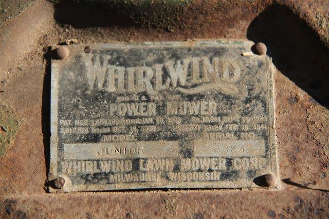

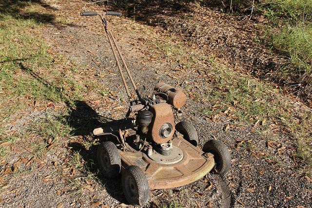

The "Whirlwind" Company went on the become the Toro of today.. In fact, The old Toro's sill said "TORO-WHIRLWIND" Kori

Hi Kori, that's right in a sense mate, TORO took over Whirlwind in 1948. Here is some of the history. The Bull Tractor Company of Minneapolis, MN, sells more farm tractors than any other brand but has trouble finding a reliable source of engines. The Toro Motor Company is founded on July 10, 1914 to build tractor engines for The Bull Tractor Company. Although established as an independent company, the name �Toro� is chosen due to the company�s association with Bull Tractor. Toro co-founder, John Samuel Clapper, becomes the company�s first president. Clapper goes on to serve as president for 29 years (1914-1943), leading the company through challenging times including a devastating farm depression in the early 1920�s, the Great Depression, and both World Wars. Clapper is active in all phases of the business and earns 16 patents. Under his stewardship, Toro becomes a world leader in the golf and industrial turf management business and begins to tap into the fledging homeowner market. 1945An investment group led by three young World War II veterans and former Dartmouth classmates � David Lilly, Bob Gibson and Whit Miller � purchase Toro. Long-time Toro vice-president and sales manager Kenneth Goit is named president of the company. 1948In a move David Lilly would later describe as �one of the best business decisions we ever made,� Toro acquires Whirlwind of Milwaukee, WI, a manufacturer of rotary lawn mowers. Toro engineers design a safer, enclosed rotary mower deck that boosts consumer acceptance and and purchases of the new rotaries.

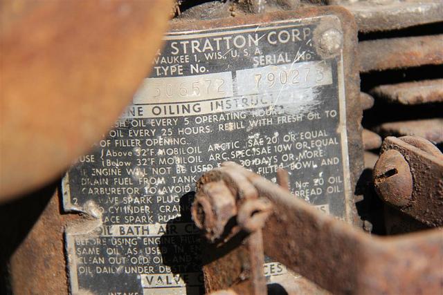

I'll add some more data to this not-very-structured history. We know that the Rotoscythe may have pioneered the rotary mower both globally, and specifically in the UK. We know that in 1950, Briggs and Stratton began making a vertical crankshaft engine specifically for rotary mowers. I have found some material intended to expand on the development of rotary mowers in the US, prior to (and perhaps leading to) that Briggs product introduction. It is a very long and detailed history of Goodall, a pioneering firm in the field of vertical crankshaft rotary mowers in the US. The history was produced by the State Historical Society of Missouri: http://www.gasenginemagazine.com/fa...tor-leonard-b-goodall.aspx#axzz2mdj9PZjuThe article shows a very early production version of Goodall's mower, probably much the same as one featured but not photographed in a newspaper article from 1939. This apparently used a Maytag washing machine engine: ![[Linked Image]](https://www.outdoorking-forum.com.au/forum/uploads/usergals/2013/12/full-2772-13490-goodall_first_model_1939.png) It also includes a reproduction of a March, 1947 advertisement for Goodall's product: ![[Linked Image]](https://www.outdoorking-forum.com.au/forum/uploads/usergals/2013/12/full-2772-13489-goodall_mower_advertisement_1947.png) Just after the war Goodall negotiated with both Briggs and Lauson to have them make vertical crankshaft engines for him. The outcome was a 5 year agreement for Lauson to make vertical crankshaft engines exclusively for Goodall. I think that is probably the engine on the mower in the 1947 advertisement. Meanwhile I note that the Clinton engine company claimed to have produced the "first mass produced vertical-shaft engines for rotary lawnmowers", though it doesn't say in what year this happened: http://www.clintonengines.us/Clinton_Open_House.pdf
