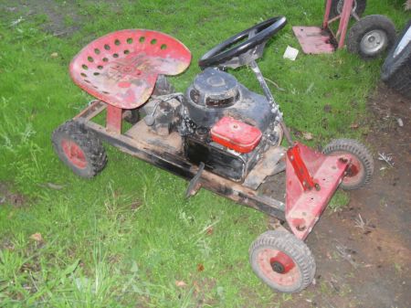

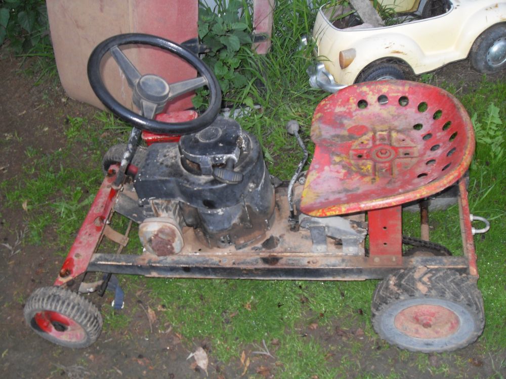

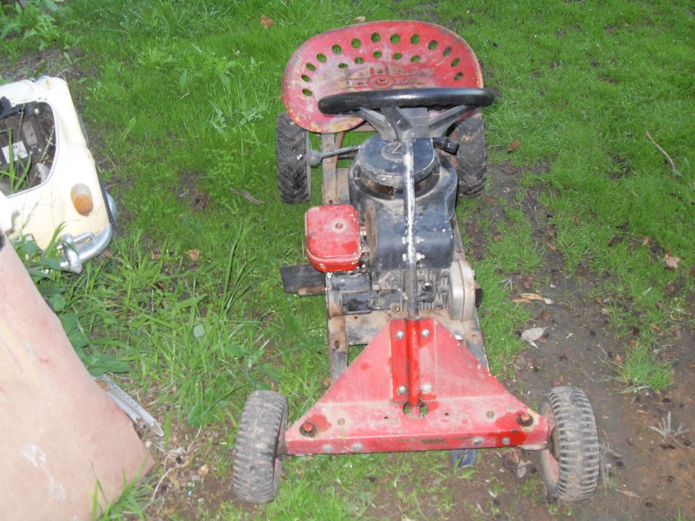

Very early ride-on,mower deck removed so kids can use as a buggy
11 Comments
mower man #18008 13/07/10 02:20 PM
Joined: Apr 2009
Posts: 288
thats defiantly a cox mobile mow but they had the friction drive system not a single speed forward and reverse gear box. the gear box is out of either a victa/mtd 5-26 06 a rover colt. have you known it to be modified?
looks good tho! maybe some footrests to save kiddys feet?
regards jay
mowernut #18054 16/07/10 12:10 PM
Joined: Jul 2010
Posts: 264
Hi jay,it has a friction drive,when you push the pedal down it tightens the drive belt and the mower deck had a sort of centrifical clutch set up which i still have.i will take more pics of the gear box but it looks rigi didge if not a very good job.what year would it be?...ken
mower man #18217 26/07/10 02:55 PM
Joined: Apr 2009
Posts: 288
Sorry for the late reply, your reply slipped past me.
The easiest way to identify the year of the engine is to read the first 2 digits of the 'code' printed on the cowling. For example if the code were 890130 then the engine would have been made on the 30th of February 1989.
as to the drive system Cox never produced a mower with that type of drive set up. The mobile mow had 2 large discs mounted on a horizontal shaft and a cone mounted on a vertical shaft in between the two discs. When the cone was pressed up against one of the discs it would spin it to move the mower forward. When the cone moved over it would contact the other disc and therefore propel the mower backwards. i made a video explaining it on YouTube. I will find the link for you later.
so basically what im suggesting is that either this mower has been modified or it isn�t a Cox, rather a rip off which seems more plausible because it looks nothing like any Cox ive ever seen(ignore the bit in the last post where i say it is).
Regards jay
mowernut #18222 27/07/10 01:31 AM
30th of February Jay? That doesn't come around very often. There are eight digits in the code. The first two digits are the year, the second two are the month, the third two are the day of the month, as you said, and the last two digits are the manufacturing plant. A code of 890130xx would be 30 January 1989.
grumpy #18229 27/07/10 10:34 AM
Joined: Apr 2009
Posts: 288
hahaha after i posted it occurred to me that February is one of the ones with 28 days but hoped no one picked up on it.
i was unsure of how many digits it had off head and wasn't going all the way outside to check.
mowernut #18233 27/07/10 11:42 AM
Joined: Jul 2010
Posts: 264
Thanks guys,the code number definition is most help full,as for the ride on,i will post more pics for interest sake but still good for the kids...ken

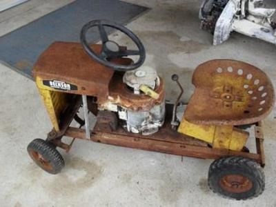

Hi that mower is a mowette deckson garden tractor I have one
mower man #49418 21/09/13 07:10 AM
Joined: Jun 2013
Posts: 78
Likes: 3
Have you got any pictures of you rig myoldmower?
mower man #49428 22/09/13 05:55 AM
Joined: Sep 2013
Posts: 13
Here is my old beast
mower man #49455 23/09/13 06:15 AM
Joined: Jun 2013
Posts: 78
Likes: 3
That's awesome I want one,
Did they come with a deck or are they just a tractor?
Agromick82 #49457 23/09/13 09:42 AM
Joined: Sep 2013
Posts: 13
Yes they came with a cutting deck
this one is for sale have done some resto work on this one is now red and silver try and get a pic
uploaded.
