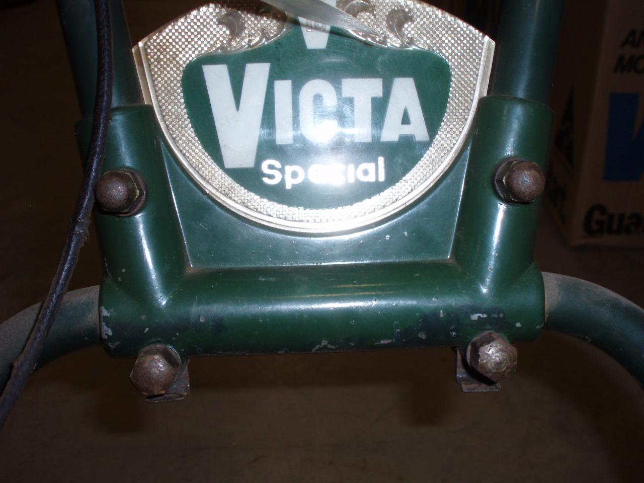

So something that had been on my mind and has been touched on by you guys, is if the Special was badged upon release, and if so, how? My initial feeling also was that it wasn't badged, so I did a little digging:
This is the earliest Special pamphlet, followed by a detail of the mower - not sure if any of you have ever seen this one:
So what does this tell us?
*In the initial phase of the Special's marketing, they had already moved to "2 mighty mowers" not three.
*The Special badge as we know it had still not been designed, as evidenced by the detail in the pamphlet. It appears they had the idea but had not yet applied it. Confirmation that the Special was released un-badged?

Agreed Unkie...The Badge is of the "Auto Style". This transition phase could well have had a few indcisions...They would not have planned the Automatic to be a flop...It could have gone on for 100,000 more models if it was a success. So it would have been all hands on deck when they decided to pull the Auto....They may not have been 100% ready to release the Model 5S1 Special as they had planned.
These remaining model 4 mowers would have to suffice for sales of some kind,else the company would fair badly with nothing to offer....Id say the Special" NAME only was brought forward to thesse models,But NO badge was ready to be used on these mowers,because they were still being prepared/made/in production for the Original Model 5 S1 Special Release.
So A case of lets use the name on our Model 4 non autos until the badges are ready to be fitted...Seems very convincing.
Your right Deejay..We have found many discrepencies in Artwork/ads thus far. I think it also proves that they werent fully ready with thier Special release. So they just relied on revamped Artwork from previous models to get a near enough.
This paticular Advert is the Most innacurate,which to me proves its also the Earliest! (And you will probaly find as time goes on,this Ad and this Exact mowers Stance were used in a prior Ad for the model 4 Auto or model 3 STD). I think this all but Solved unkie....Very Nice ads once again!.

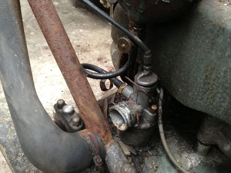

Well picked up #5 today, (thanks for the lead Unkie as I missed it) bloody gum tree had it in Hobart region but was only 5 min from home, not a lot good on it, but for what I paid will be worth it, very strange engine # that has got me, but what do I know. Just check out the custom axels lol
Tassie must be where all the Auto/4s go to die! ....The axles are cool,But im liking the custom rear Exhaust better...Ive No Idea on the Number,never seen a U prefix...Definately Period Number stamping though. A misprint would make it maybee 161,127 to high for Auto. Special order possibly?.
Who knows,but something different! Im always looking out for unusuals,Gives more to research.

Nice score mate - glad to have been of help. I'd reckon Blue is on the money with the misprint, and would agree it reads 161,127, which I find bloody interesting. To be honest, it's this number range that we know the least about (128,000 --> 185,000). Finding more of these transitional numbers will really help to build a watertight chronology, ie - finding out how the Model 3 and 4 overlapped, and at what point the badged Special kicked off. What kind of carby has it got, Jonesy?
Posts: 539
I see the 118,000 that started this topic is still on gumtree?
Just looks like later single cable carby, silde is stuck so will have to free that up,and later model fuel tap, pity the two side flap bolts are so rusty and the air cleaner broken, oh well you get what you pay for lol I will get another clear shot of the engine # as there is a bit about the "U" that is a bit Suss. And yes Blue racing exhaust lol

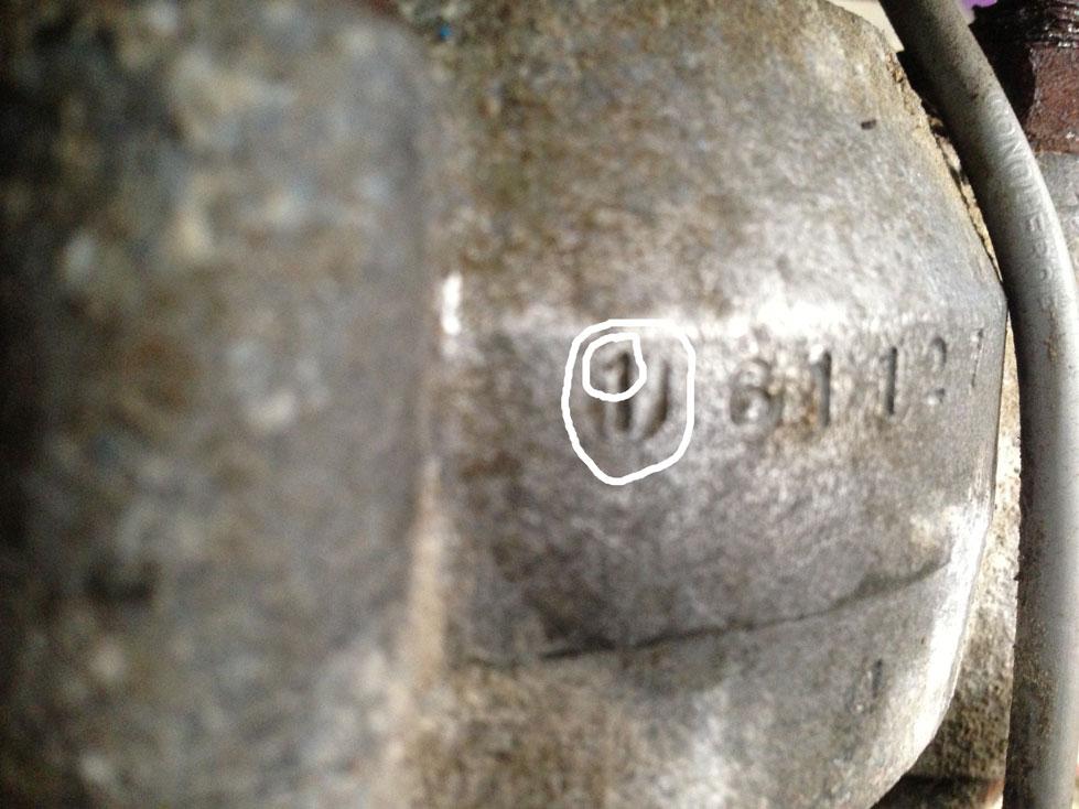

Nice hunting once again Unkie, I can confirm that the "U" in the engine # of my last pickup as being not so much a misprint but just poorly executed, I would say the right hand side of the U is just an imprint from the side of the stamp head as you can see in the pic the left hand side is definatly a 1, so engine #161,127, you can see the 6 has the same thing but just not as pronounce.
Posts: 104
Small Engine Technician
Nice one Jonesy. Now you have too many model 4's....give me one... smile
I was speaking to someone today that sayed he had an engine with the letter 'T' in front of the numbers. Could also be a poorly executed engine number as well. I'd have to see it though...
