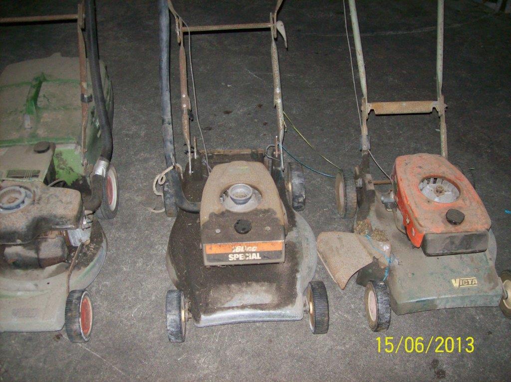

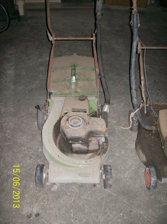

Yep went out yet again.This time the area is huge,by far one of the largest areas I have seen involved in one week.Founds lots of goodies other then mowers,some working computers etc.These are the mowers that were found today.
First a VC-Mustang 1974-78 V206 Mark II G4 with No primer.After looking at my other VC-Mustangs this was the model I didn't have.Now just have to find a dress cowl for it.

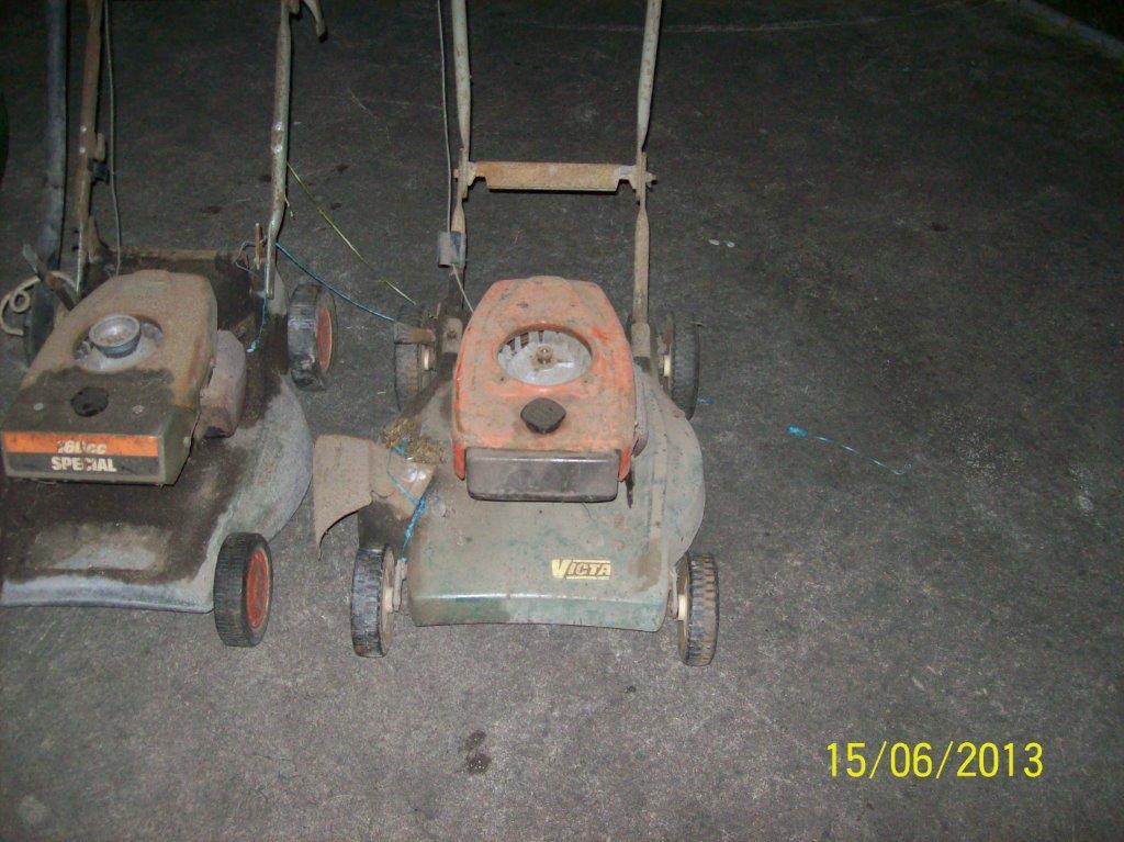

This one I think is a bitza it has a 1972 made engine on it.So it's like the 1971-72 Special,but it's on a Corvette 2 base.All these mowers came from the same spot.So I'm thinking it has the cowl off the next mower as it is a 160cc Special.

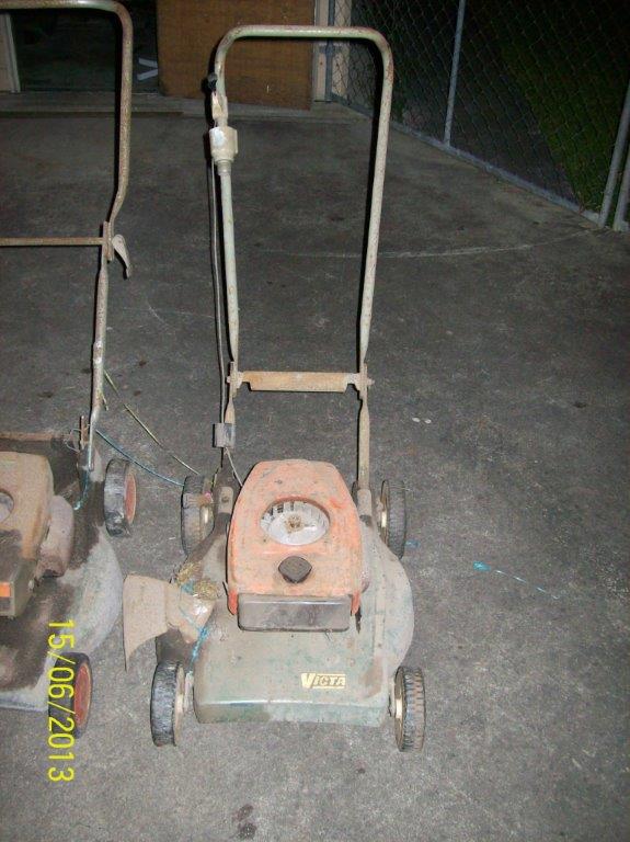

This one is the 1969-70 Special.Model 69VF-1-2-3 Victacode V59
This the VC-Mustangs engine cowl.
So all in all it was a good day.Hopefully it will be just as good tomorrow.I hope so as it will be my last for a while as the others just become to far away.

Nice score Blumby, i like the VC, it should come up well

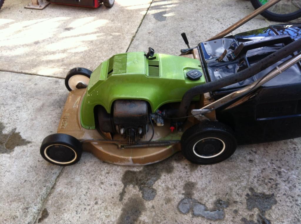

I've uploade a few pic of a VC i got from my scrappy for $10.Put fresh fuel in and it started second pull. Runs like a gem, it wouldnt turn off so i cleaned the cutoff swith contacts and no problem now. As you can see someone took to it with the gold paint some years back so i painted the cowl black to match the catcher, which is the wrong one for this machine but looks complete now.
I remember you saying in an earlier post that the red mustangs had the remote fuel tap. Was this exclusive to the red ones or were they also fitted to the green ones adhoc as well, because this one has the remote tap also (2nd pic).
Well I do believe the remote tap was fitted to the first of the VC-Mustangs,of which you have there(which was the Red and Green models).That one is the 1973-74 VC-Mustang Mark 1G Victacode V135.Engine number should start with either 11073 or 11074.Could I get you to take some close up pictures of the remote fuel tap so I can see how it is?.As my one is missing the tap.I have the bracket on the base the fitting on the tank but no tap.Thanks.

is the engine on the corvette a 160 ?
because they did have a cortina model with the same base and a 125cc
Yes it is a 160 but I'm not even sure it is correct engine for that base.It really is a bitza.I'm just going to part it out.The base is completely destroyed.

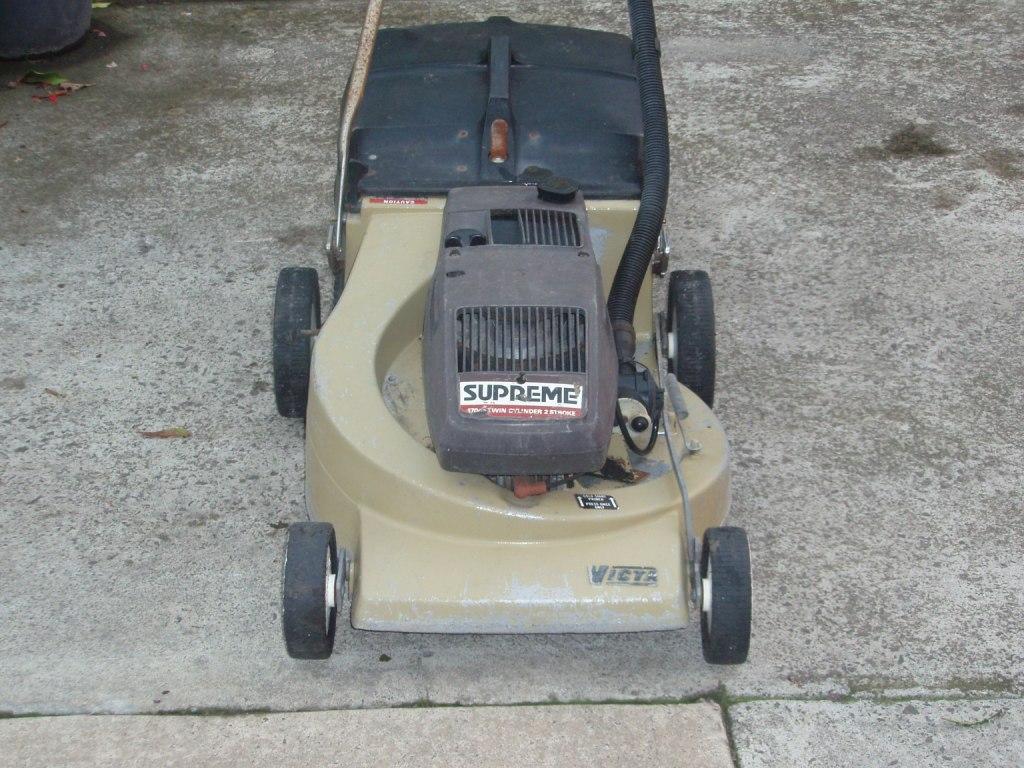

I'll take some close ups of the fuel tap tomorrow and post them in the evening Blumby. Ahh the elusive gold twin(Supreme), i sold it about 18 months ago, my dad had it since new and was still running when i got rid of it, a little worse for wear. Still it sold for $250 on ebay...
Some photos for everyones viewing pleasure:[Linked Image]
As you can see, cracked cowl with fins missing, catcher has a repair, but still a damn good starting point for a resto.
OH don't upset me. Why didn't you sign up earlier you would have seen I wanted one. No I don't want to know la la la la. just pretending you didn't post that up there. I've been looking for one for over two years that I can remember. Maybe even longer.

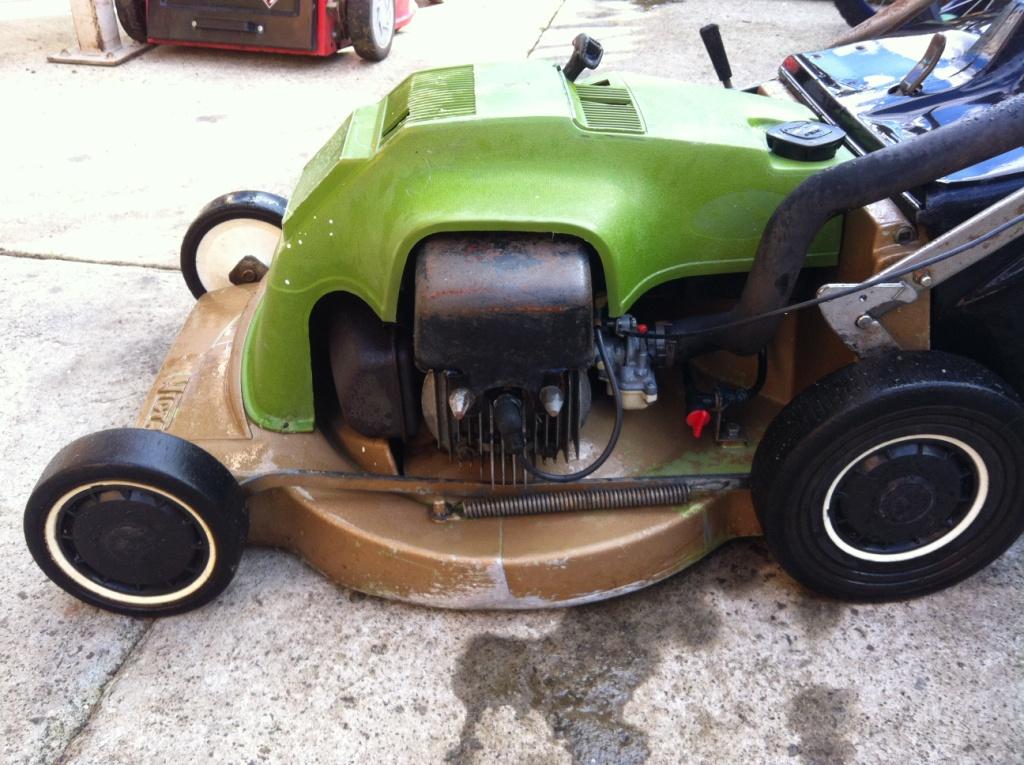

Anyway, i took a couple of photos of the remote fuel tap setup on the VC mustang.
From what i can tell its a standard fuel tap with the brass filter removed[Linked Image]
As for the engine no. you were spot on, 11073 294 although the vivta code is V111, but the airbox may have been changed somewhere along the way.
Awesome bigted thanks heaps yes it is just a normal regular fuel tap.That's great as now I know how to get my red VC-mustang running with it.Now if I can find another brass fitting to put my green one back with it.Your victacode V111 is actually a VC-160 Mark III code.
After having another look at your carby (bigted) on the your VC-Mustang. I'd say that somebody has changed it as I don't remember that those were around in 1973. It should have a aluminium bowl not the plastic one. The plastic bowls didn't come out until 1974-75. If memory serves me correct. Not that it will bother you but I thought I'd just mention that. However I could be wrong,but I don't think I am.
