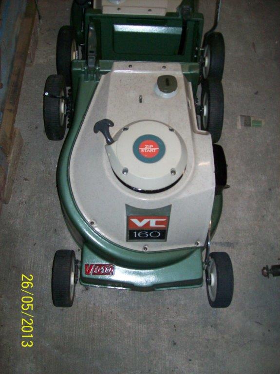

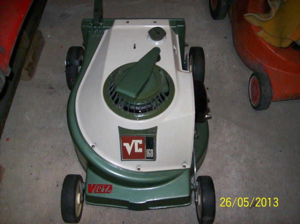

Just some updated pictures of how the look at the moment.Still looking at this chroming idea.I'm liking one of the spray on types as it is strong can bend and twist and take small hits.It just depends of cost.Which I still haven't found yet.Any way here they are right now.
Mark I
Mark II
Mark III

I really like the detail you put into making the mowers original. For example painting the fuel tap, it looks stunning. And painting the victa logos red makes a huge difference.
Could you post a picture of underneath please? Just to satisfy my curiosity.
Thanks.
Yes your right James I haven't taken photos underneath them.Yes I will,not tonight though but I will.

wow just awesome Blumbly. love the detail. i have a mark 3 and hope 1 day it looks as good as yours does now.
cheers bazz
Thanks bazz. There is a lot of work involved but its well worth it. I'm sure you will get yours to look the same. It just takes time. I still have a bit to do,but for now I'm going to get the VC-125s to the same stage then complete them all.
Wow!! Better than a bought one!. Great work there, Jeffrey,they look fantastic. Well done mate. good1
Thanks Darryl yes they did come out great. As I said a lot of work but also a lot of fun. I did enjoy doing them.

I decided that I should do these restores properly so I took the cutting discs off and painted them the right colour.
So here they are.
Mark I.
Mark II.
Mark III.
Don't they just look so pretty,I bet the grass isn't thinking it looks good.Not that the grass will ever see it,but the grass doesn't know that.
