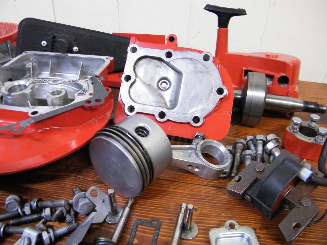

Hi all, here is my old Rover mower Im working on.... I got it from the tip for about 10 bucks.... Looking at it I was thinking it's in great shape so bugger it I will do it up...I like to tinker and each engine I work on I get better..Anyway here are some pics of the Briggs engine made on 5 August 1987 (I only know age thank's to grumpy) it's in great shape and not done much work for age it still has honing marks in the bore ,and still stock with a 65mm bore... [Linked Image]

Thanks, it's getting there has been a steep learning curve as Ive not pulled one down before, looking up as much as I can on Briggs..Only stuff up so far was working out cc,I had already pulled it down before getting bore and stroke as there seem's to be two of this kind of engine from Briggs both have 65mm bore but one is 148cc with a stroke of 44.4mm, and one is 158cc with a stroke of 47.5mm ,they seem to have got 158cc with a stroker crankshaft of sorts...but alas this one is the plain jane 148cc engine by the looks of it not that it matter's as its in great shape.....

Chris125,
Nice looking engine but what I could not see is the metal oil slasher that should be on the bottom of the conrod. cheers2
chris125 #45802 12/05/13 03:34 AM
Bruce, its a vertical shaft motor, the plastic oil slinger is there in the bottom of the first pic wink

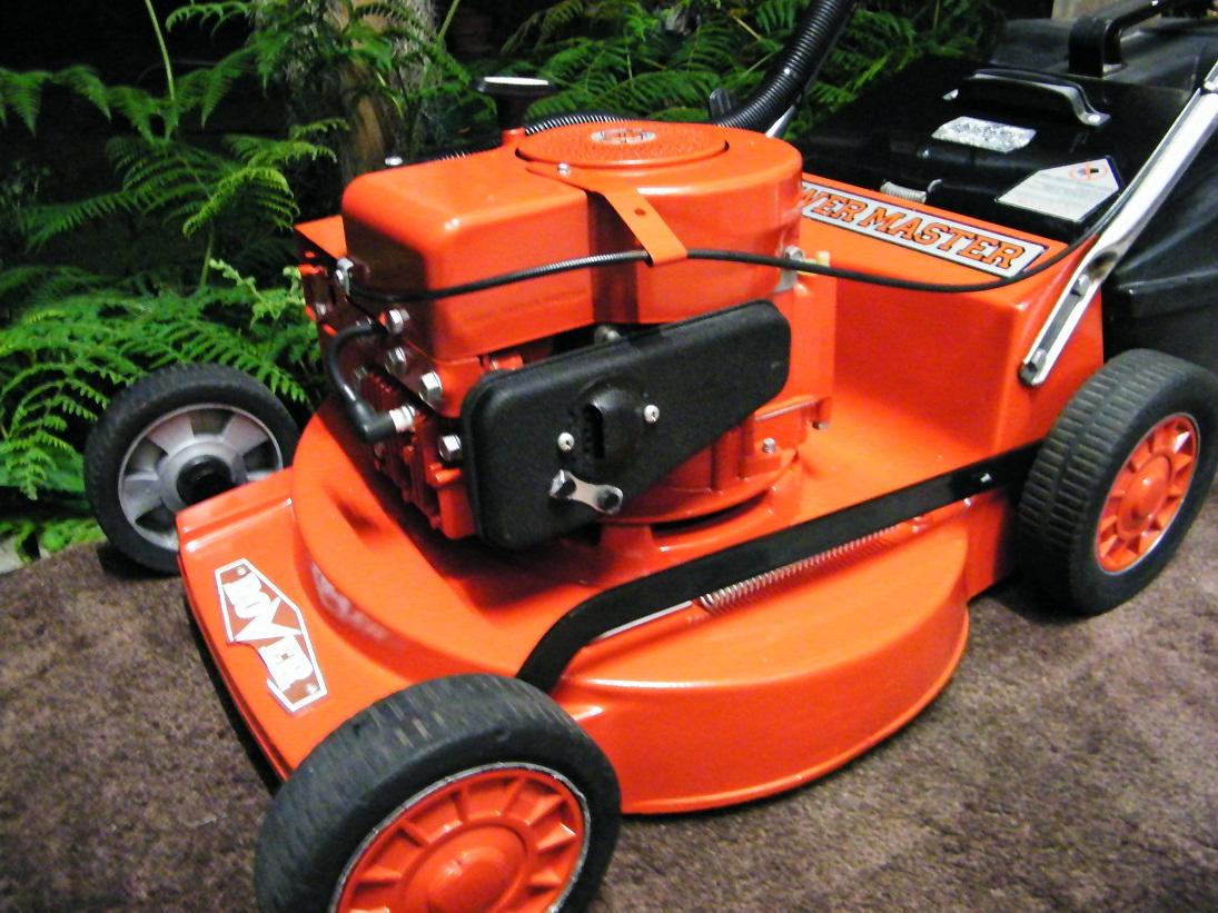

Hi guy's engine is done, they are a nice little engine to work on here are a few pics....[Linked Image]
chris125 #45827 13/05/13 04:01 PM
Joined: Sep 2012
Posts: 418
Hi guys,It came up looking good just have to give it a run..few pics Cheers....[Linked Image]

Looks great. it would be worth replacing the rover badge though as it really drags it down smile
#45830 13/05/13 05:00 PM
Joined: Sep 2012
Posts: 418
Thank's ,yeah I will keep my eye out for a better rover badge..
